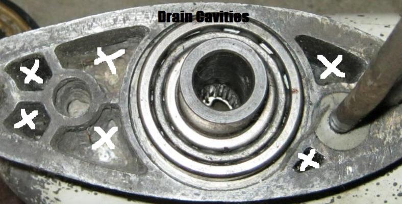

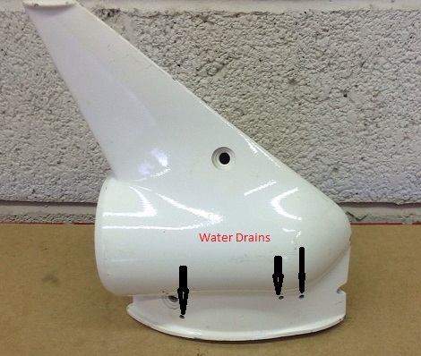

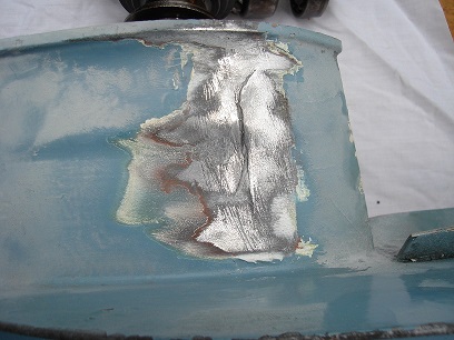

    This may be an overlooked item on your winterizing list that needs attention. All six drain holes in your lower unit gearcase need to be checked to see if they are clean and clear. The cavities in the center picture are where the six holes drain from. The last picture is what happens if the holes are not able to drain and freezing occurs. Don't forget to check your lower unit oil for water and drain it if present as it too will freeze.
