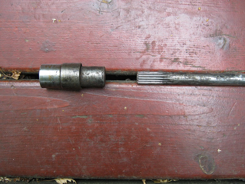

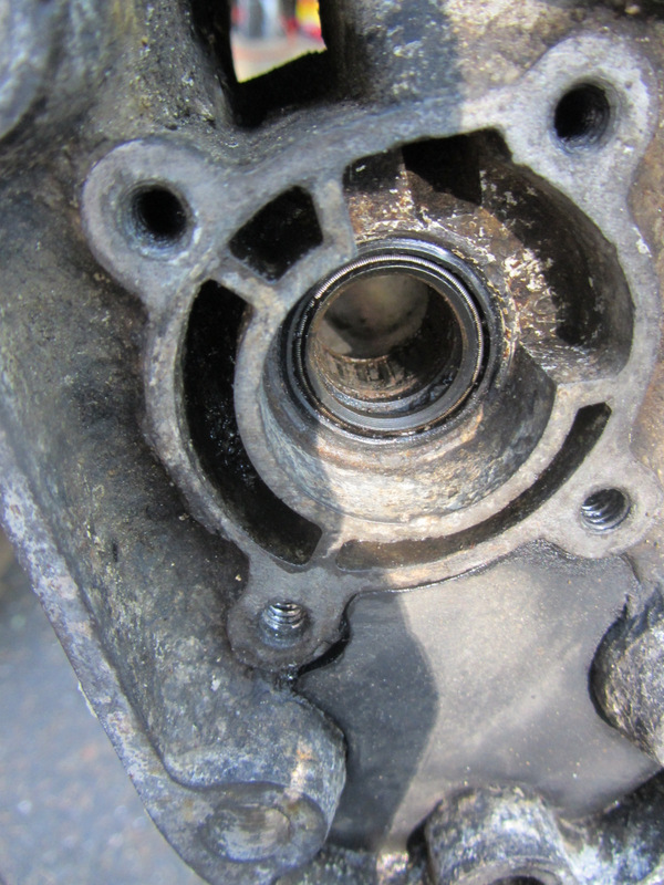

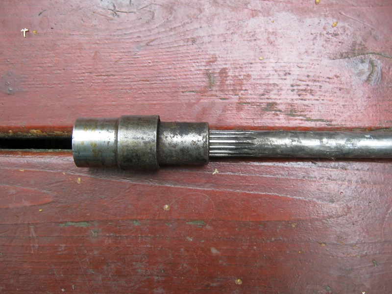

                    Just couldn't wait so I took it apart, after punching shaft out the bottom I can see needle bearing are pretty clunked up that is the problem. To remove needle bearings, I punched out sleeve with brass punch, now do I remove seal from tapping from top it looks like the exploded view has it going out bottom. As far as history it came from somewhere close to Prineville a little farther South He bought a boat the motor came with it he didn't want to mess with it hasn't seen any Salt.http://www.classicboatclub.com/image...attach/jpg.gif
