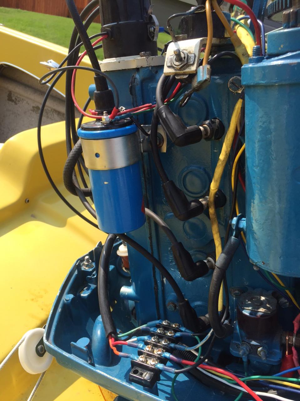

                Cap: Standard Motor Products AL137 $24.08 on Amazon
                Cap Lid: Standard Motor Products AL136 $9.50 on Amazon
                Rotor: AL102 $11.57 on Amazon
                Coil: Bosh Blue 00012 (run without resistor wire) $44 on Amazon
                Wires: Solid Core Universal Products R1814 (kit for 6 cylinder tractor- $20 on Amazon)
                I wouldn't know about points, mine came with a Petronix ignitor.
                Dave
                I purchased the above in the last 3 weeks, so I know the numbers are good, and everything was in stock.
                  Picture of the upper and lower cap, coil, and wires on the Homelite.

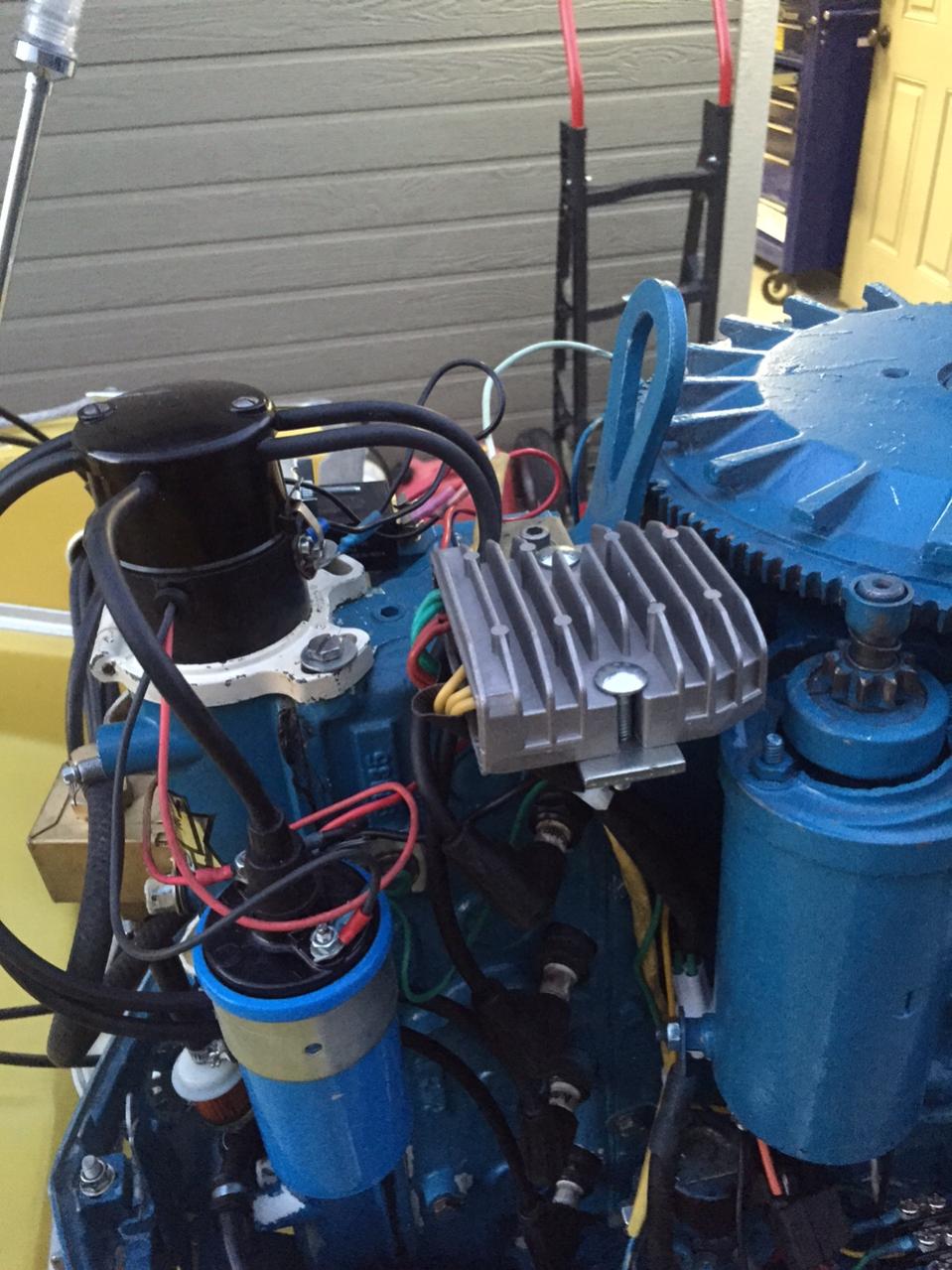

                    Thanks Dave, Dave what does that toggle switch do I have that on my engine but haven't traced out wires. Regards, Paul
                      The toggle switch is to manually regulate the alternator output. Low output is about 5 amps. In the high position the black wire is tied into the gray wire to provide max output. About 14-15 amps. I don't run a lot of electronics so I keep it in the low position most of the time.
                      YMMV.
                      Best, Steve
                      WizardIII
                        These motors do not have a voltage regulator. They saved $10, and put in a manual switch instead. There are three output wires from the stator sending AC current. Two of them run directly to the rectifier, and the third one runs through that switch. It was assumed that the output from 2/3 of the available amperage would be enough to trickle charge the battery after starting, but not so much that it would over cook the battery either. Points and lights don't care if they get 10 volts or 18 volts, they all work the same. But if you were running a bunch of lights, or trolling, you could flip the switch to high and get full output. But if you left it on high and weren't using power, the excess would just boil off the battery.
                        I came up with an inexpensive upgrade that replaces the switch, and the rectifier, and adds a regulator. It is a mosfet rectifier/regulator designed for a Suzuki motorcycle.
                          Thanks guys! now I know, nice add on rectifier setup when I'M at that point I'll make something similar right now as I pick my motor up about a month ago I'm just dabbling with it. My guess was it was a security switch. Paul
