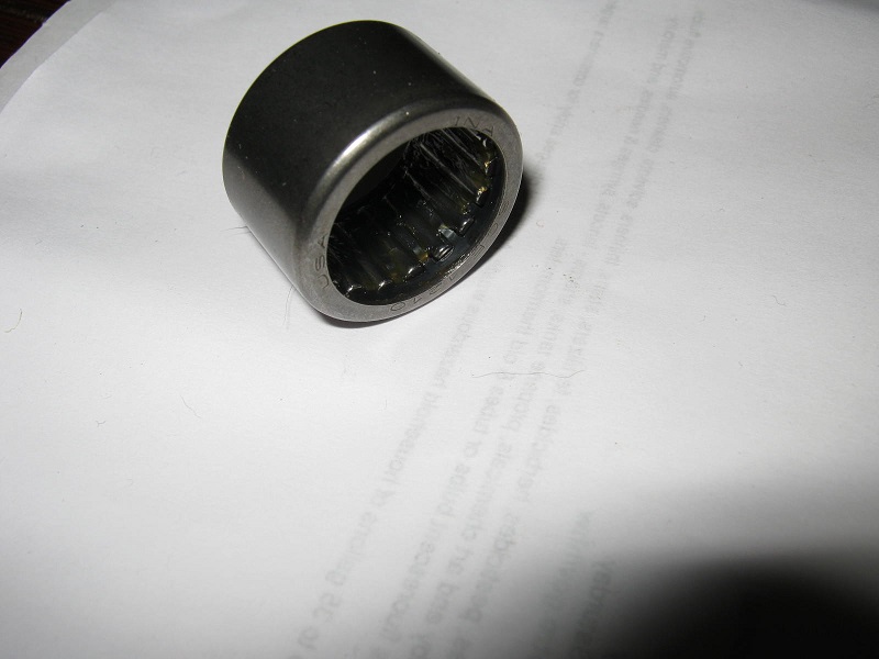

              Paul, # on the bearing? SCE1210

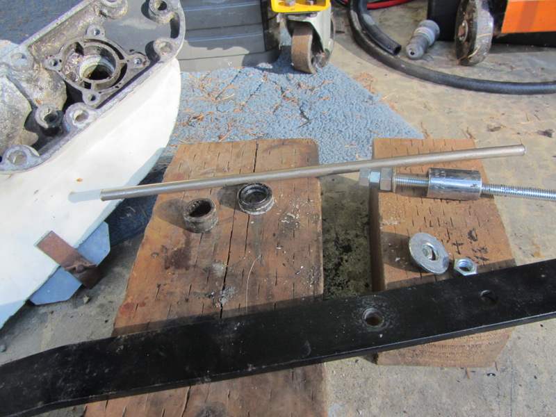

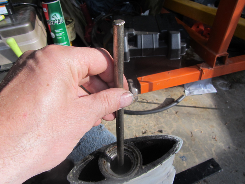

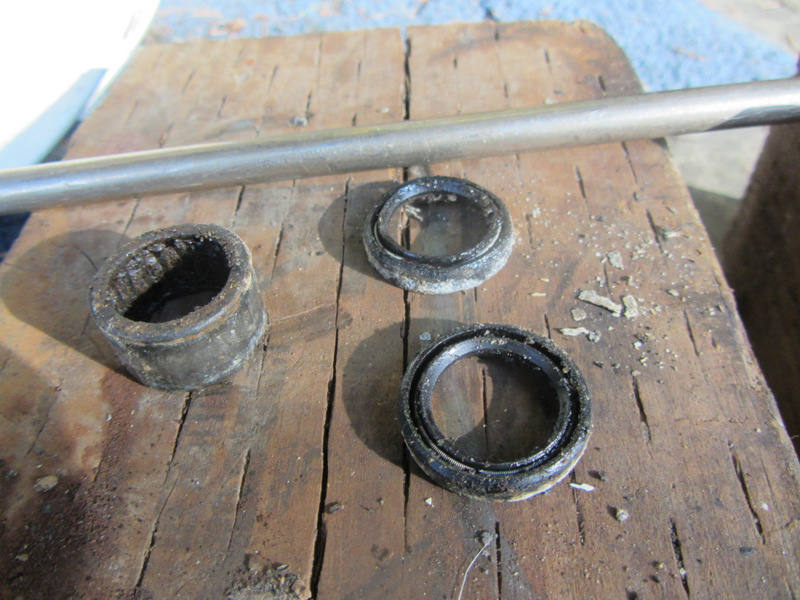

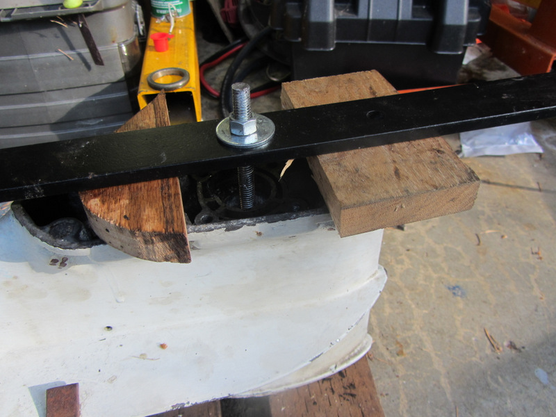

                      Well as a matter of fact I did! : ) just before I went on vacation : )) I took a couple pictures and was going to post to help someone maybe in the same spot. Lets see what we can do that makes sense ; ) .
                        It took a little more soaking and pounding but she finally barked it it up.

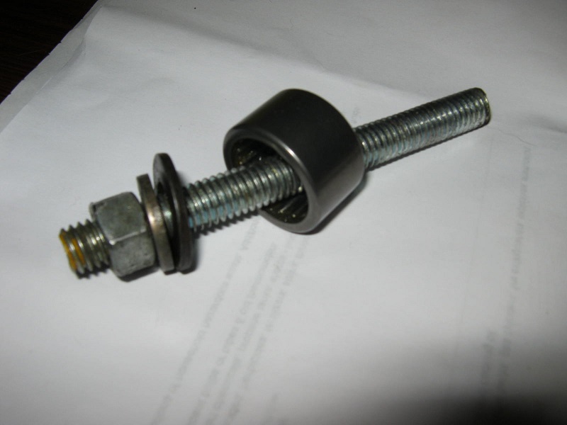

                          To all, so this is how I/you do it, get a piece of 3/8" all thread, buy 3 s.s. 3/8" nuts now thread two nuts on one end string a 1/2"drive socket with a 15/16" O.D. (outside diameter) this is about right the bearing is 1" O.D. your going to use socket utilizing the threads to push the bearing and seal upward make sense you'll see in a minute. the picture shows the setup by tighten the nut you pull the bearing and seal at the same time previously I've been soaking the bearing with Kroil available at Tacoma Screw Liquid Wrench works almost as good Acetone and automatic transmission fluid works better than both. I used some Oak to protect surface and the black bar is a 3/8" plate steel with 3/8" holes drilled through it put all this together as picture shows tighten to about real tight to fairly tight 40 ft lbs. smack the bottom end of the thread with brass punch. a nut threaded even to end as not to damage threads this is what worked for me. This method was given to me by "Super Sportster" I am only sharing the love any problems will be cheerfully addressed. I'm working on finding bearing and seal source and will post when obtained. my unit had two stacked seals literature that I have show only one perhaps someone can shed light on this? Regards, Paul
                            Paul, Early units used one seal, later units used two seals. They must have been having a problem and the fix was two seals. When installed the seal spring side is toward the impeller side. Pressure from the pump is greater than gearbox side and keeps those seals watertight. If the seal area on the driveshaft is grooved it is removable, I've just flipped them over and reinstalled with red loctite or you can have new one made.

                              That explains why my needle bearings were so rusted up they had the seals in backwards and that's the way I would have installed the new ones as soon as I find a replacement I found several sources on internet for bearing just general search using SCE 1210 bearing number came up with results found a Timken and went with that there was one that had seal on both ends SCE 1210PP on Amazon I wasn't sure if you want it
                              that sealed up any thoughts on that? thanks for the information seal spring up got it. I have a NOS shaft coming from California my shaft has threads on gear end so unable to flip it around. Regards, Paul
