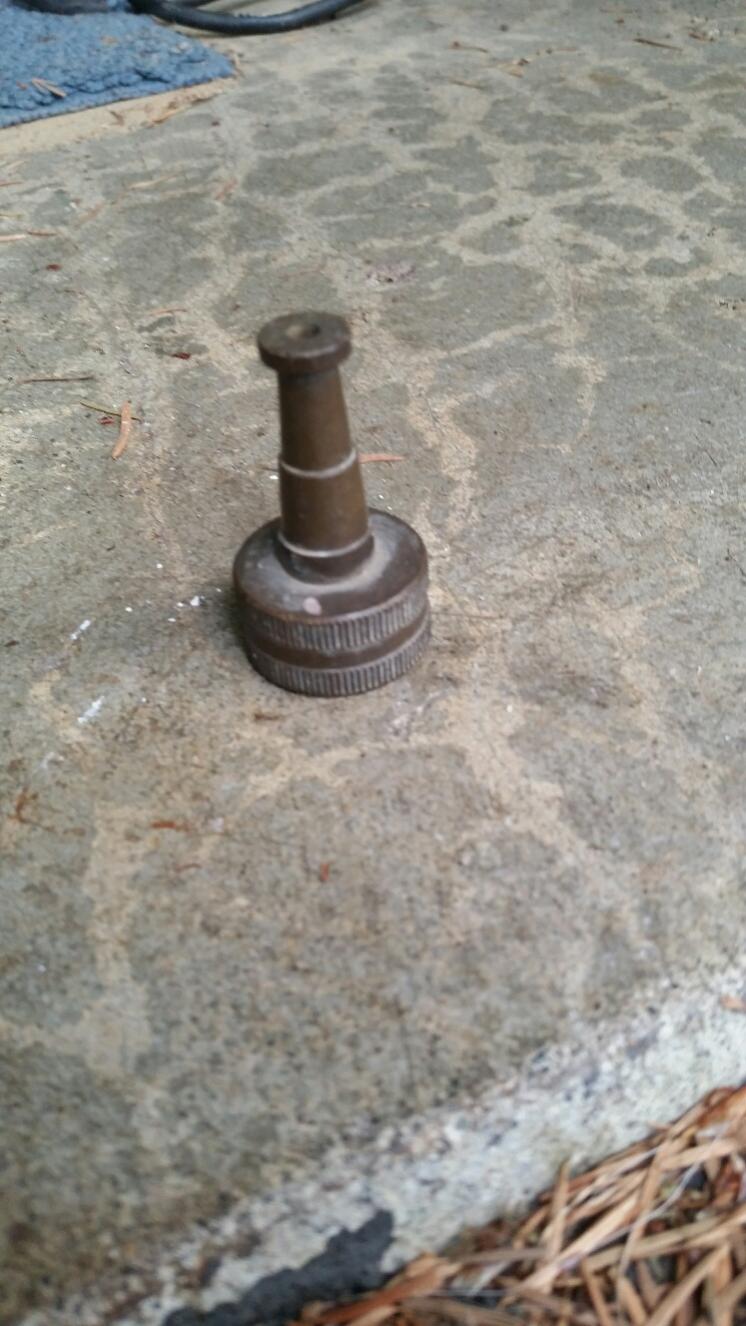

      Further investigation: seal replacement Timken 1049 also found the right size O.D. to use as seal driver lying around the house you'll never guess what : ) brass hose pressure nozzle. You know what they say, necessity is the mother of invention. Paul
