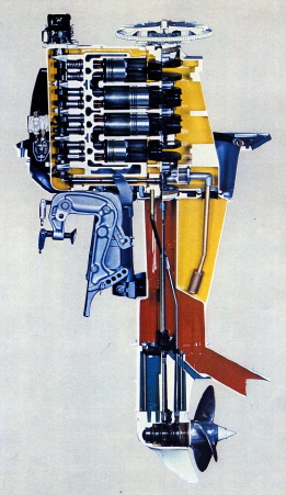

Thanks everybody that gives me some ideas might stop at Harbor freight and pickup one of those mini camera. I cleaned the relief valve it was all fine I think the pickup tube separated from pump the motor has been wrestled around a bit. It would shock me if they didn't have a bolt to hold that pickup tube in place I mean what a weak link!. Engine looks like it has never disassembled. UPDATE: Looking at this crosscut image it doesn't look like it can come apart very easy. What's next? PaulAttached FilesLast edited by frogpond; 09-21-2015, 04:10 PM.

I doubt the oil pickup tube came off, and pulling the power head to check would be about my last resort. Pull the plugs, spray some light oil in the cylinders, crank it over and give it time for the oil pressure to come up.
Dave
I agree that unless the engine was apart and the pickup tube was removed and replaced, it is unlikely that the pickup tube seal is the problem. That's why I asked whether the engine had been apart.
