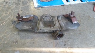

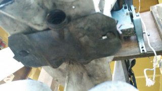

    I hooked up a flushing attachment that came with motor checked the fit looked good repaired a seal so fairly tight fit fired up motor didn't run very long 15 seconds or so I didn't get any pumping out of the pump no peeing out of Starboard tube probably smoked my impeller ? next, got a Rubbermaid container that everything fit in water level was up to intake scoop that didn't make any difference still no peeing checked port side tube coming from tee below no water in that either I assume that comes directly from tube coming out of pump. Do I need to submerge to have waterline above water pump location? or possibly pour water down tube to fill up /prime pump you wouldn't think that would be required to get this pump working. Also, looking for ideas on what people use for a flushing tank/vessel for running. Bearcat/Homelites. It was not new impeller but didn't looked that bad vanes were flexible still my wear plate needs to be replaced but still will work. Paul
    You may not get the pump to suck up water if the foot isn't submerged so that the pump is below water level (not sure), but you should get pumping with the hose attachment and the water pressure from the hose. No pumping with the latter suggests a pump failure or a blockage somewhere. I run mine in one of those blue plastic industrial 55 gal barrels (discarded from workplace) with the water level above the pump.

        When using a flush attachment you need to have the water spraying out of the two holes in the side about 2ft in order to have enough water to pump. Submerged in a barrel the six hex bolts above the scoop need to be under water about 3 inches, this is where the water pump is located.
