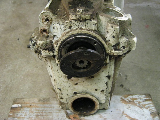

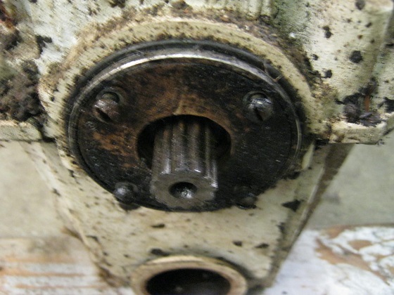

        Hi Joe having a little hard time on the retainer plate in front of seal at end of crankshaft got the motor out as suggested easy to work on but things seem to be stuck in place pretty good I have four screws removed and working a exact blade in between plate and housing soaking in Kroil right now maybe that will free it up any suggestions. Paul
          Thanks for the help Jhome, that was alot easier I had 8 bolts 4 on the side 4 underneth. Paul

            Been a while since I've had one apart but if my memory is correct there is a spring under the retainer plate and the plate is under pressure. I've got a couple powerheads in the garage and can refresh my memory this weekend with pictures.

              Hi Dick there is a spring (25) looks like in front of oil pump gear so looks like retainer plate is just stuck with gasket sealer or old age. So this is under tension strange it's so stuck maybe I need to tap it a little. My next plan was to get on backside of plate with flat side of bolt head and use a slide hammer any suggestions?.

                Okay I was mistaken, retainer is not under spring pressure. Must have been thinking of the oil pump gear. I took this off just by tapping on it after removing the screws.

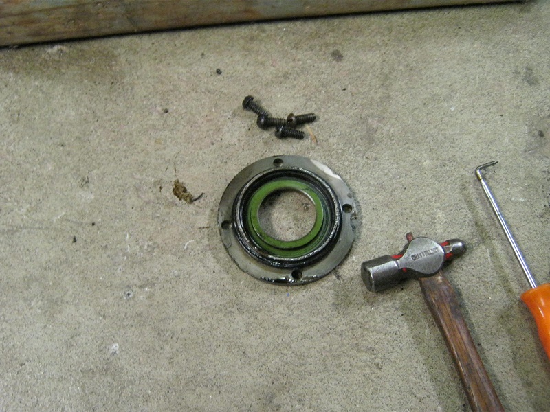

                  Tapping in, ? to rock it a little, could you possibly give me a seal number going to Mcquire bearing here in Tacoma to pick up a spedi sleeve to repair worn coupler seal surface. Was actually thinking of posting about this. Paul
                    I've never replaced the seal, I do have an interchange showing a National Seal #472475 and a CR #11763 Take the retainer and coupler with you, they can mic them and find a replacement.
                    Yes I just tapped on it and it loosened up, there is also an o-ring on the retainer.
