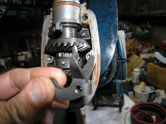

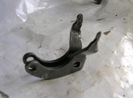

    Set for launch next week and I need to fix the shifter yoke in the lower unit. Its a little chewed up but could be made to work. Just wanted to see if anybody knows what works.
    I was thinking I could build up some welding rod on it and file it into shape. I think it was originally rounded to fit the collar.
    Or, maybe somebody at the boat club knows where to get an after-market yoke?
    Or just bend to work, because it is just a back up for now?

      So I wound up doing a lot of careful bending and some filing, and about 15 test fits later, I had it shifting and no binding. Then I put a carb kit in it, and it fired right up. Now it shifts solid and clean. Pushes the water around pretty good.
      Next Tuesday or Wednesday I should be back on the water after about 30 years. Man, that's toooo long.

          I'm just wondering how the heck it got bend like that. I have never seen one like that in all the lower units I have taken apart I have a parts lower unit that had a good shift fork if you need it I could send for postage cost.
          Mike aka pathfinderz1
