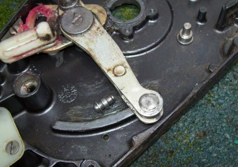

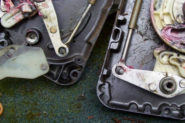

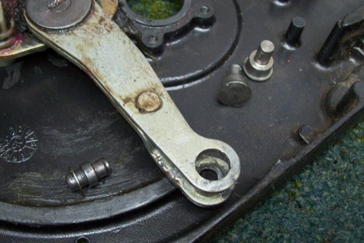

.....never seen these custom pins used inside an OMC control box and hope I never do again.They had to bend the levers to get them in,then I had to bend and pry to get them out,then bend it all back where it was supposed to be.Correct control cable pins shown sitting flush......

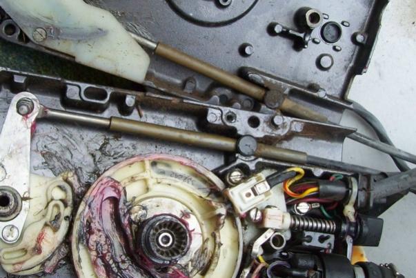

Then I saw a cut wire on the kill lanyard assy,bare hot horn leads(missing plastic shield) and to cap it off,the control cables were on backwards at the motor end.
Stopped popping fuses and now it goes to the start position as it should,and even reaches WOT.
