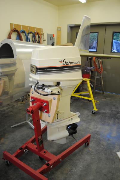

                    Mike,
                    For a few months I was intermittently monitoring used outboards on Craigslist, and I ended up purchasing this 1984 Johnson 70hp for $1,250 about three months ago. Seems like that is about what it’s worth. Seller acquired it from Minnesota for jet pump conversion, but never did anything with it. My intended use is a 1972 16' Fiberform (C-list free boat) under restoration. I didn't have to race over to the seller's house. Runs fine on the stand (fingers crossed). Hope it’s not too much of a gas hog at 50 – 60% power setting. Side-mount control box, bits and pieces harnesses purchased off Ebay; approx. another $285 (all used but in good condition).
                    I passed on a nice 1998 50hp 2 stroke Yamaha that was $2,450, and was pretty nice, manual tilt, included side mount control box and tach. This time of year is a little tough because people are gearing up for the season, but off season is somewhat more fruitful. My limited experience anyway.
                    Brian
