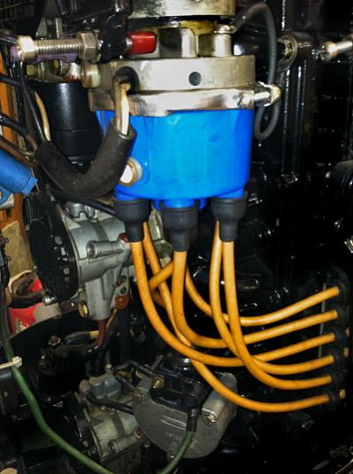

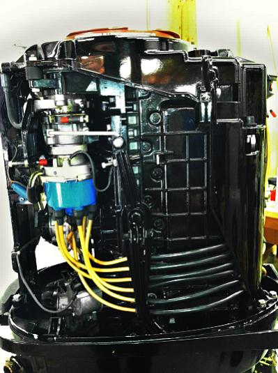

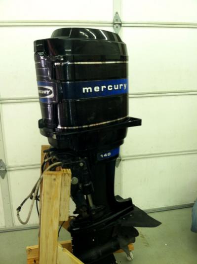

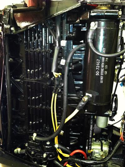

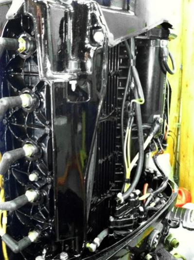

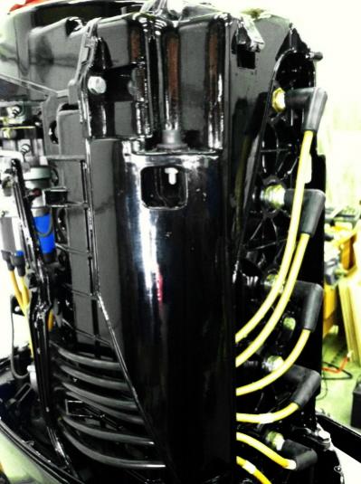

This gem followed me home Friday evening, with help from the ultimate enabler, engine acquisition specialist and craigslist addict, Slo-Mo.
After spraying fogging oil in the cylinders and turning it over by hand to lube them well, it started right up. The idle was a little smoky since the fuel I was using was one gallon of mix with a full can of Seafoam added, which I had been using to clean another motor. Compression is 120 across the board. Carb kits, fuel pump kit and impeller are on their way, but I couldn't wait to fire it up.
