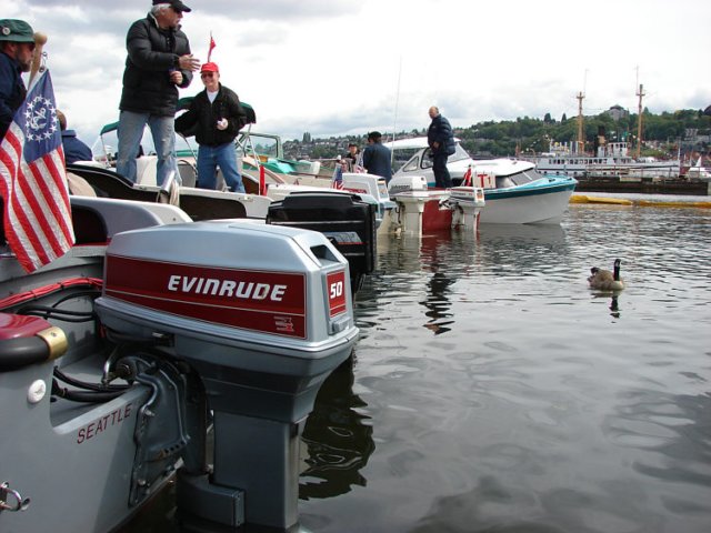

                        Joe you are right about the 50hp Evinrude. Mine was a 1986 and the one Greg has is a 1983. Great motors but after all you have to remember they are 25-28 years old. A good friend just pick up a 1983 Evinrude 70hp motor with trim and tilt ? I don't think there's that much difference ( i might be wrong ) when comparing them to the 50's. Chuck

                              The 50`s are great on gas for sure and do have their strong points.
                              They also have been known to eat lower units as they are stronger compression-wise,yet use smaller diameter shafts and parts in the lower.
                              The mid-section and tilting can also be hard to find parts for and while Jerry loves his 50 hp ,he is also getting ready to pay to revampt that manual tilt so he can use it as he wants.....Beaching is where this matters.
                              The power trims on these are also of a weaker design,not very stout,harder to find used,and even harder to work on as they are compact.
