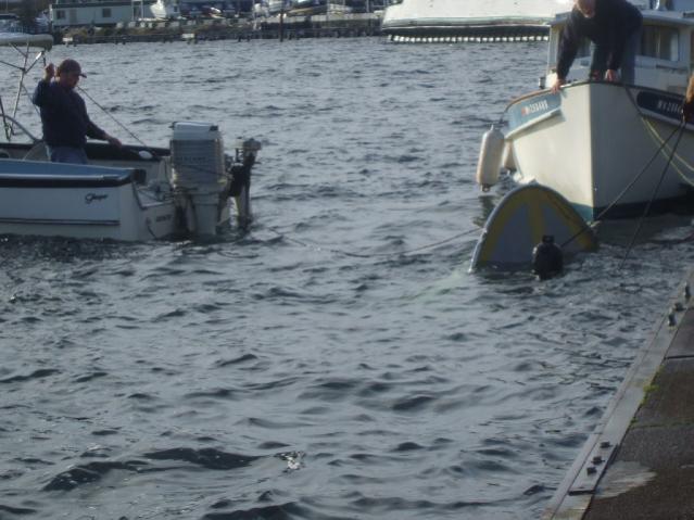

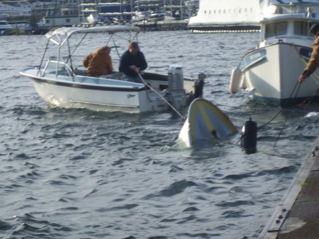

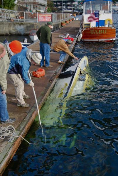

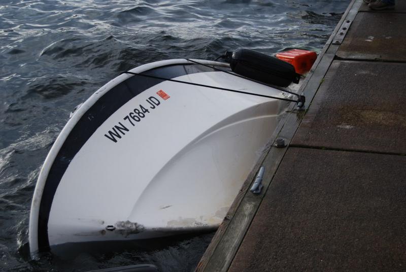

    Today's New Years Cruise was marred by the sinking of Tim Mattson's 17-foot Glasspar Seafair Sedan at the Ivar's dock. The boat went down when nobody was looking, while our group was having lunch inside the restaurant...so we don't know what caused what was obviously a sudden sinking...but the bottom line is that Tim is tonight facing a substantial bill from Vessel Assist and maybe other parties.
    Some of us had an informal passing-of-the-hat at the scene, but as of 4 p.m. the Vessel Assist boat had been unable to raise the sunken Glasspar, and their billing clock was running. A diver arrived shortly after 6 p.m. and just before 7 p.m. the crew got the first air bag into the boat and inflated, bringing the bow back to the surface. Tim reported that they hoped to get a second air bag into the stern area and bring the hull level with the surface so that high-volume pumps could begin to float the boat.
    When the boat rolled over, it was still tied to the Ivar's float by bow and stern lines, but it quickly became obvious that there was no way to roll it upright. (It was sobering to realize how unbelievably heavy one of our boats can become when submerged. Gordon Davies, with crew help from John Nelson, attempted to tow the sunken hull toward a nearby beach, but Gordon's big Merc was unable to budge the sunken boat; it just sat there on the bottom, as though firmly anchored in place. At that point the bow line was returned to Ivar's float, where it was secured to a dock cleat.)

                    WOW what a day! Glad to hear the boat and motors were recovered. I know with Tim's talent, Miss BeeHaven will be back. I don't think our futile attempt at towing it did anything but bury it deeper in the muck. You just wanna try anything at all to help out a lousy situation. Hang in there Tim!

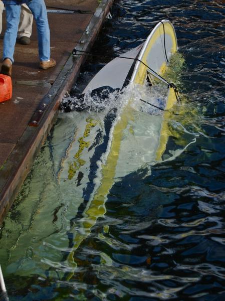

                        I`ll be getting my windows re-done in Lexan so some weight will be shed.Skip from Middy Plastics actually came to the dock and tried to offer help.He wished his Tug ,The Galene,was able to un-tie and also manuever but he could have took us all out.
                        Gordon really tried but the wind had created a current that was really pushing the boat under the dock.
                        I could see it was going to get really ugly and maybe would have destroyed it ,OR the other boats all tied up inside the Dock.....where I should have side-tied or even turned it around, which would have made this all not happen.
                        Later as the wind died ,the boat was easier to pull but it had already gone down to the mud,bow up.With less debris out aways ,again not under the dock in a tangle mess was probably safer for the diver involved.
                        Waiting until dark for the diver was really hard,but Emerald City Diving quoted the Capt. $3 K to come assist! That made my stomache sick to say the least.
                        I now think it actually was better 10` out from the dock,out -of view(looked like we were "pier Crabbing",only two lines going out to nowhere) and not tangled in unseen cables and the 8`` iron rods poking under the dock,(not shown in any pics because they were just under the edge).This also kept it from looking like an Eco disaster,grabbing the fuel tanks and debris quick saved me from an EPA greeting card.I convinced the Harbor Patrol we had pros coming and the sorta fibbed about sealed batteries....they stayed put and are still working.Even found the solid brass levered drain plug,which I had once found in the wormy leaves the day I brought her home.Stayed put right on a side shelf until I got home!
                        Raising it took 3 air bags!
                        Even then ,the lake kept trying to swamp it.
                        The cabin top almost let loose as the air bag was using the top to lift.
                        Another discovery,my fuel tanks were strapped under my rear seat bench and it Blew apart as the boat got heavy,thus letting the tanks float free instead of giving me a little flotation.
                        I built it to stand on so it was screwed from above.Never thought about the tanks lifting the Hull!
                        Flotation is coming soon ,and it will be pinned in tight for sure.
