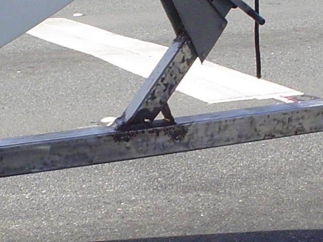

    Saw this trailer on the road yesterday, I sure hope he doesn't have to stop suddenly. I don't know how he could even retrieve the boat! It's hard to see in the photo but the base of the winch post was rusted through so that you could see spots of daylight all the way around it. This didn't look like a blackberry rescue, the boat looked like it was used regularly.
    Yikes! I hope you're not the only one to notice. :Bigdriving1: That boats going to be a hood ornament.

        Seen it before,winchstand fills wih water as it drips from a boat cover that just reaches the bow.Cover the top of the winchstand or fab a plug for it.Drains can be drilled in it ,then spot painted to prevent rust.

        I put a ratchet strap from the rusty winch to the frame in case the cable let loose.Got home and drilled a hole to drain under the floors.....after 4 ,5 gallons buckets were filled ,I un-did the strap and the frame lowered to the ground! Weird.....
        Wiggled it up one time and it snapped the frame from the tongue.
        This became a 2 pc trailer that was rolled out into the back 40 as a conversation pc.CutUp1
        Towed it home at 3:30 pm on Memorial Day weekend with 3-4 lanes of traffic behind me the whole way........so lucky.
        The newer 10 year old trailer did suffer a blow-out the day I sank the Glasspar so disaster can occur to even "modern" equipment.
        I also had my Dorsett on the ramp one time(kids in truck....) and had the base of the winchstand snap off as I tightened the safety chain......which did nothing as it no longer was attatched to the trailer!
