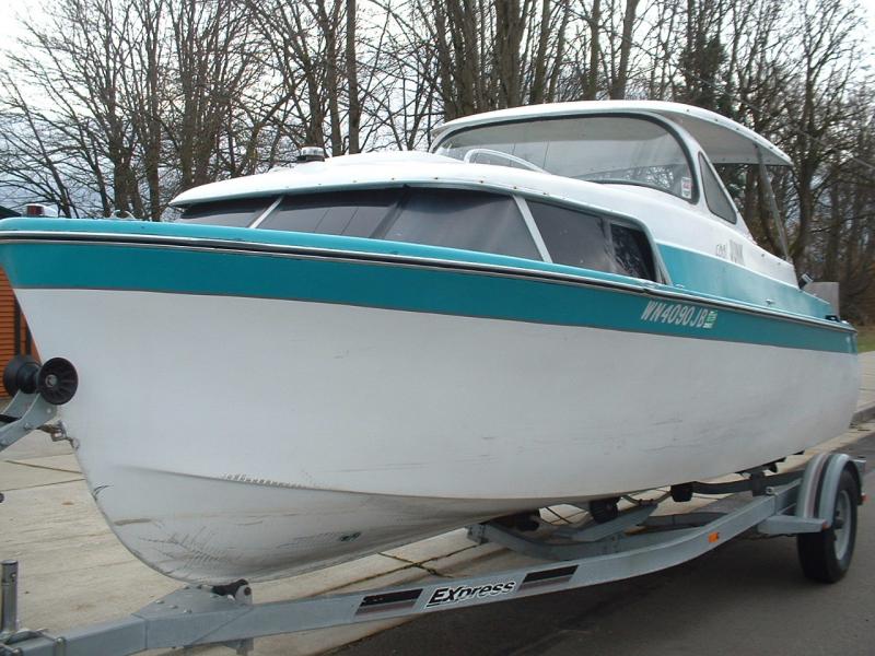

    Brian, You may want to put ballast up forward anyway. The people in the know will weigh in on motor size but I can share my personel experience. I own a 20' Skagit cuddy and put a new 90hp Etec on her. The bow was to light and it bounced alot going over waves giving it a rough ride. I put 3 60 pound bags of concrete in the bow and it changed every thing. The boat cuts threw the big ones with a much smoother ride. Have fun, John

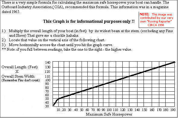

        here ya go
          WHat am I missing
          20 x 8 = 160 I have a 90 hp Can I really put another one on? John

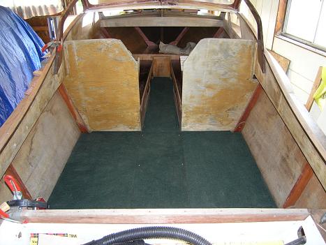

            The boat has twin batteries mounted at midship, each side, just in front of the seat bulkheads. They're basically on the hull. That seemed to make sense at the time. This is the motors view forward. It has power trim, that should help.
            It's 17' long and 7' beam at its widest. So according to the chart, with a 5' stern, 75 hp is toward the upper limit, but not over. So a small kicker 5 hp or so and I should be ok.
