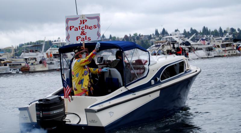

    It's the Mercury V-6 Black Max XR2 150 hp on the Dorsett Farallon. I'am a little tired of getting smoked out at idle speeds and sometimes at higher speeds.It did have a oil reservoir bottle idea,but Mercury i guess had some problems with them as i was told, so it was taken out and then back to the mixing of the oil in the tanks. I talked to a person in " the know " and he said it would cut down on the smoking problem going to a Synthetic 2-Cycle Oil HPI oil. The first thing i need to do is burn off the remainder of about 12 gal in the port saddle tank and then burn the other one off that is still full with 25 gal. The G-3 has a 65 hp Mercury that is fine without any smoking going on ,so i will keep using the quicksilver oil for that. PLEASE NOTE,THIS IS NOT A ENDORSEMENT FOR ANYONE TO DO THE SAME. Best,Chuck
