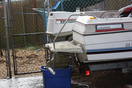

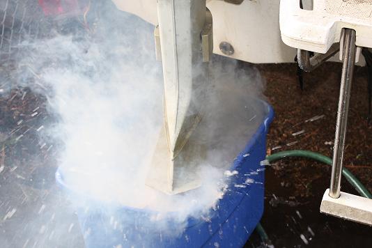

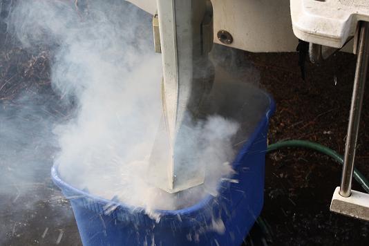

    hey guys,
    finally i got a boat done and ready for the water.have one question tho i got the motor on yesterday it's a 60hp evinrude selec shift runs fine not sure if it's supposed to be peeing out of the holes just below the cowling or if it's the kind that sends the water back out thru the prop? when it was running yesterday in the bucket in neutral it semed like it was pumpin water cause water was comming out of the bucket with force. also i might have the oil to heavy or is it supposed to smoke like that?not sure of the exact mix ratio!!! here are a couple pics. anyone busy next weekend?????

    Looks like about the right amount of smoke for running in a barrel. The water out the pee hole is to let you know the water pump is pumping. Proper oil mixture is important in all outboard motors. I'm on my way in the morning to get four quarts of Amzoil synthetic and I'll run it at 50:1 in my 1986 'Rude 50. This mixture is about right for most motors after the 1950s, I've found. Okay, not for you Homelite guys but that's another matter.l

                  Looks to me like a nicely "Fogged " motor being run after some resting.
                  They usually put off Blu smoke when put away correctly.
                  Cooling: The older OMCs sometimes do not have a real telltale,with water coming out relief ports at upper rear of mid-section and then most going down the exhaust.As you throttle up and the relief springs do their thing,water then flows more freely from the upper rear holes.
                  Use a wet finger on head to tell if it`s getting hot or cooling as needed.T-stats do need to open and close.....
                  I`d run engine with Engine Tuner,De-carbonizer or Ring-Free thru the fuel system and /or sprayed down the carb while at fast idle ,let soak 15 minutes then run to clear it out.Never leave this stuff inside without running.
