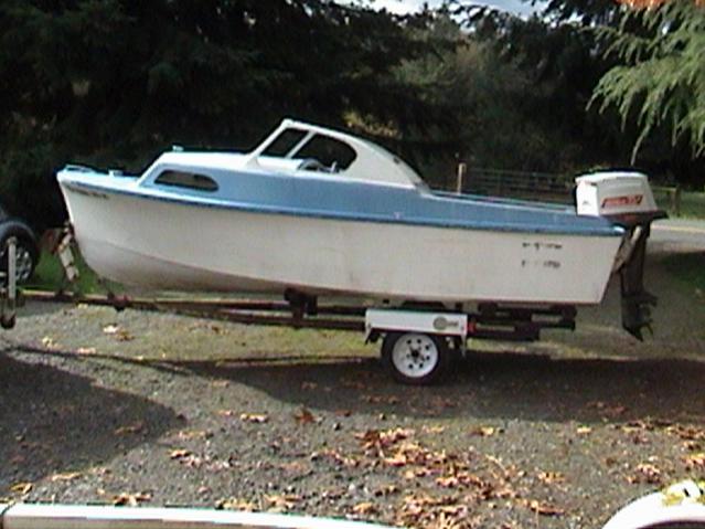

    I found a guy who has a 16 foot 1957 bellboy with the cabin up front. It needs a full restoration. Has a rotton floor and transom. Everything else is there. no motor or trailer. All windows and trim. Does anyone know how much it might be worth? Is it rare?
    Need some help to know if it might be a keeper.
    It looks like the one in the photo but is not the actual one.
    All help is appreciated,
    Ron

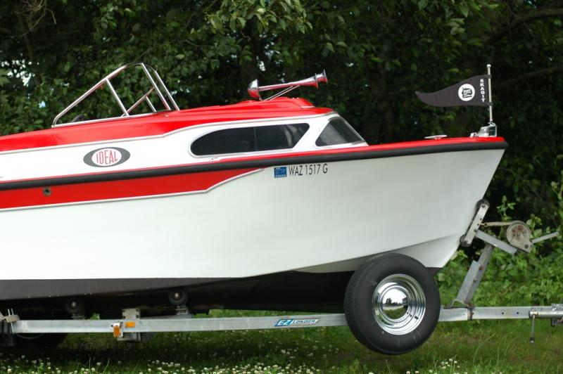

    I`ll try to post the pics I just took,might be too big but here goes....seems to be working,check out the Rideguide Bezel,as my kids would say,"Epic".
    That item plus the newer Merc 60 hp and the like new Galvie trailer sealed this deal.
