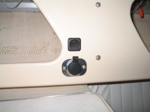

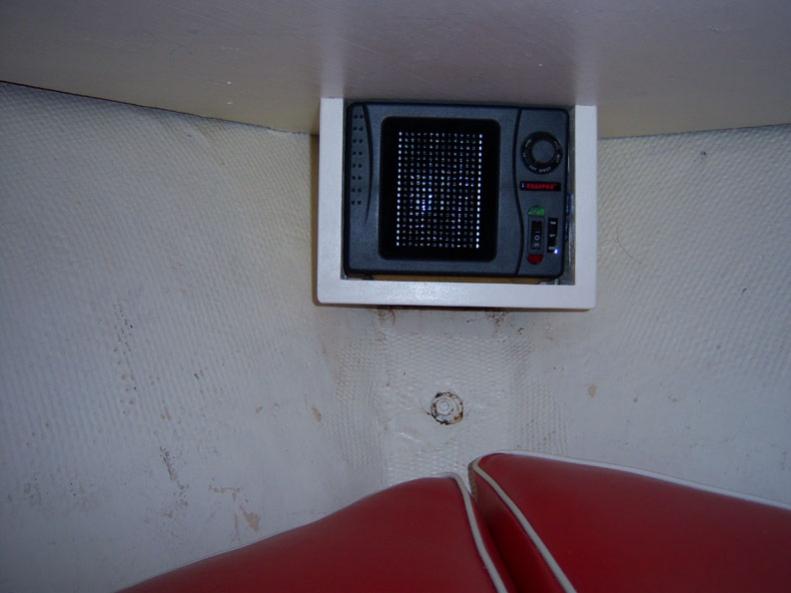

                    In my BellBoy Express cabin, I have used this 300 watt 12 volt ceramic heater. It will not roast the cabin but does warm it. I have not been on the water in really cold temperatures (45-50 degrees Fahrenheit minimum) The propane portable would do a better job, I am sure, but I do have this heater hard wired with an illuminated cabin switch so it is convenient and maintenance free. Here is the site and a picture of mine installed under the V-berth shelf.

                      Your 12V system looks perfect for your use and I'm sure for many others also. Nice installation. I seriously looked at using that unit on my boat as I had a great place to put it where the CB unit used to be. The beauty of your system is it's out of the way and when you need to use it you can just flip a switch, no setup.
