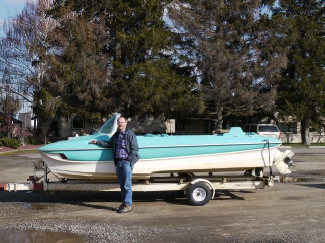

    Howdy Folks,
    Well, after months of lurking I finally snapped up my classic... a 1964 Johnson Deluxe, complete with Johnson trailer. Looked OK, mechanically pretty good, needed maybe just some cosmetic stuff. Paid way too much for it, but - oh well.
    A week after I got it home the gas tank rusted through and dumped about five gallons of fuel into the boat. I put it on the scales and it's about 500 lbs overweight. Floors are coming out along with waterlogged foam. Oh yeah, it needs a new convertible top and frame, too.
    You know, I thought I would be more upset about this, but all I can think about is how much fun it will be to get this little turkey with its stepped bottom on the water. I'm afraid I've caught Old Boat Fever.
    Ed

    Cool boat! What is the length?
    I worked on one called a Sweet 16 many years ago. Had a two stroke V-4 hooked to a stern drive. Real glass curved windshield. They are great riding boats for their size.
    Congrats!

              Thanks for the encouragement, guys! I also appreciate the advice on pulling the floors and foam. The engine comes out tomorrow and then the real fun starts. I'll try to post pictures as I go.
              The boat is a 17' Deluxe with the 150hp V6. Here's a good website on the Johnson boats: http://www.ultimate.com/omc-boats/
