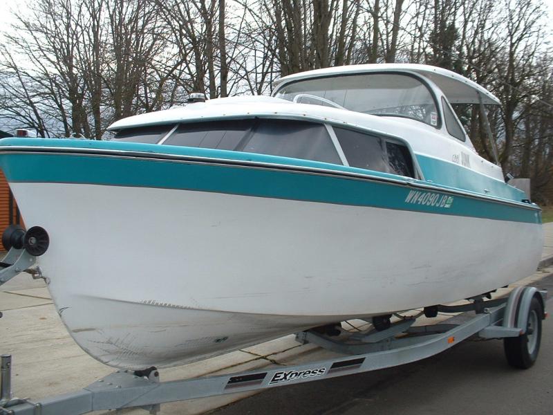

          First thanks for the replies. I got a chance to go look at and ride in a 1960 404 Express today. It was a really cool boat. Needs some TLC and resto but all in all could be put to use right away. Specially if I hang the ETEC on her. My thoughts on the ride...gets on plane fast, drafts crazy high. Man that freeboard is awesome. My little girls won't be flying over the side of that one. Went over some small chop and a wake here and there...pretty rough. I also found it handled a bit sluggish. Didn't respond as quick as I would have really wanted. We were in some current and the owner blamed it on that but...The motor cavitated a lot specially in turns. It is an 83 Johnson 90 V4. I thought maybe it was mounted too high but the owner claims that's where it should be. The cavitation caused a loss of both power and added to the sluggish response. In truth I would have trailered it home had I not ridden in it and started to have second thoughts. So as I was coming home I was thinking maybe I have to recalibrate my expectations on the ride. Also..almost verbatim, I thought the same thing that Tim posted. So I have not ruled that boat out yet but am thinking about it some more. I was also looking a clean '58 404. I dig the fins but they are totally not practical for fishing. They also add about 3" of height to the freeboard...I'd need a foot stool to get up and over the fins to net a fish.

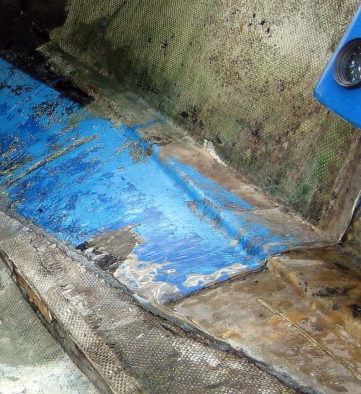

            Reason for the break

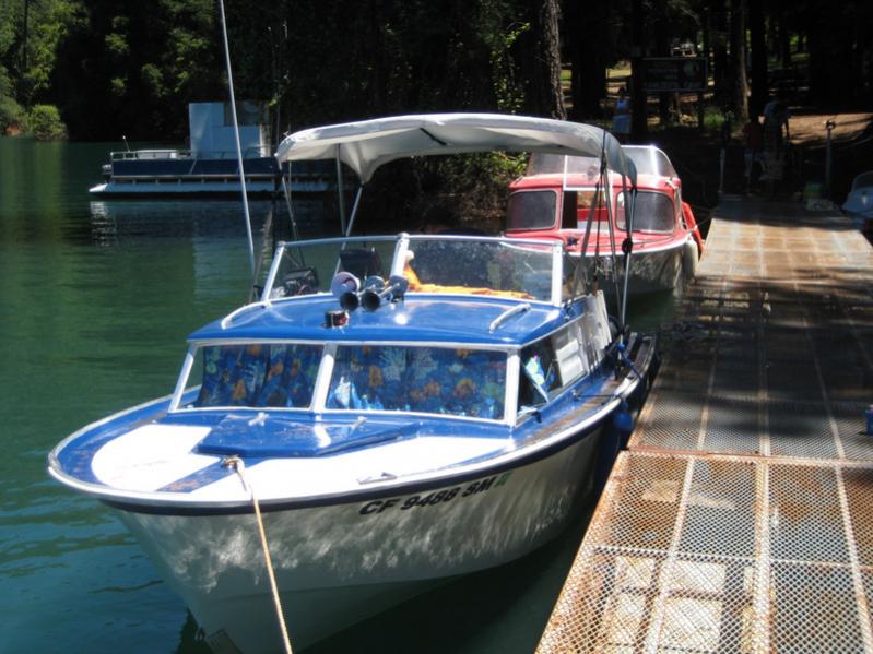

            First here's my baby before
            Here she is on July 5th

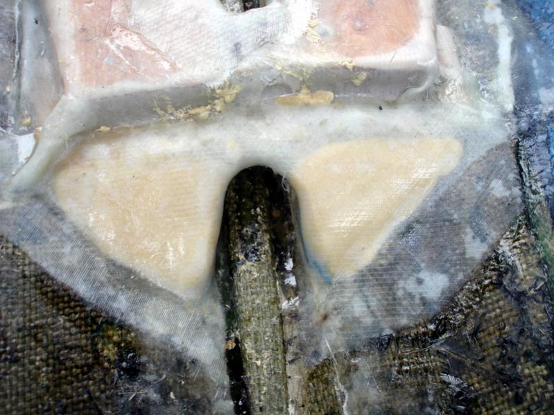

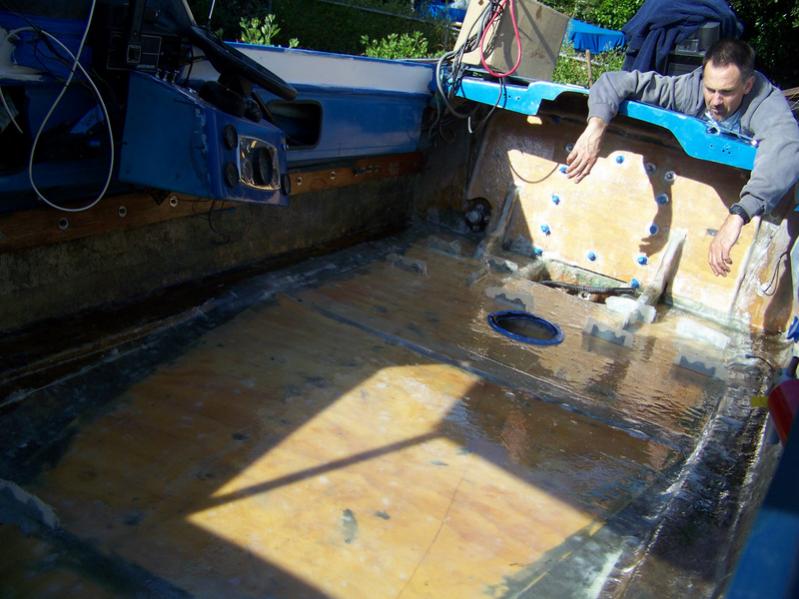

            It looks like it was a bad patch from a previous owner that failed. You can see the old gelcoat underneath. I was going to get it repaired but now I see cracks along the whole length of the starboard stepchine and parts of the port side step chine. I just think the hull was damaged beyond any good repair that I am willing to do at this point. I already replaced and glassed in a new floor and stringers. I have spent a lot of time and now after this I just feel it's time to move on. That Seafair was the BEST riding boat on a choppy day of any boat her class I have ridden in.

                      I did a quick cosmetic resto on mine and paid dearly by not foaming it as much as I should have.I eventually intend to re-do the old stringers and will basically lay Woven roving down the inside outer Foot of the Hull,basically doubling up the Step Chine area I see was pretty thin.I put Chopped strand from my new floor skin to the cockpit sides but no Woven......
                      Your feet can feel the water and if you pile drive off a wave in the denser Salt water,it is more like concrete than water.
                      Sure looks like the old Trailer and a Rough Road also had something to do with the original Damage the prior owner had to fix.....looks like the new floors ended just inside there.Or maybe a Toolbox or anchor in that storage area?
                      I`m even leaning towards raising the floors and doing a crossways set of bulkheads to build the floors up 4`` or so with foamed corners.

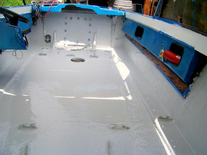

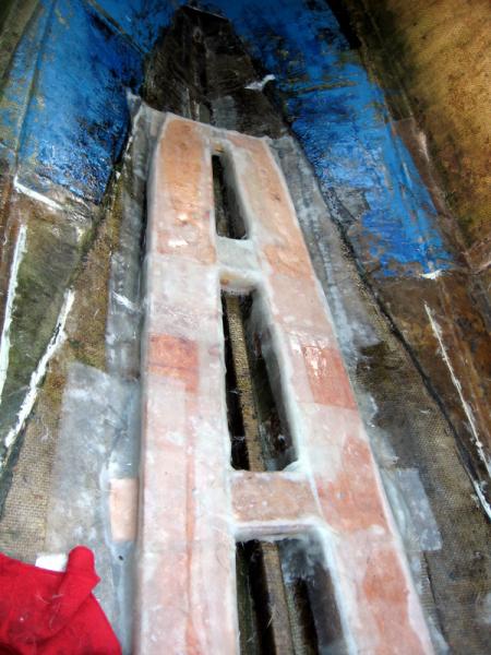

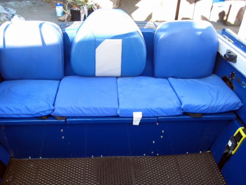

                        Very astute! She's a one-of-a-kind. Yes she was an I/O. That's why I have a lot of space in the cockpit. Because it was an I/O it has 1 x 8 original wood-on-foam stringers..(True rough sawn 1 x 8). When I replaced the stringers and floor I replaced them with 2 x 8 The 2 x 8 lay on 1 x 4 crossway braces every 2 ft. I used 5/8 ply and poured foam in every open space under the floor except a bilge channel between the stringers. I also put my batteries up front under the V-Berth where you see "a Toolbox". I had a gel battery on each side. Maybe that contributed to the crack??? I wouldn't think so though. The floor and stringers are really solid and she feels really stout in the chop. No twisting or creaking...until of course the hull broke. I really think it was due to a bad patch. I have a guy that is going to start working on it Saturday so I'll take it day by day. If it looks like a straight forward fix...heck it's fiberglass...then it should be fine. The only thing is you know and I know repaired fiberglass can be stronger than original, but my wife is now questioning whether she will ride in the boat on the Bay after it is fixed....so whattya do? Either way I'll get her fixed. She's worth a lot more towards a different boat if she floats.

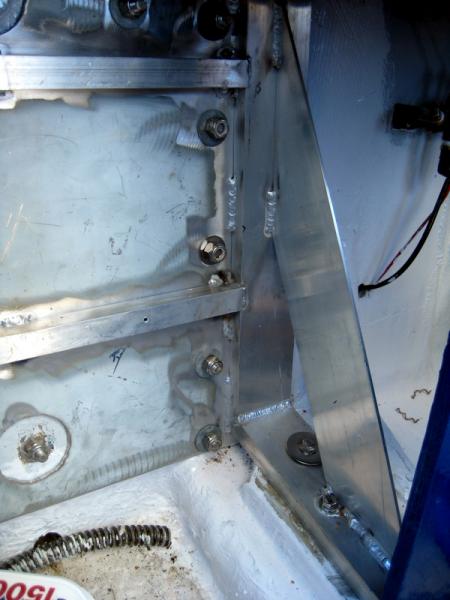

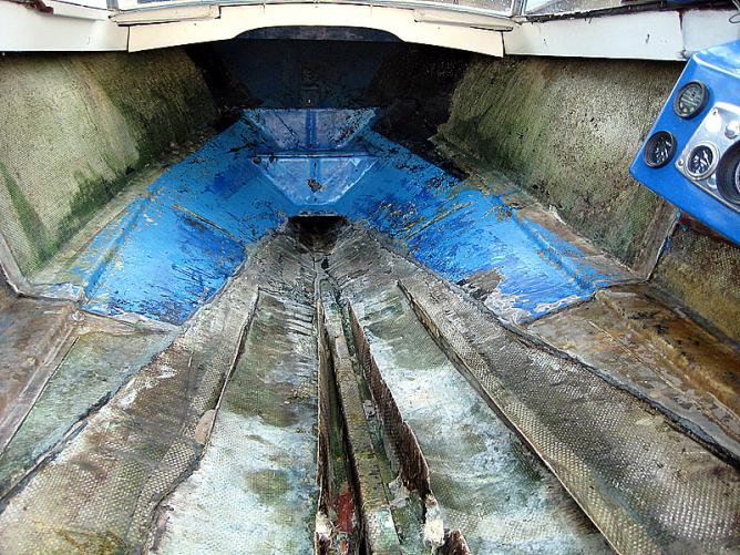

                          I know you all like pics so here are some. Funny as I was looking at the pic of the stripped out and gutted hull I exploded the pic and saw the patch that failed. I feel really stupid that it wasn't obvious to me back then but to be honest we totally missed it I cropped it out from the pic so you can all see it clearly...at least I am now convinced that was the problem. The rest are some of the stringers, foam, floor, transom conversion and an aluminum bracket we had made to beef up the transom for the ETEC. Also pics of fun.
