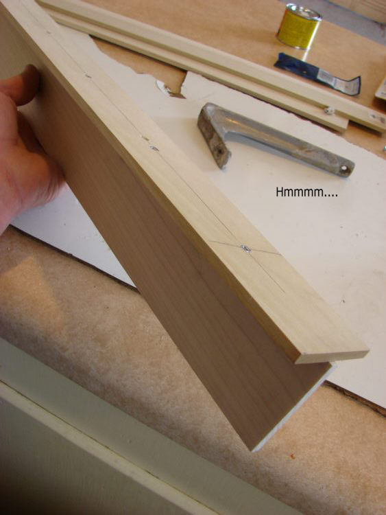

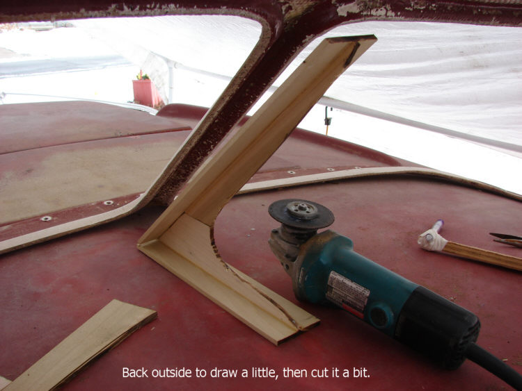

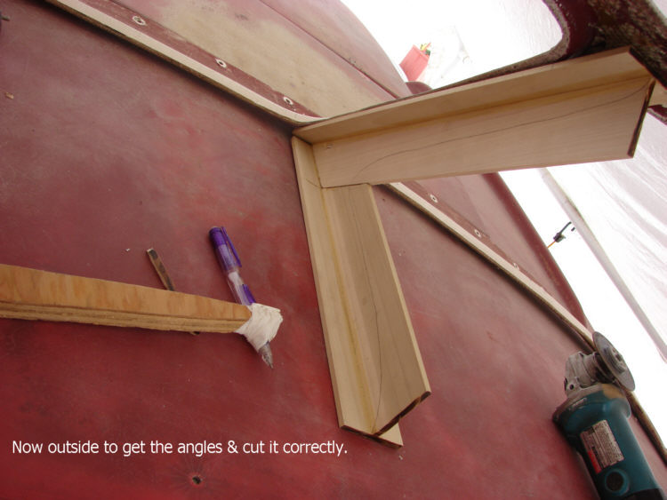

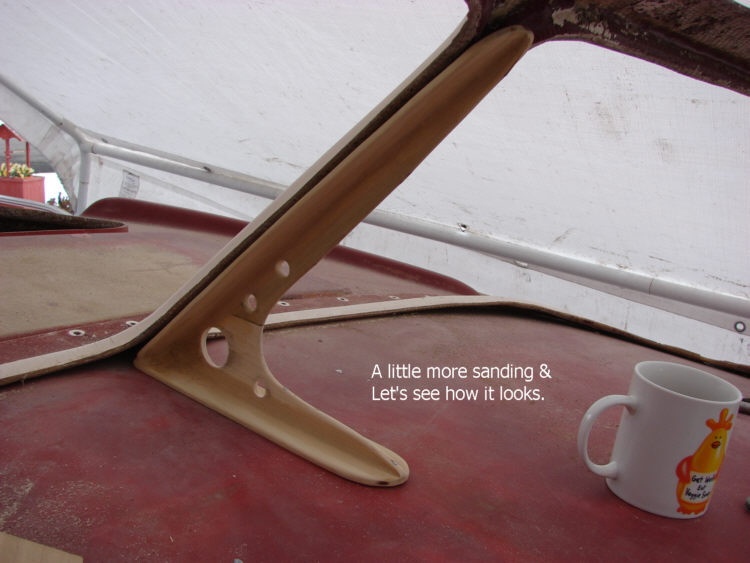

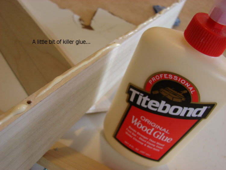

So, I headed to the hardware store for a little wood, screws, filler & glue. My plan? To make a plug for an aluminum casting which would end up being the center windshield brace.
If anyone with a 1957 or 58 17 footer or 20 with the upper split windshield is interested in one of these, let me know. I'm having it cast in aluminum shortly.
So, on we went. A few pics of the progress.
