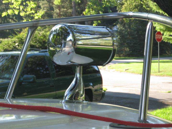

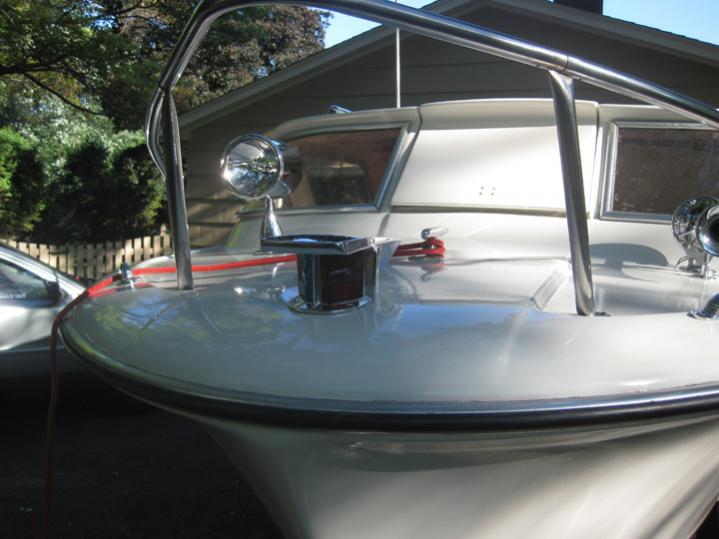

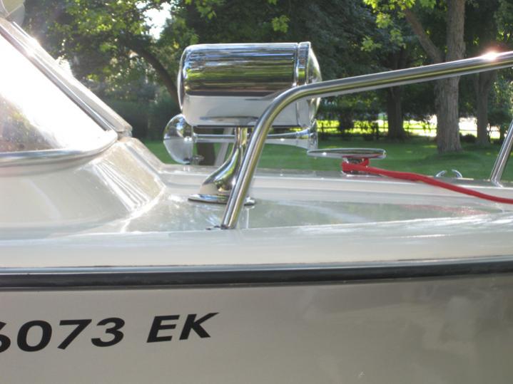

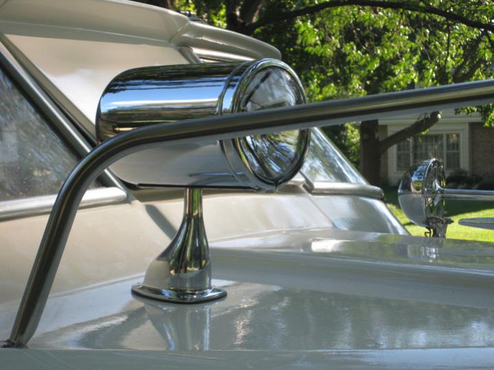

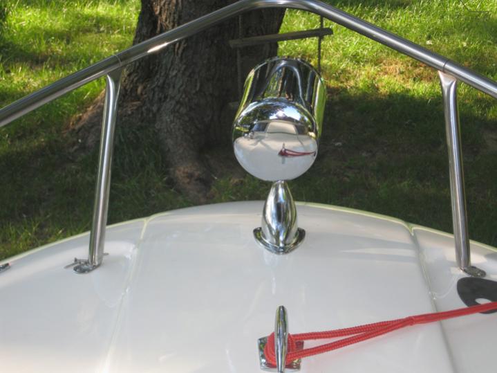

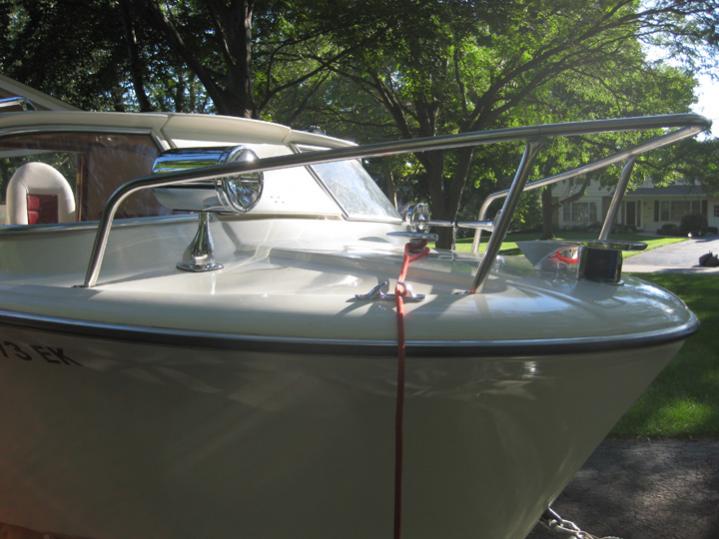

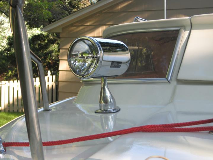

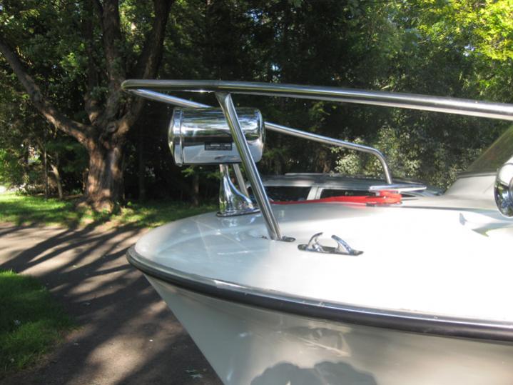

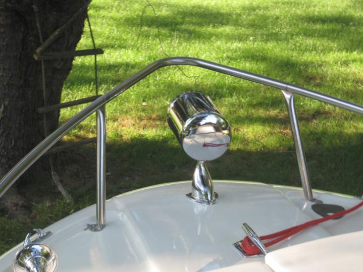

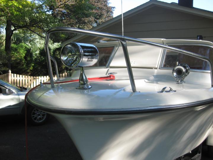

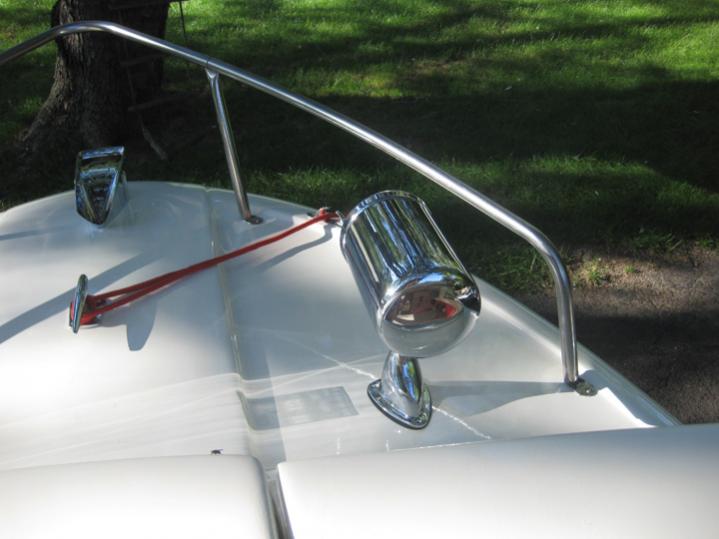

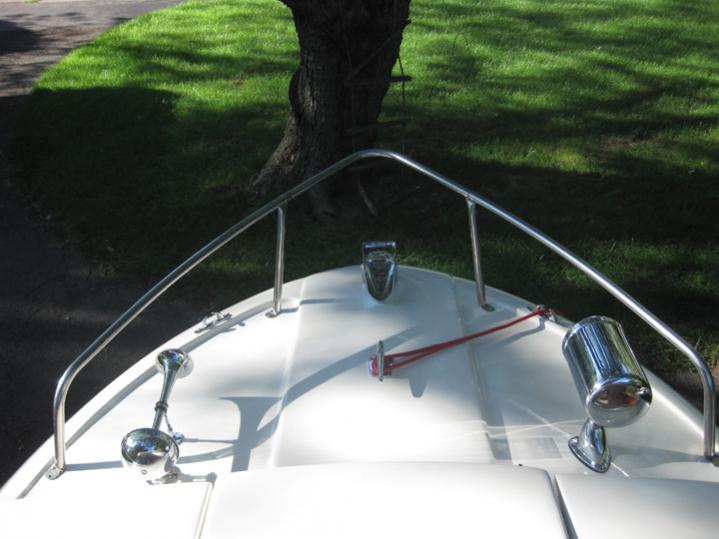

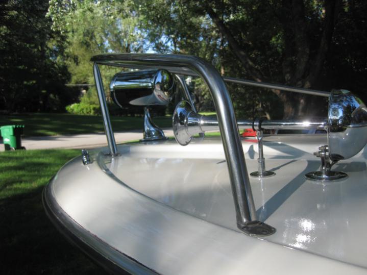

    I purchased the Jabsco 6" spotlight for the BellBoy and when it arrived, I was surprised at how large the light actually is. I bought it after selling my older Jabsco on Ebay (for more than I paid for it!!) because this one has a 200,000 candle power spot and a 50,000 power flood. I like that kind of power on Lake Ontario at night. And I love the chrome look of the light! Anyway, if I put it where the other spot was mounted on the starboard side of the front deck, it looks huge there. I could leave it there. I temporally removed my bow nav light and placed the big spot right up at the bow in front. If I left it there, I would buy Perko individual port and starboard nave lights and mount them on the hull right behind the reg. numbers. What do you all think??
    Thanks in advance for your input!
    a confused BellBoyBob
    Spotlight
    Bob -
    For what it's worth (not much), I'd put it right where the previous light was mounted.
      Your Bell Boy is looking sweet Bob- I think the large center mount spot looks great within your bow rail, side nav. lights would be perfect- makes it look official! and substantial, says "don't mess with me"!
        Lower the light
        If you put it where the other one was it might not look as big if you cut the base down so it was as high as your horns. I dont think you can get it wrong. Nice boat. John

          I'd mount the light on the cabin top. May have to make a small light shield to minimize the stray light. Or you could mount it on the bow and paint the light with camouflage paint. That way you won't see it....
          This is more than a cosmetic issue. This is a practicality issue.... Function over form.....

            Bob, I wouldn't put it on th bow at all. It seems like if it were located almost anywhere on the bow it would obstruct the view. If you have a hard top maybe that's an alternitive. I just bought a front windows in the fiberglass frame for my Skag. 17 from Chuck C. and it has this funky hand directed 6" light mounted throu the starboard side of the window frame.

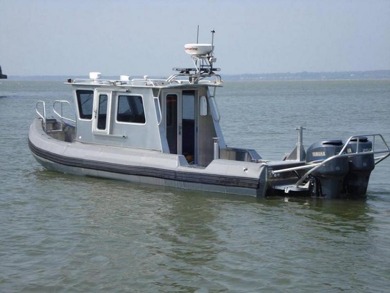

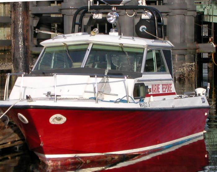

                  I remember from my time designing cruisers at ACB that there was a great deal of attention paid to "stray light" as Tim put it. From the look of it in your pictures it seems to me that with it mounted in the original location you might get a lot of glare back from those well polished bow rails and it is a little more likely to light up the deck which then casts a shadow over the water (or dock) directly in front of the boat. I know I designed a light/radar arch for a patrol boat in Miami that had the same light on a hinge mount so they could trailer the boat. The photo is of another boat with radar arch I designed to fold down off the back of the cabin, just had two mounts with a pivot point on each end and a pin lock to hold it in position (the radar on top of that little structure was nearly 100lbs) you should be able to divise a simple system that would rotate the light sideways and hinge it over to clear the garage..
                  If you can post some details of the lights dimensions I am sure there are a few of us that could help you work out a pretty slick system that would get where ever you want it and keep it descrete...

                    These are very interesting solutions for this mammoth light! The previous Jabsco light sat lower than this one and the beam shot right under the right bow rail so there was little reflection from it at night. I noticed that the 6" light I have now sits up a bit higher and the rail is directly in the line of fire. Jabsco does offer a lower mount and I will contact the online dealer ( IMarine.com) to see if I can swap out the mounts free of charge. They are individually quite expensive. OR, I could put it up on the cabin roof with some sort of hinged platform so that I could swing it over the roof edge on the side to get the boat in the garage. No amount of air letting in my 12 " tires would lower the boat enough.
                    Again, the easiest thing to do would be to center the light at the tip of the bow and then buy side mounted nav lights...

                        I sold a few New boats over the years that were rigged with Bowlights mounted in various places.The Railings will light up and draw your eyes when in pitch Black conditions and some wished they never put the Spotlights on Cabin Roofs for this same reason.
                        I painted my SAFE Boat railings Grey because of this but not likely to happen or look right on your old cruiser.
                        Boats are also moving much more up and down and lights may work well on the Highway,but are useable on pretty rare occasions on our bumpy waters.With Trim angles and weight changing almost all the time,it is hard to balance it all and have them pointing where you truly need them.......at least when running.
                        Docking or searching for Crab pots ,buoys ,etc,it will have it`s place.
                        Like a Flashlight at Night,you want to be behind it instead of in the Beam.

                            So, today, I mounted the helm control and ran the wiring out the right cabin window so I could experiment with light placement. I used duct tape to hold the light base securely where the old light had been mounted. I pushed the boat out into the driveway at night and turned the thing on. WOW! the spot is very focused and penetrating. The flood option really illuminates the area right in front of the boat. There was little to no reflection from the bow rail. The Jabsco 6" model has the SOS option that automatically sends the distress code while rotating the light from side to side. Love that!
                            I decided to mount the light where the old one was.
