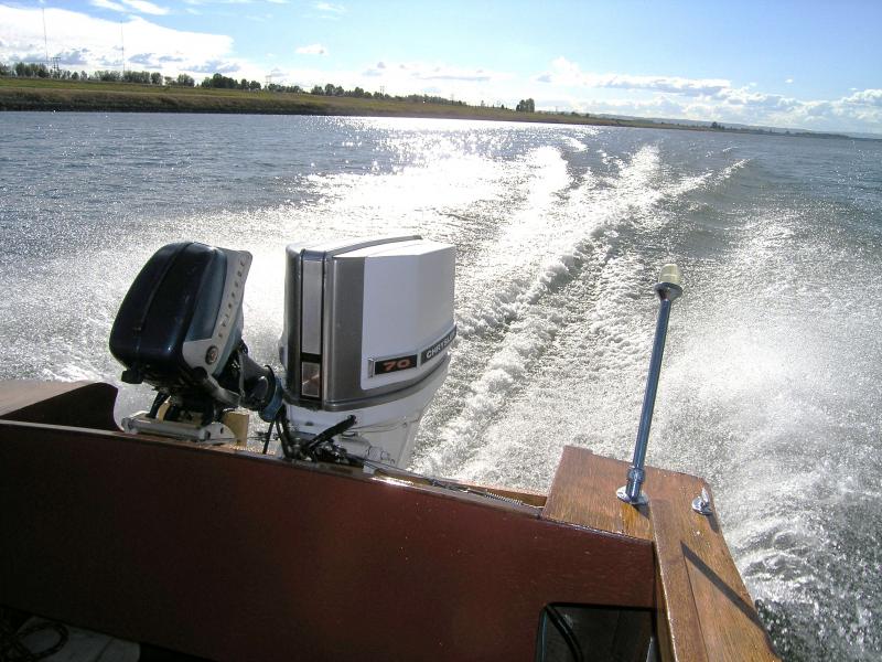

    Thursday, canibalized the blown motor and put carb's, fuel pump and ignition on a 70 hp 'freshly un-siezed' motor I picked up in Kelso last month for $100. It fired right up so I installed it on the boat right beside the kicker.
    Friday, we're back on the water having a picnic lunch on Government island, playing in the water and eating black berries. The Chrysler's running good. :boater1: Pulled the boat into a 15 knot head wind and fired up the Evinrude 7.5 hp kicker. It pushed us along at around 5 knots. Could have used this motor on Tuesday.
