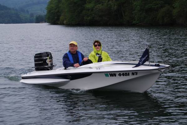

      Todd, If you want a very nice Mercury look below. Call anytime even on weekend's . I will return it soon. Best, Chuck
      Thanks Jerry !
      Chuck's Winter Lay-A-Way Program...
      That's right ! Plan ahead for next spring boating season with a super nice motor to start the year off with. Call for information on a monthly payment plan. Debit or Credit Cards accepted. Thanks,Chuck
      Thom Adams (Dr Frankenmerc) has checked out this very nice 85 hp Merc 1974-75 850 4 cylinder long shaft with power trim that i had already purchased from him in June. Now that i have a 20' Skagit ( Bainbridge ) with a Merc 115hp 4 stroke motor ,i will not being needing it. The lower unit has been re-sealed, pressure tested, & a new impeller and gear oil installed.The motor has had the carburetors rebuilt, the fuel pump rebuilt, all new fuel hoses. the ignition trigger has been rebuilt with new bearings, a replacement rotor and drive belt, a very good condition used distributor cap. and the rectifier & stator work properly to maintain a charge in the boat battery.The swivel and tilt work very smoothly as well. Ready to go price with controls. Only $1750.00. 425-742-4319 or 1-800-637-9190 or charlescarey@frontier.com

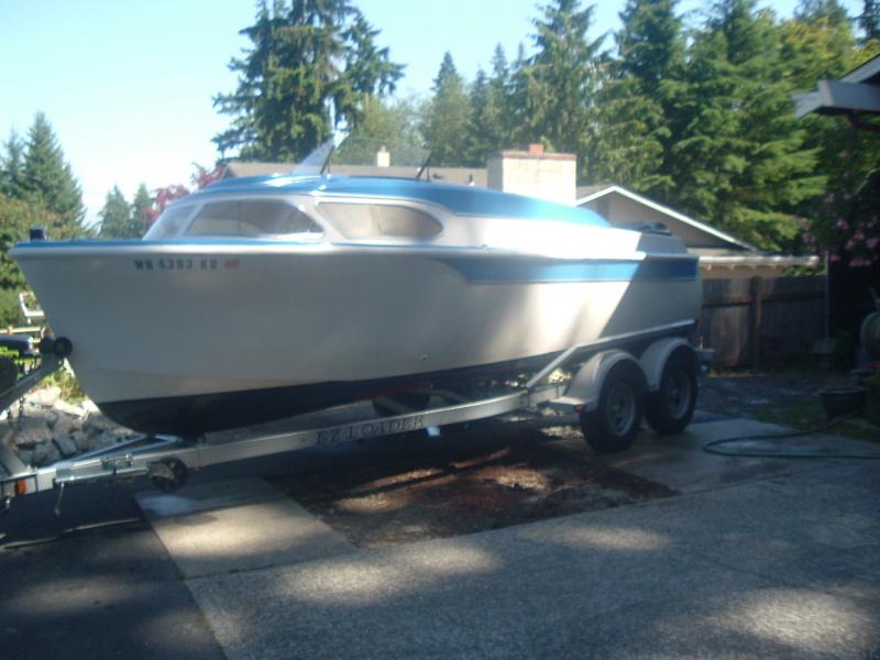

                          Greg, Change with the wind ? Maybe just a little bit. The Skagit ( Bainbridge ) color combo has has three change orders as of now. I hope the painting will be done by this coming weekend with the warmer temp's. Chuck

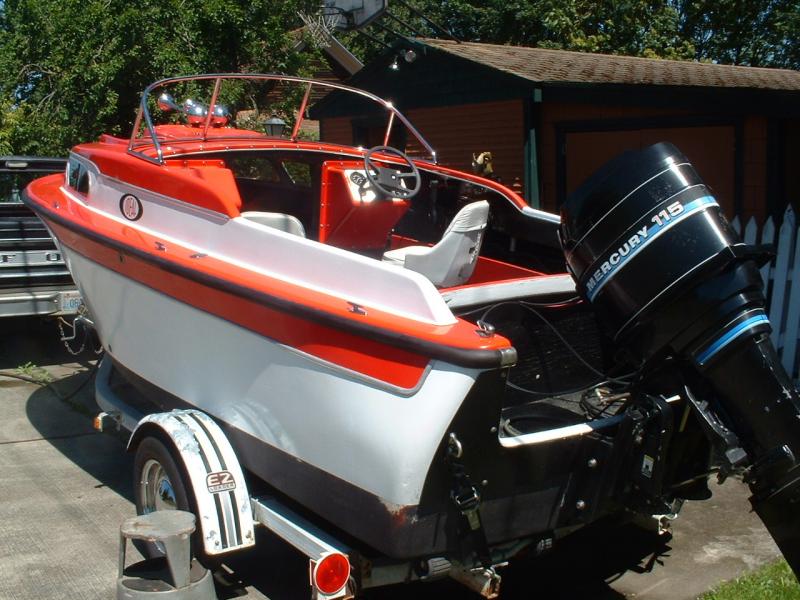

                            Jack plate
                            Its kind of hard to see in this pic but I bought a Jack plate on Ebay so I could mount a 20" motor on a 15" transom. It also set the motor back about 8". I hear that it makes the boat handle better when motor is set back. Ive seen conversions from IB to OB where they set them back 3 feet.
                            You mentioned that your inexpensive boat project is adding up quickly. Welcome to the club. John
                              Jackplate Querry
                              Hey John,
                              We are looking to install or build one of these for a 16` Bellboy I`m helping re-do.Really worried about balance and am wondering what you experianced after moving the Mercury back and up.
                              Anything we need to know or and does it make it turn quicker or lean back on holeshot?
                              Thanx for any info.
