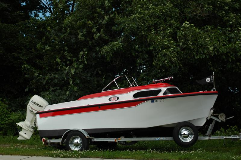

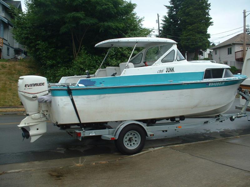

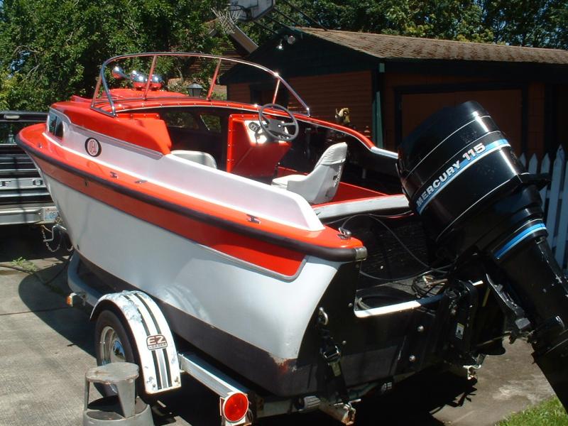

    Tim, I wish I had some info but i have none. I bought the Etec and mounted it on Ideal. I ran around on Lake washington for a day. My boat has not been finished so the cabin is empty and I have not had time to deal with weight balance. In turns it felt like it wanted to roll over and out of the hole it would stand up on its transom before settling down. I did not like the beige motor with the white hull so I moved it to Cool Junk and replaced it with the Merc. I took it out for an hour and had the same problem. I didn't have time this year to fine tune the idle or finish the boat so I put it away untill next year. I hope when its finished it will perform better. John
