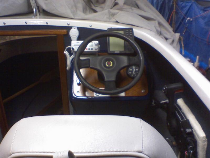

Hello, Out there ! Jerry, Back in from the shelter after wiring the GPS & VHF on the Skagit. A little bit on the cool side. Just about have everything done now. Even with a cover over her, she is going to need a bubble bath ( getting dirty ) and a little air in the trailer tires sometime soon. ChuckAttached Files1957 17' Skagit Express Cruiser
