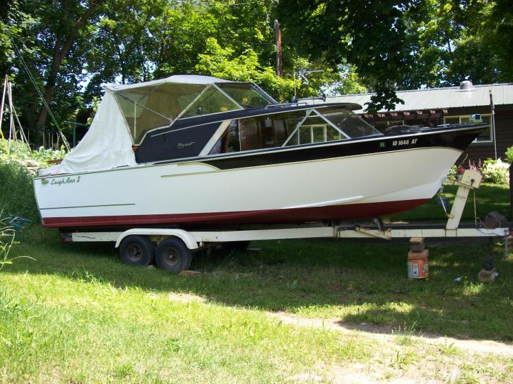

    As I near the end of the restoration of this 22' 1958 Bryant, I am eager to get her into the water. However since this is my first resto project, and I am unfamiliar with these older engines, I am having difficulty identifying and locating the necessary parts to hook up the push/pull steering cable (Vollrath) to the front of the engine bracket. The outboard is a 1960 75 hp Johnson electric start.

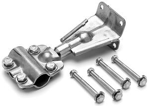

    See photo - Teleflex calls it a "clamp block"
    Google that term and you will find various models. Make sure you use some type if bedding compound to seal the bolt holes that go through the transom. The boat I am restoring did not, and used zinc plated steel bolts that rusted away. Water intruded into the plywood transom core, and it rotted down below. Teleflex makes a stainless steel model.

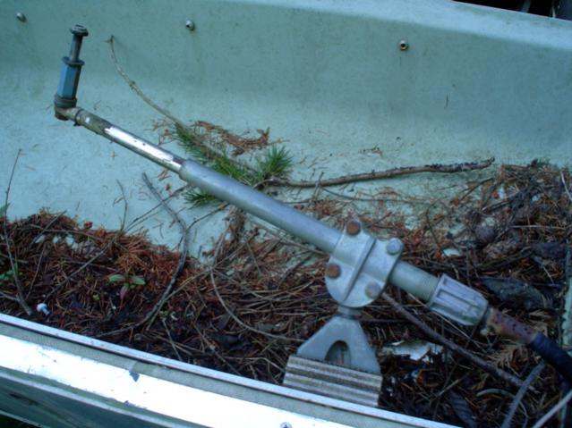

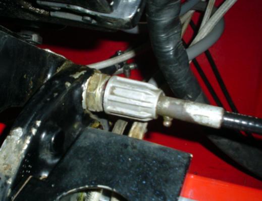

        In addition to the clamp block that Brian showed the photo of, you'll need another part to mount the cable, basically a pipe with threads on the exterior of one end. The cable's active end is inserted through the pipe, the cable sheath end threads onto the pipe and the pipe is clamped in the clamp block.

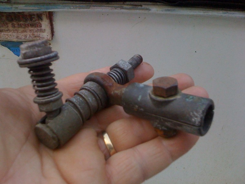

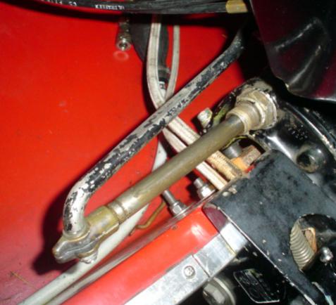

        Attaching the cable's active end to the motor's steering bracket can be accomplished either with "factory" hardware like Helmar showed you, which might be hard to find, or by a simple combination of a stainless bolt, nut, spacers and washers. The configuration of your motor's steering bracket was designed for a "quick disconnect" setup, in which a bracket was attached to either a push-pull cable or a cable / pulley system and was attached to the steering bracket by "push-in-and-turn" hardware (thus the shape of the hole in the steering bracket) The raised bosses on either side of the hole indexed the bracket in place.

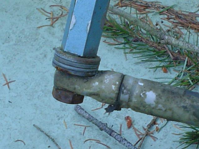

        Homelite 1 - A setup for attachment to a Homelite. You can see how the cable threads onto the "pipe", how the pipe is clamped into the clamp block and how the clamp block is mounted to the transom.
        Homelite 2 - The end of the steering cable. This style has a hole in the end which allows it to be bolted directly to the motor or to a gimbal bracket which is in turn bolted to the motor. This particular cable end does not need a gimbal bracket since the cable end itself swivels, you can see the greasy black line on the cable end where the end swivels. If the end of the cable does not have a built-in swivel, the gimbal bracket allows the motor to be tilted without twisting the cable too much. (In this photo the Homelite attachment bracket is still bolted to the cable end, you won't need this part.)
        Merc 1 - This shows the Merc setup, where the "pipe" that the cable sheath threads onto is integrated into the motor's transom clamp assembly rather than being a separate piece. I included this only so the next photo wouldn't be confusing.
        Merc 2 - This shows the style of cable end that does not have a hole for a bolt, nor does the end of the cable swivel like the Homelite setup above. Instead, the end of the cable has a groove machined into it to accept the two piece clamp shown, the clamp has an attachment hole and swivels around the end of the cable. (This photo also shows the link rod between the cable end clamp and the motor, you won't need this part for your setup) The gimbal bracket that Helmar showed you is made for this type of cable end, in his photo you can clearly see the two piece cable end clamp.

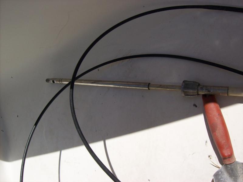

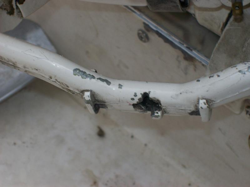

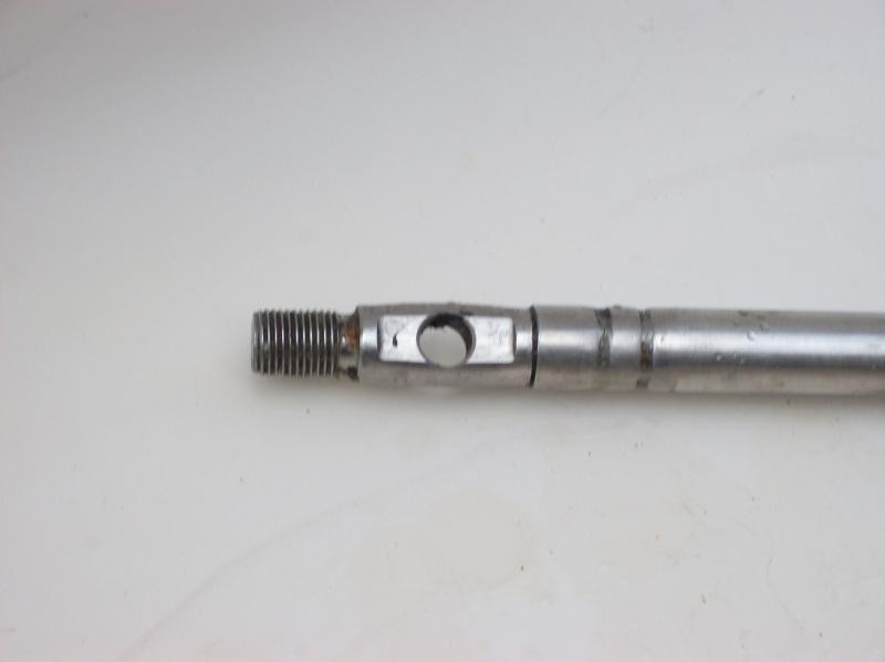

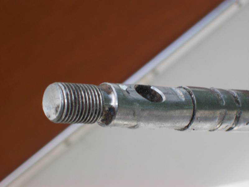

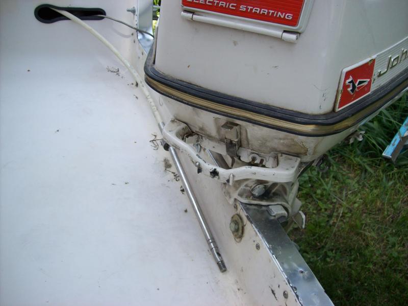

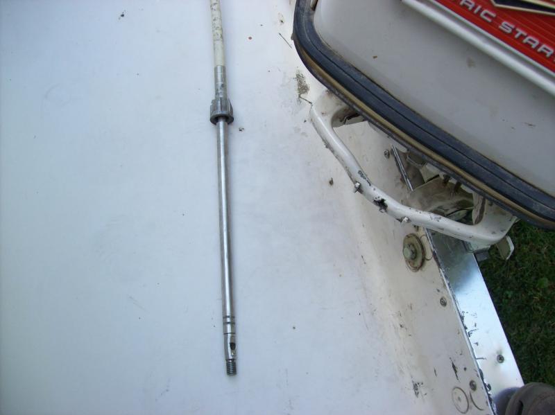

            I'm attaching a couple more photos of the cable end and one more of the engine steering bracket.
            Thanks again, Charlie McCrum
              Oops. Here's one more I meant to attach.

                Charlie,
                A few questions:
                1) Does the end of your cable swivel? (If you put a screwdriver in the hole in the cable end, can you get a little twisting movement out of it without the crimped area of the cable end moving also?)
                2) What is the diameter of the hole in the cable end?
                3) What size is the threaded end of the cable? (3/8 x 24, 1/2 x 20, etc.)
                4) How long is the threaded portion of the cable end?
                5) How far above the top of the transom is the hole in the steering bracket?
                Thanks,
                  Hello Tim, and happy 4th!
                  Hopefully you're out in this gorgeous weather somewhere in a boat.
                  I'll answer your questions in order here.
                  The cable does swivel freely. However not at the point where it is crimped right behind the hole and threads at the end. Instead, if you grasp the cable back where the pipe thread cap screws onto the length of pipe you have referred to (see attached photo where the red garden tool handle is positioned on the cable) then the inner cable rotates very freely independent of the outer cable jacket.
                  The diameter hole just behind the threads at the cable end is 3/8".
                  The thread size on the cable end is 1/2 x 20.
                  Then the threaded portion of the cable tail end is 5/8" long with another 1/8" or so of groove behind that.
                  From the top of the transom to the center of the engine steering bracket hole is 3 3/4".

                    Thanks for the additional info, I'll dig around in the shop and see what I have that might work. One more question: Due to the height of the steering bracket from the transom top edge, it might be a good idea to use the clamp block to raise the cable up so that the action of the cable is closer to horizontal. I did that with the Homelite installation on the Sabrecraft and it really made a difference in the feel of the steering. I'm not using that setup any more so I don't need the mounting plate I made for it.

                      Yes, with the hole in the cable end bolted to the hole in the center of the engine steering bracket, there is enough room in the splashwell and play in the cable to bring the moving end of the cable (back to the threaded collar on the end of the sheathed cable) up to a position that is parallel with the top of the transom. In other words, to a true horizontal position. Obviously, there must be some sort of ball joint type fitting where the cable assembly joins the motor bracket in order to allow for continuous steering as the motor bracket swings in an arc from side to side as it is steered.
