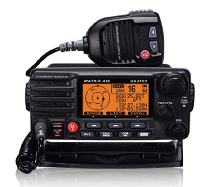

    Just so everyone knows, this is my Next radio that I will purchase.
    Several manufactures have already released them (Icom, Standard) and its what is called AIS which is, Automatic Identification System.
    This system is in most larger ships now !! and due to the lower costs, are being used by smaller vessels (me next).
    In a nut shell, any Vessel that has one of these, will be able to avoid collisions with other vessels.
    I really like my GPS as it will show me where I am, but not the other guy if its foggy.
    One thing that creeps me out is if I am crossing the shipping lane and all of a sudden, here comes the fog bank along with another boat that is using the fog horn, I can only Guess where they are. Makes the hair stand up on the back of my neck. (hebee gebee's)
    Being into Amateur radio (Ham) my first choice would be Icom, But, never had a problem with Standard Horizons products.
    Amazon has the Standard for $310.:Skipper1: This one looks like your basic simple to use (KISS) type radio, I like simple..
    Just go to Google and type in AIS VHF Marine Radios for more information.

        Yeah I bought a Standard Horizon with AIS for Solstice for the AIS feature alone (along with an 8' $200 antenna). Of course now I have to spend $2K for the GPS/Chartplotter/Sonar unit that can use the AIS function. Why didn't anybody tell me that boating was expensive? I particularly love the special expensive boating toilet paper! Even wiping your backside costs more...

            Some of the radios that you see now have this little Red cover over a button.
            You lift the Red cover and press the button and it will transmit your lat and long to a coast guard listening channel. (can't remember which one at the moment)
            How it gets its data is from the GPSMAP or GPS units that has the DSC capabilities (Digital Selective Calling).
            With that data, then it uses your VHF radio and antenna.
            The GPS, GPSMAP or Plotter normally has its own antenna. My Portable GPSMAP 76CS by Garmin which is a handheld, has the plug in the back were it can hook up to the radio for either DSC or the AIS.
            So, in short, the Radio is the one that does the Transmitting of the Location data - that it acquires from the GPS unit.
            Sounds confusing but that is about all it takes.
