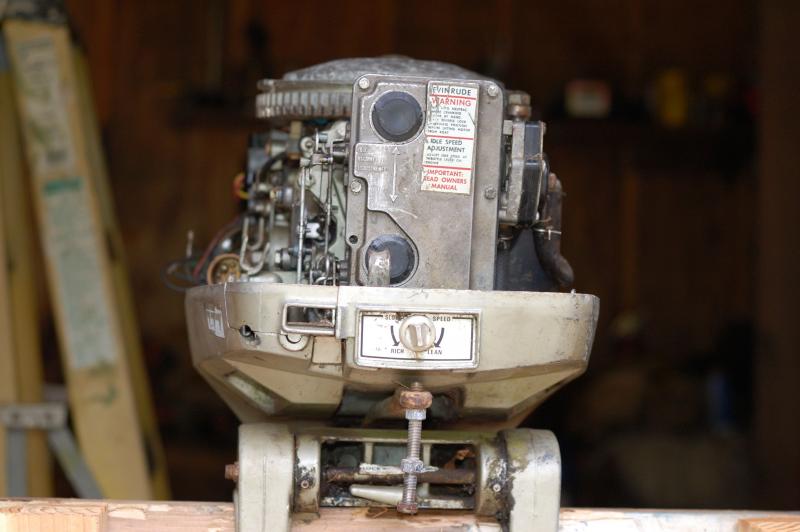

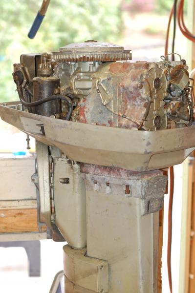

    I've got some tough rusted nuts and bolts I am trying to bust loose on a 71 Evinrude 50hp long shaft, and trying to bust loose the engine from the exhaust shaft with little positive results ----- Ideas?.
    This may be a losing deal for me.
    I really do not know how long this outboard has been sitting in the weather, but I have to guess it's been a long time.

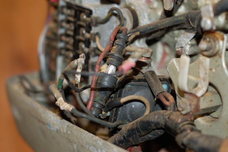

    Love the foil on what is likely a blown fuse in #3 photo.

          Nomad55 --- I thought someone would appreciate the foil, kind of reminds me of my youth and junk cars.

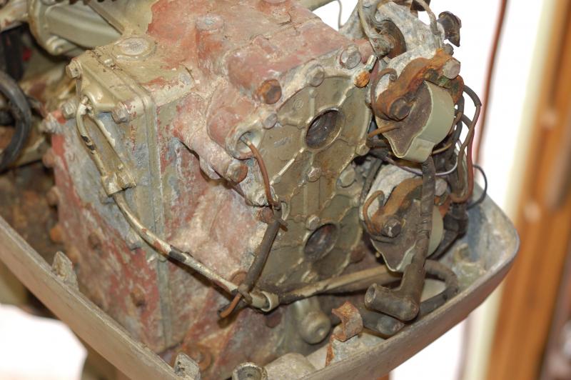

          One of the other issues I have is trying to get the engine case separated from the exhaust case. I've smacked it a few times with a drift and hammer but she just won't budge. Tried using a wood chisel between the the cases to see if that would split it but it still hangs on. Maybe a little heat would do it.
          I guess I might have to get real aggressive with it and give it the ole smack down.
            Turn it Over!
            Looks like a tough one,rusty bolts into the powerhead isn`t a good sign.
            Looks to have overheated good a few times,not much paint left on the Head seam.
            Time to turn it upside down and wait for gravity to help that penetrant.
            Use something thicker with the Aero-Kroil alternated.It is runny and the Tri-Flow or Fluid-Film will corral it and keep it in the seam.Watch as you heat it and you`ll see rusty leach out of the bubbling gap.
            Heat the block,cool the bolt with spray.....repeat as needed ,with a break or breaks as you are patient.
            Also get the lower unit shaft moving south before moving to the powerhead seam.....you`ll need all bolts freed before that one will come apart.
            Once you turn those until loose , lay it on it`s side so the weight of the powerhead is now going to help.
            A prybar at the rear and another under the intake can be pried on and a quick yank on both will usually break that gasket seam,though if prying ,I`m doing it upright and on the stand or boat.
            You`ll need to roll that block around as you heat and turn those head bolts if you are to save this engine......gasket wil be cooked by the time you get there if not already.

                        Ok I gave up ----- after 5 days trying to get the head off (first -- with penetrating oils and heat ---- then using the hammer and wedges) I have thrown in the towel and and called it a lost cause. I did get the head off but the damage to the block was server. To bad because the piston sleeves where nice and smooth.
