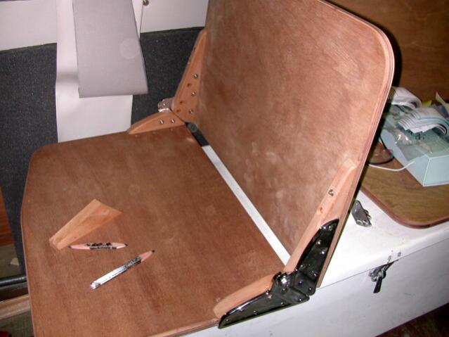

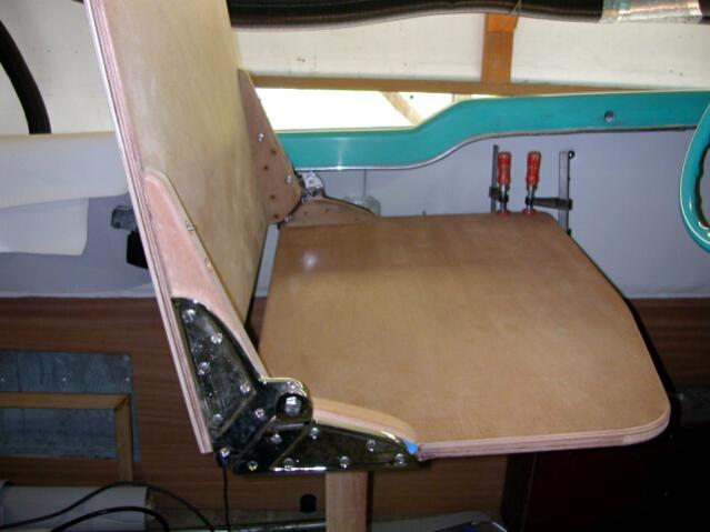

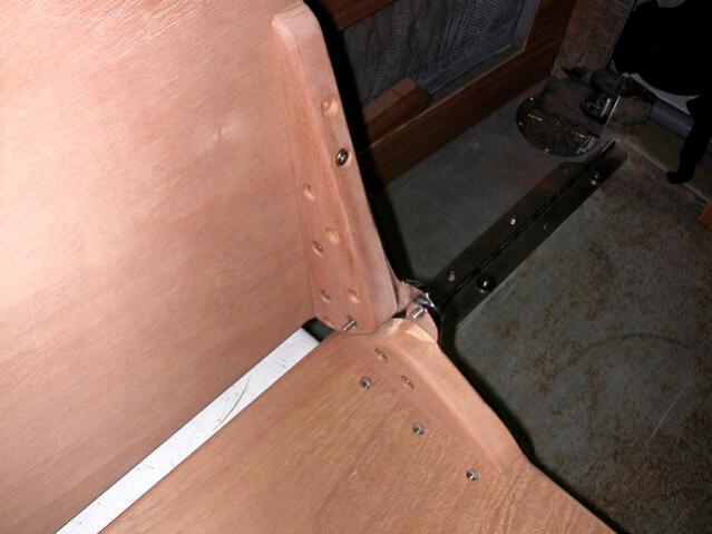

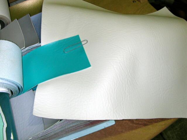

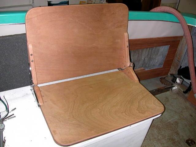

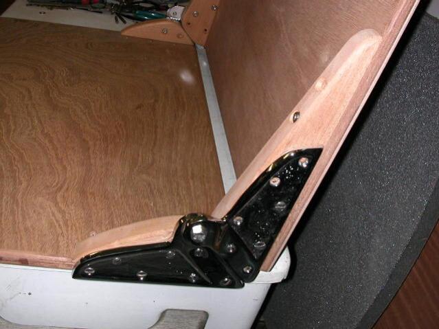

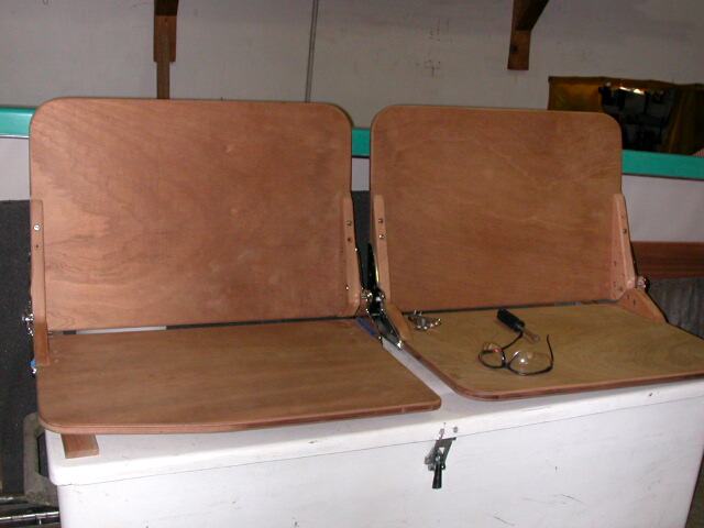

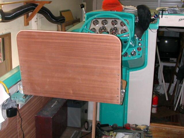

Spent the better part of the week building the new helm seats for the Saratogan. Will stain them tomorrow. Still have to come up with the hinges that attached to the cockpit sides and the vertical supports. The cut out on the skippers seat is to clear the steering wheel. Made the plywood by laminating some Bruynzeel. Teal and cream vinyl will be cut similar to mid-50's car seats.
