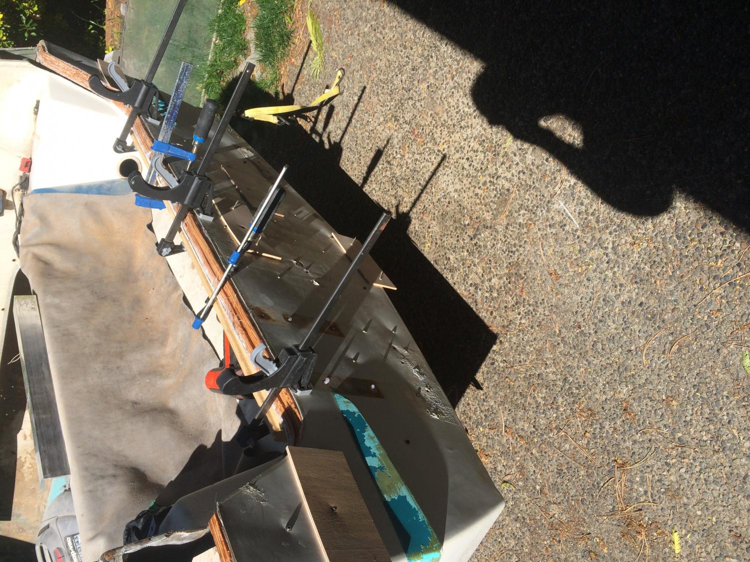

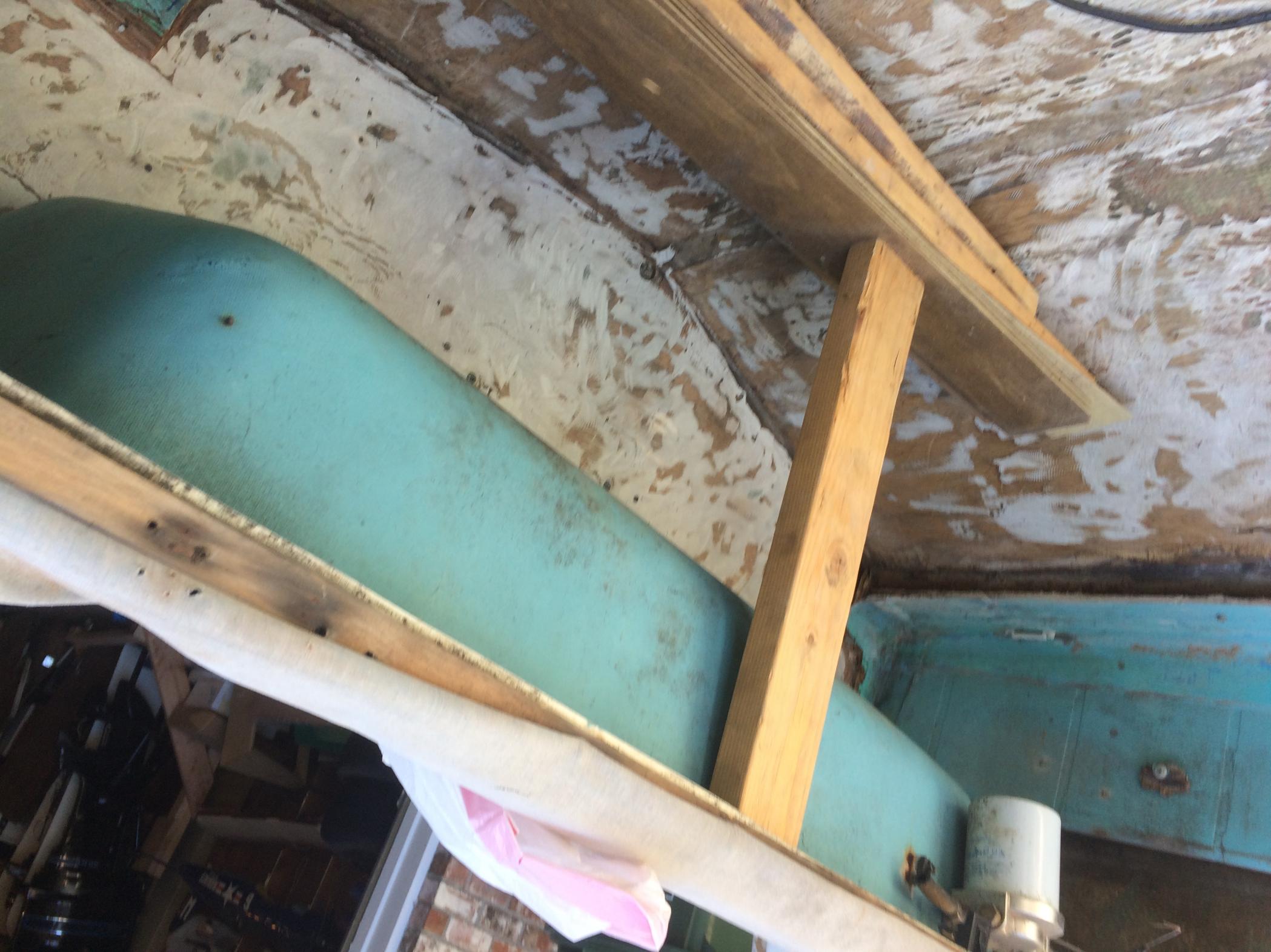

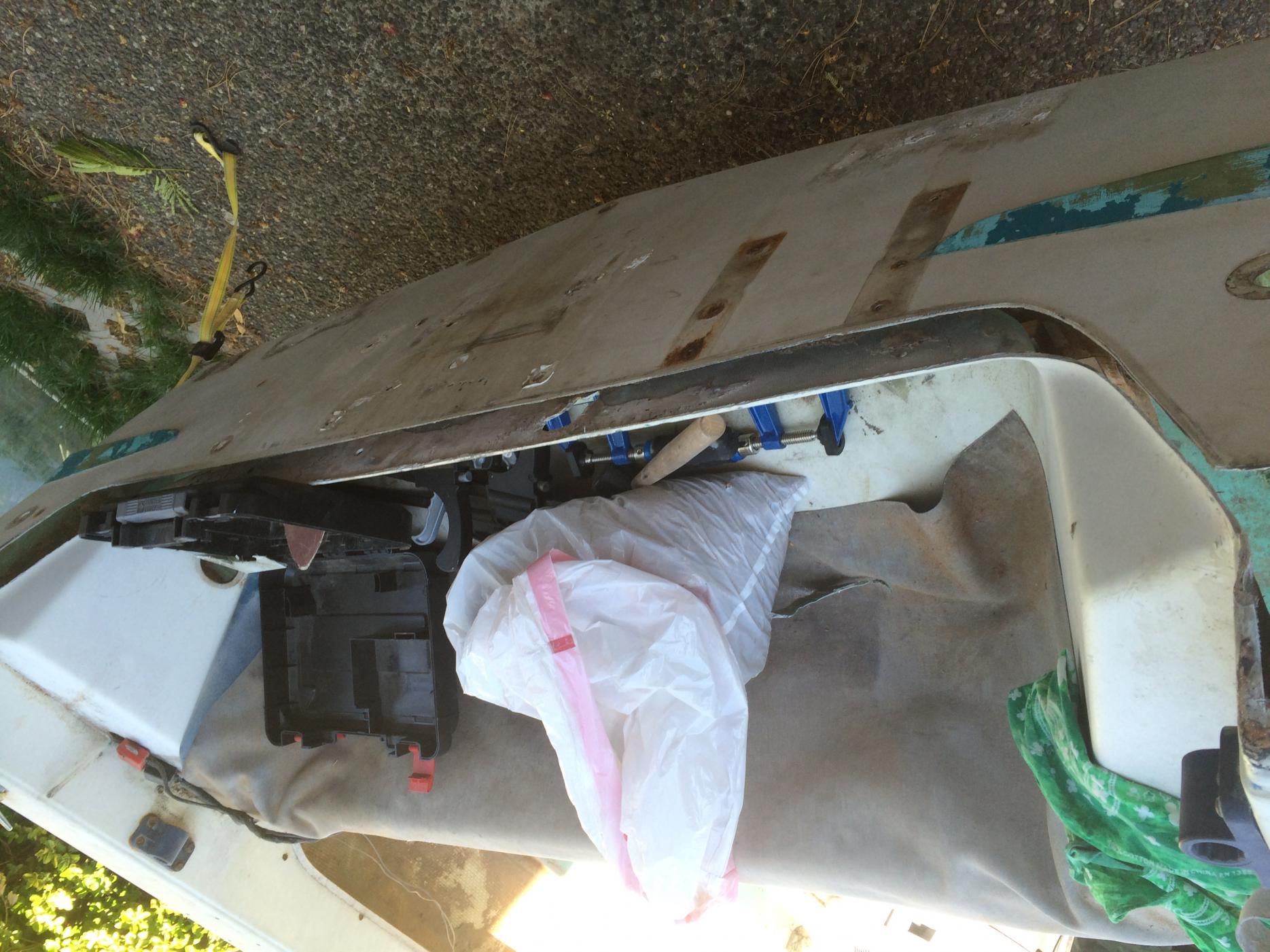

        So far I got a lot gutted out of the boat and now its time to start thinking about building. Heres a quick video to show what I've done
        https://youtu.be/CNJ2sSxjZ3Y
          Good progress. Epoxy resin or fiberglass laminating resin. Once i get back home (East coast right now) i can show you another way to put the transom in if you like
            Epoxy sticks better the catch is you are going to need ten or fifteen gallons of resin and you cant use polyester over epoxy it wont stick. You don't need to add the cross braces. You are going to have to cut lip off where you pulled the old plywood out. There is no way to clamp it to the new floor and the new glass has to go all the way across the new floor. obviously the new transom goes in first. Consider using treated wood for new floor and stringers Let plywood weather on top side till it turns brown and checks trim and fit then saturate it with catlizied resin before glassing in. Spot repairs in gelcoat work fine. For a color change its just easier to paint.

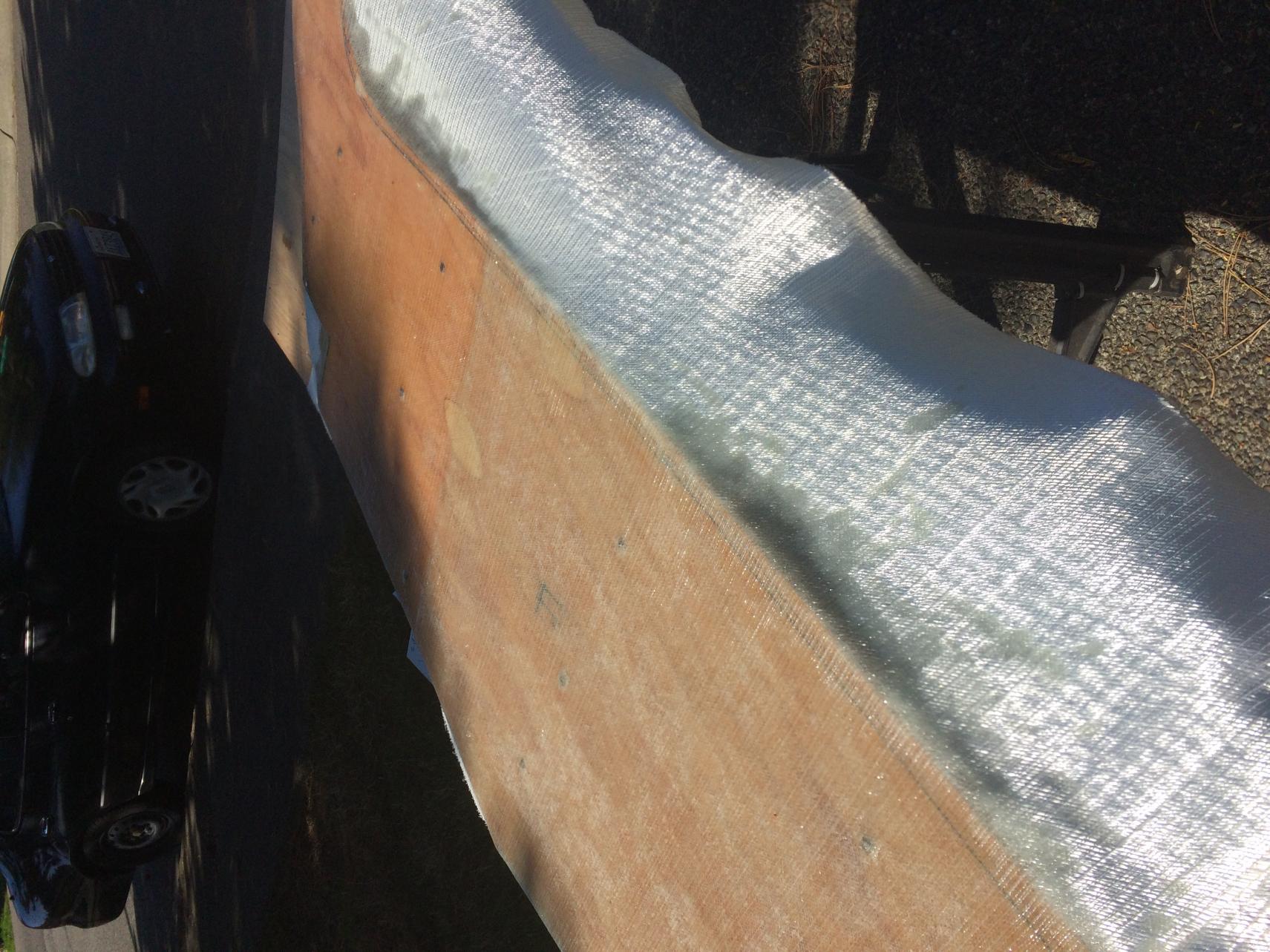

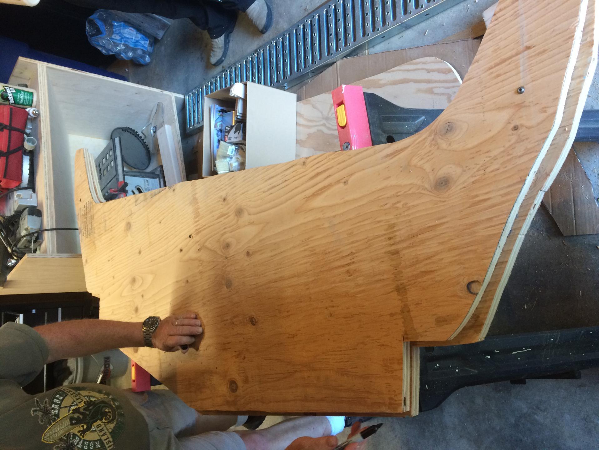

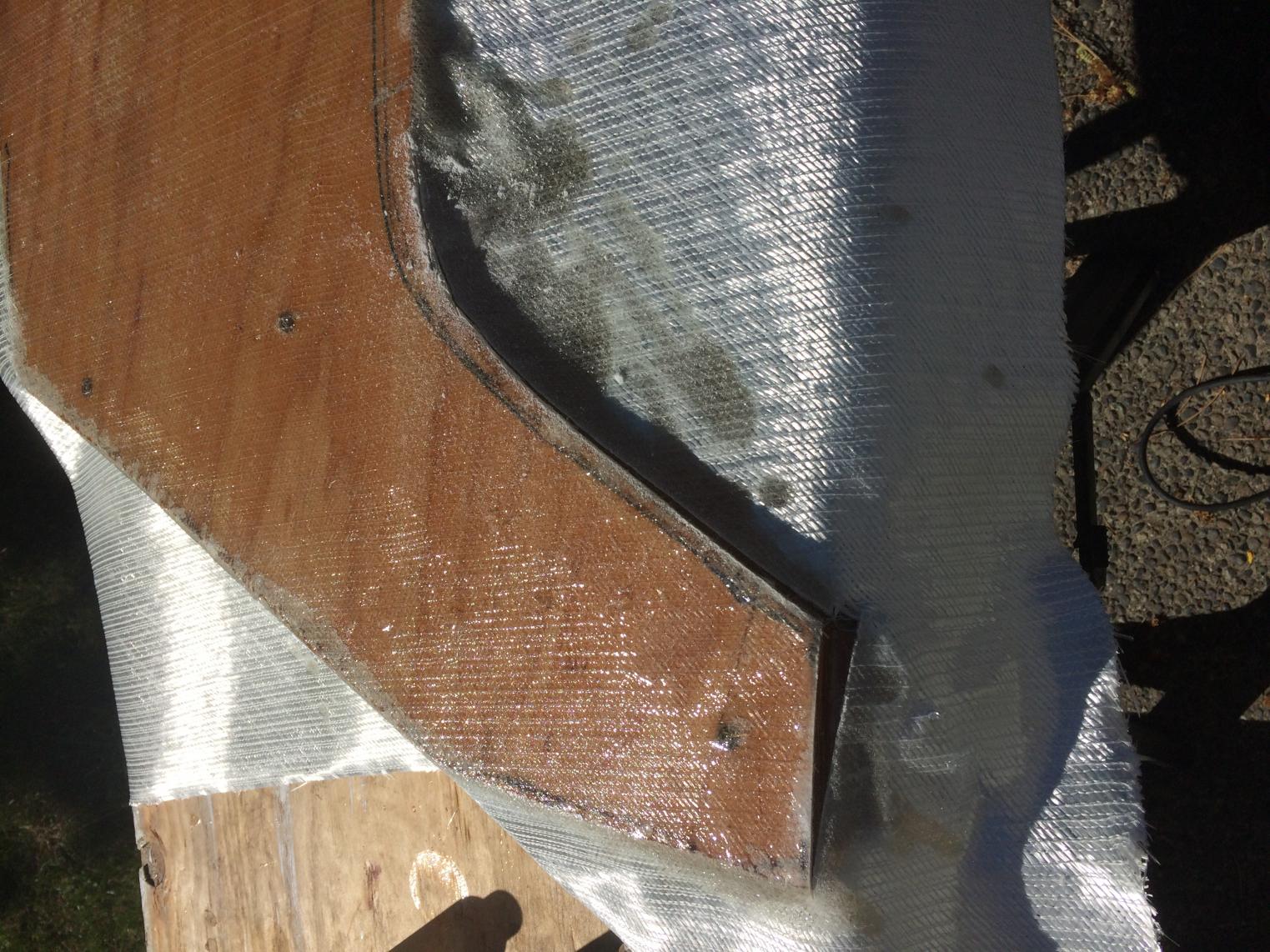

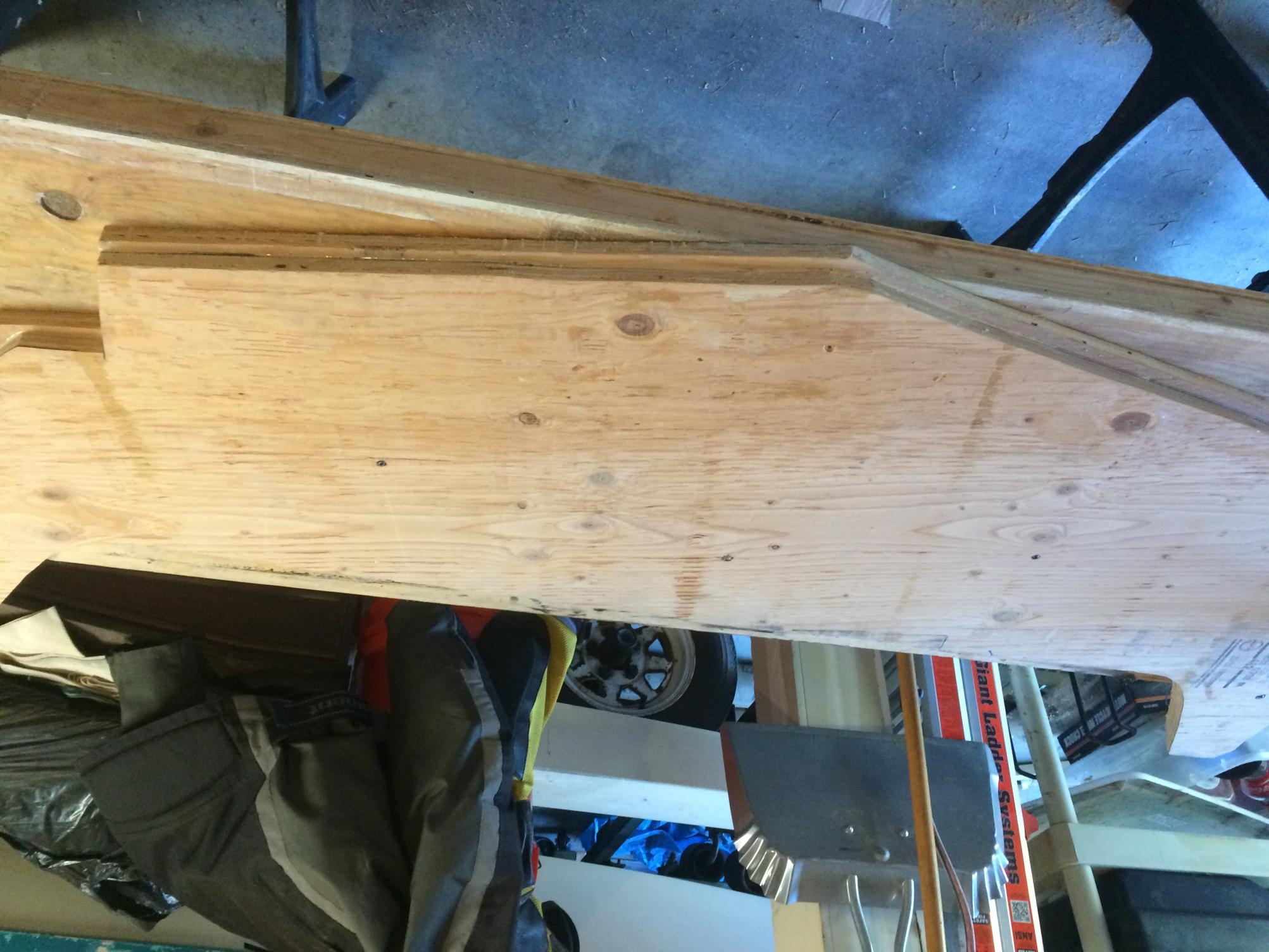

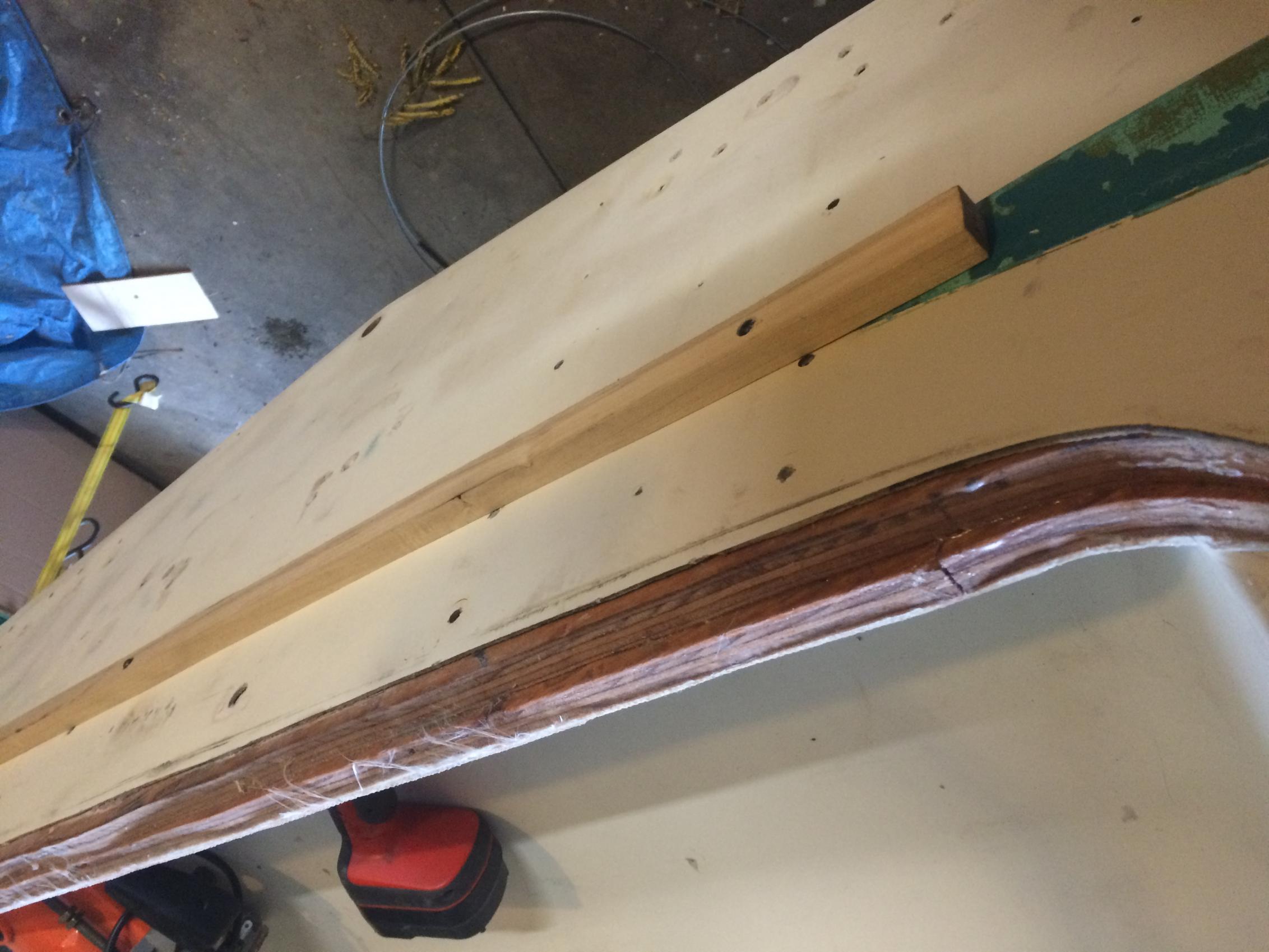

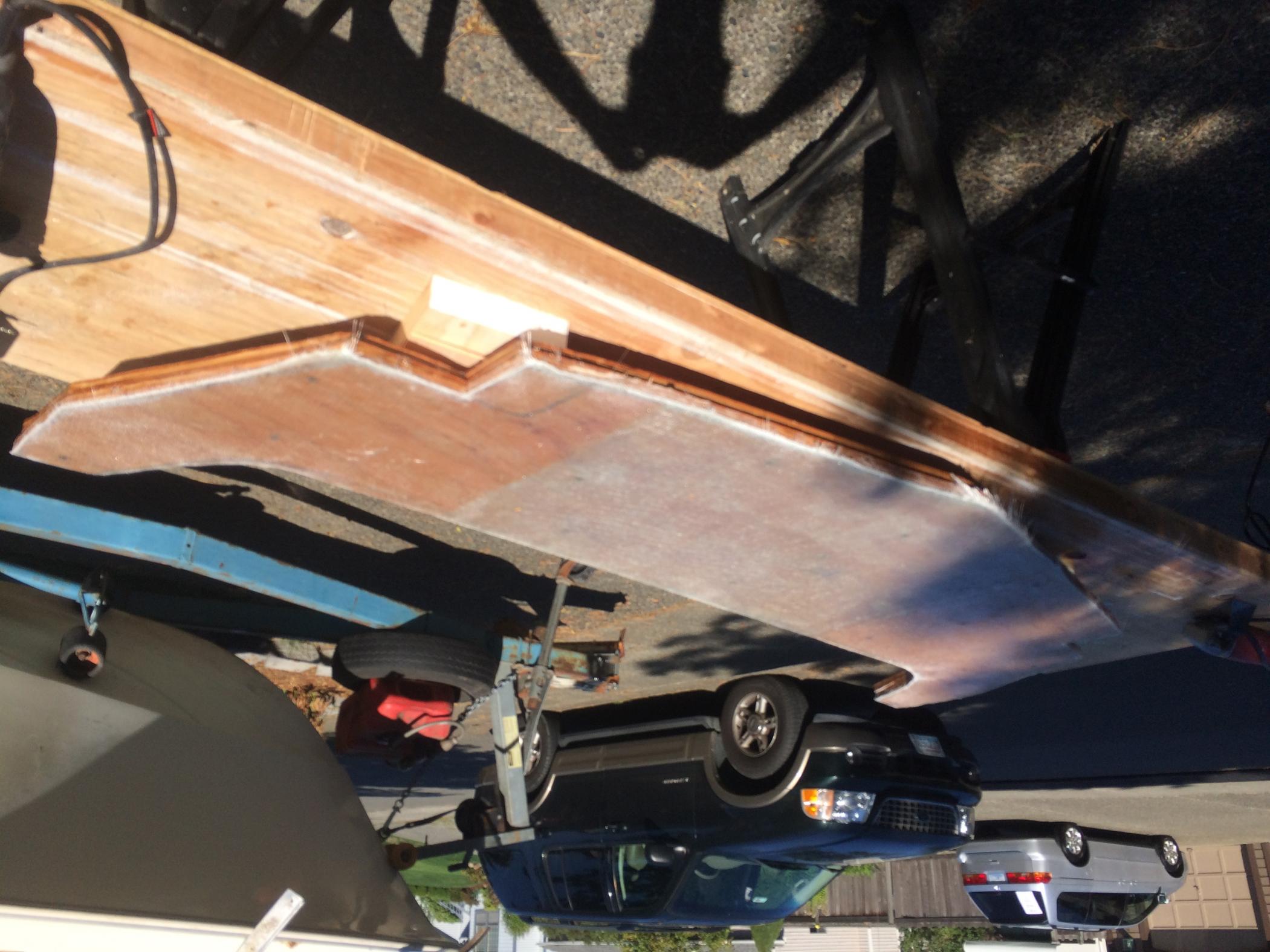

              Gluing in the Transom
              So I started gluing in the transom this weekend!
              -Pieces were cut from a cardboard template and traced on the plywood
              -two pieces of ply were glued together with water proof wood glue then screwed together
              -all sides have a coat of fiberlay p17 resin with the front having a combination mesh/fiber mat fiberglass
              In the mean time the boat had been gutted / prepped and dried in the hot weather

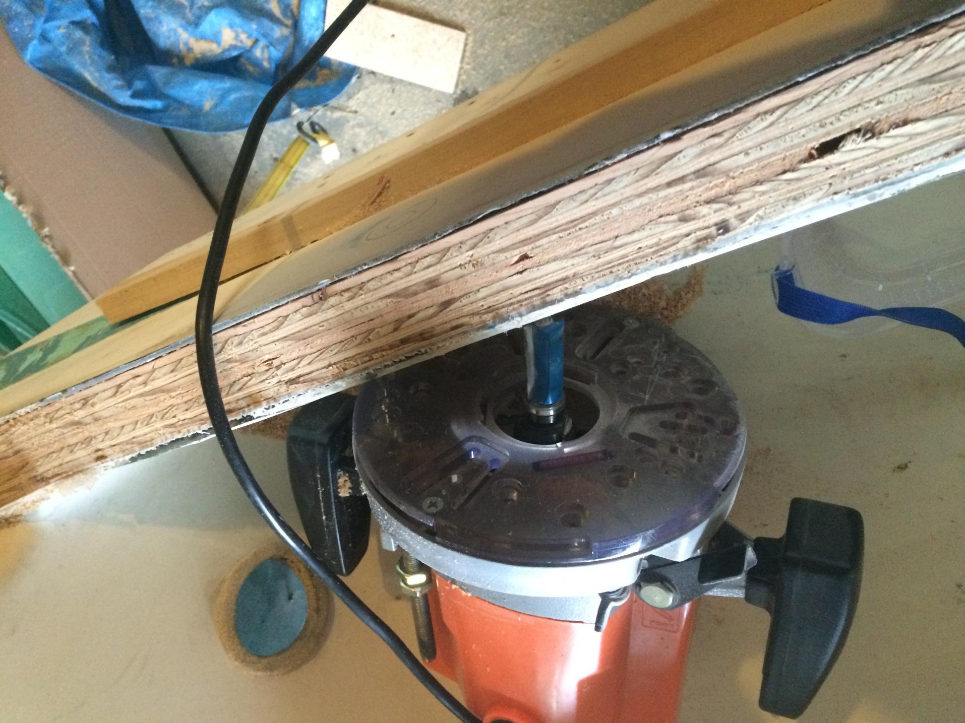

              The idea was to use the fiberlay/ stand pre mix as the glue between the transom and the boat. So I applied that to the inside of the boat and slid the transom in from the top. Once that was in we clamped and screwed the wood to the fiberglass
              I left the top a little long so I could flush trim it with a router
              Things left to do:
              -fiberglass and trim the top cap after the router
              -finish peanut buttering the cracks of the transom in the inside
              -peanut butter all the holes on the outside
