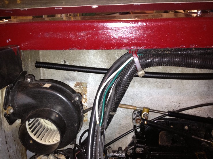

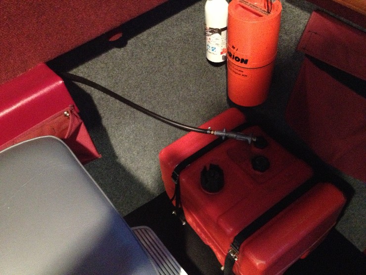

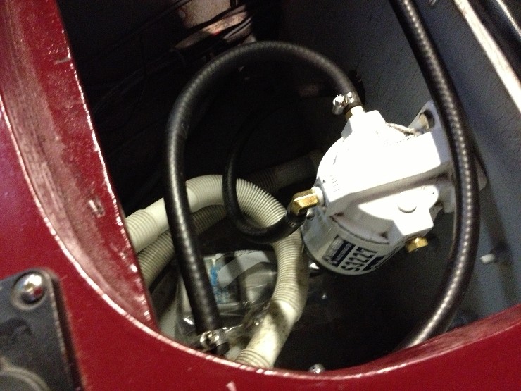

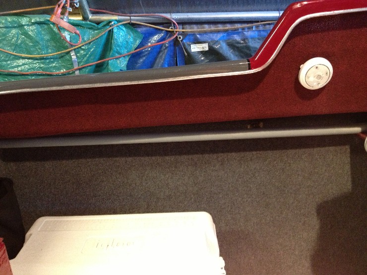

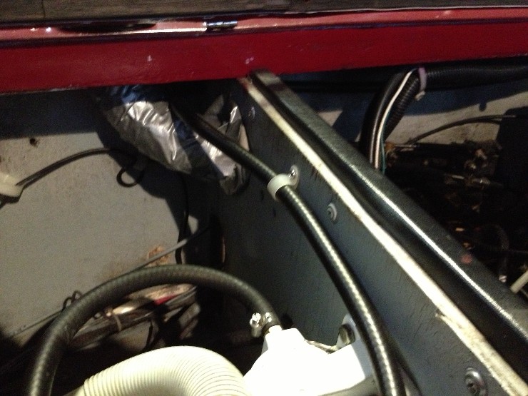

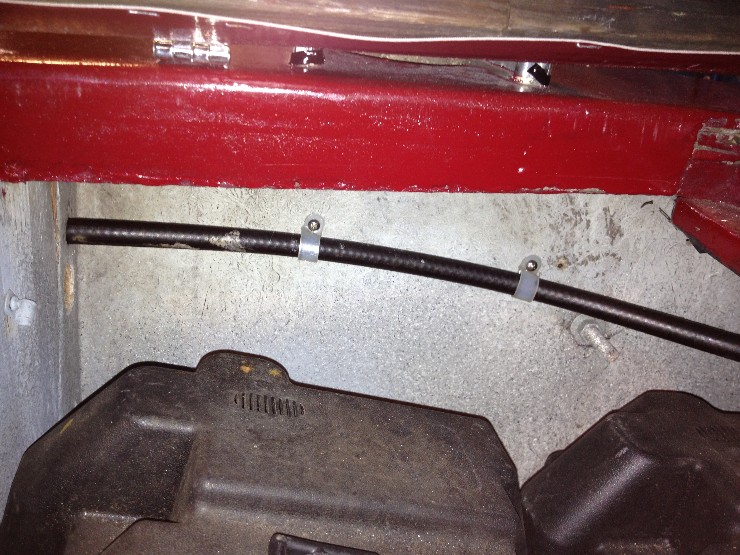

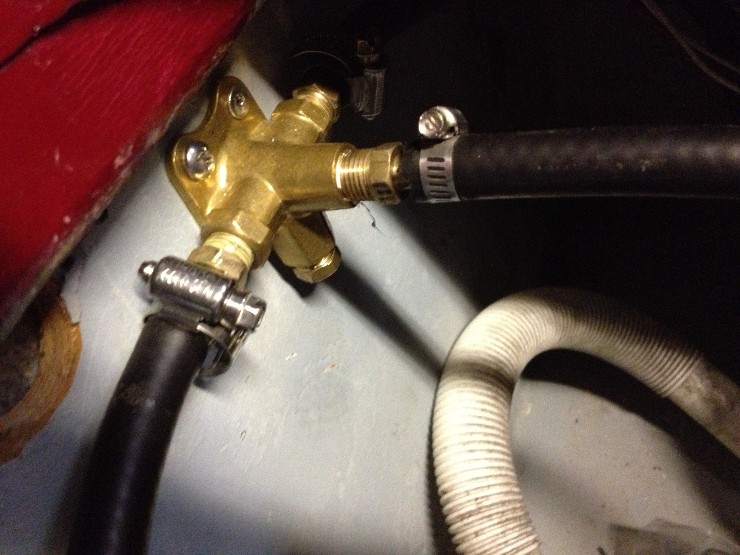

                    Here's some pictures of my fuel lines going back to the fuel switch and on to the fuel / water separator unit and then to the motor. I have had this setup on about 5 boats and never a problem going kind of up hill to start with the fuel hose thru the pvc pipe back to the outboard motor or I/O .In this case it's going over to the starboard in the stern to hook up to the fuel switch and on to the motor.
