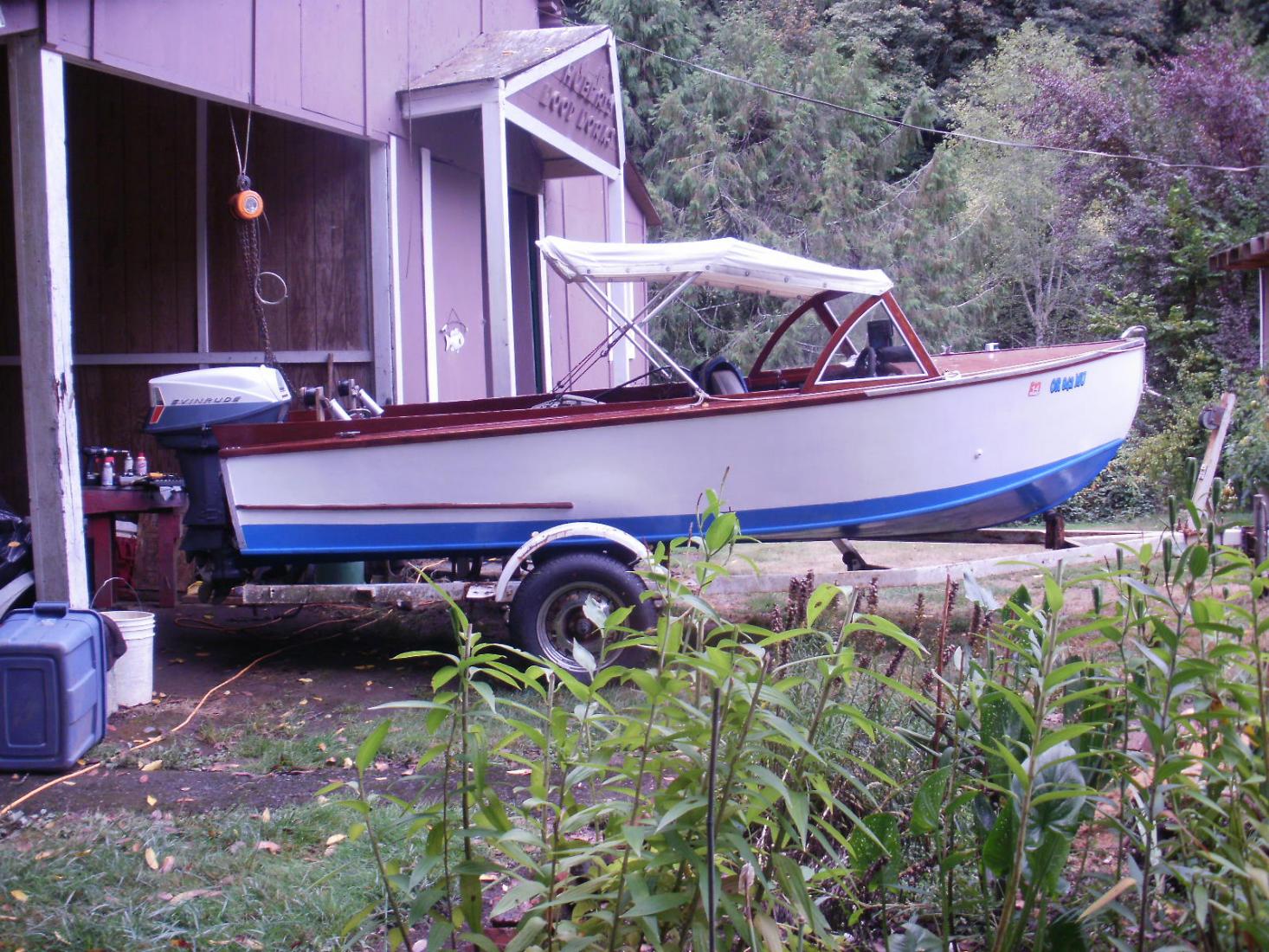

    I am restoring a 1959 Isham woodie. I have found virtually nothing about these boats but know they were built near Portland, Oregon. Mine is 16 ft, powered with a 1962 40hp erude. going to a Bearcat this coming summer and salmon season. Has a helm and passenger seat forward and a bench seat midships or so. dont know if the bench seat was added or the configuration of the forward seats. slight leak when launched (about a quart or two for four hours in the water). Any suggestions for sealing the keel? Sikaflex too extreme? Boat is trailered and seldom in water overnight. Thanks in advance for the help. Mike

      If you know where the leak is along the keel, just get everything dried out and apply a bead of 3M 5200. Sikaflex is okay, but 5200 will bond to anything and maybe give you a longer-lasting seal again leakage.
        Thanks Marty. 5200 it is!! Boat presently in dry storage and seams gunked out. Will get the 5200 and let it sit for a couple of weeks and repaint the keel and bottom. Boat is in excellent shape and I will repower with a Bearcat this summer. The 40 erude is not very fuel efficient and the boat is a working fishing and crabbing boat. Thanks again for the help. mike
          5200 it is. interested in any info if you dig some up. beautiful and hardy working boat. sides are 3/8 ply and bottom 5/8. still solid throughout. thanks for the tip. mike
