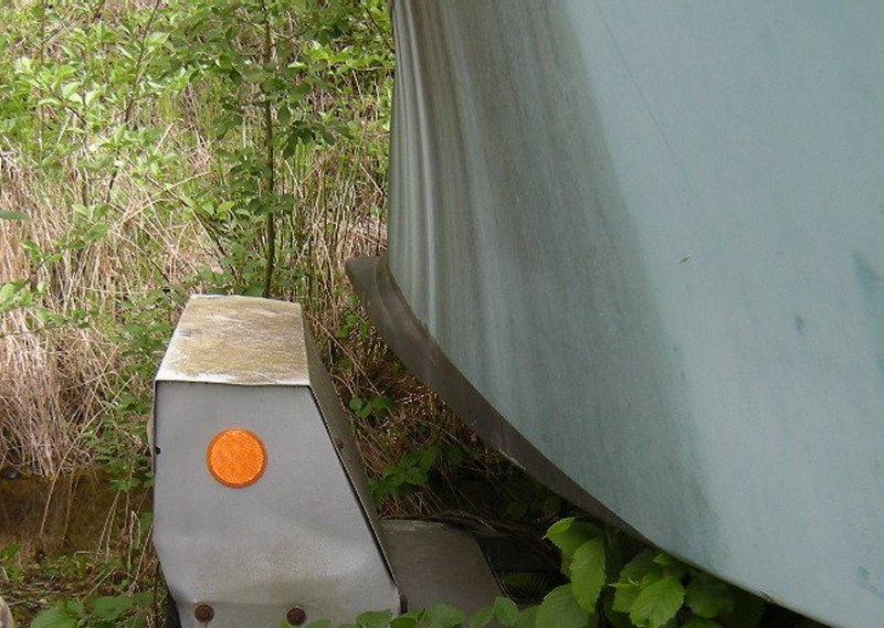

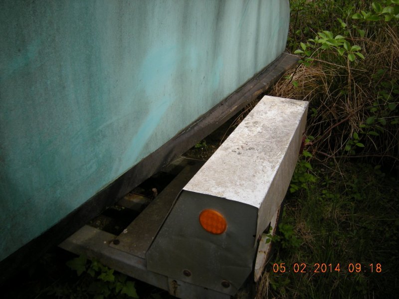

                Anyway, I have this one 17 foot Skagit that is now setting at John Nelson's place that needs Everything done to it. I mean glass and all the wood.
                That boat had a 4 cylinder chevy with a OMC outdrive. I mean Big hole in the transom. It had a modification on the sides of it that looked just like what George designed on his Bartender boats so I had asked him, what those were for ??
                He said it helped to bring her up on plane faster but also stopped the porpoising ???
                Putting 100 plus horse power in the back of a 17 skagit will not take much to push her up on plane and thats for damn sure.
                So, makes me wonder, did this fellow put those on the chine edges for porpoising or ???
                Lets see if I can find a picture of that skagit.
                I just don't remember how far forward it came. Seemed to me it was about 4 plus inches at the rear and came up about 5 feet to a point and blended into the chine edge. It was at a angle too.
                Just don't have any other picture of it and the boat is up in Darrington Washington up from that Oso major mud slide area.
                I tried to give it away but had no takers back then. Now that is safe and sound, who knows what I might do with it.

                      Like that skagit 17 I have with those glassed trim or whatever boards down the side at the same angle that Georges Bartenders had. With that horse power, you would not have Any problem blasting up on plane, so, why were they there ???

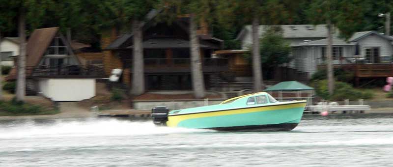

                        Bill Roberts' '56 Tyee with 150hp Merc (375lbs dry), doing 40+mph nicely. Same 20' Skagit hull, laser-true planing surface, different weight distribution + foamed hull.
                        http://www.duckworksmagazine.com/07/...t/image029.jpg
