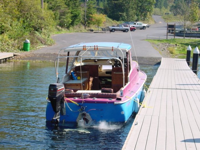

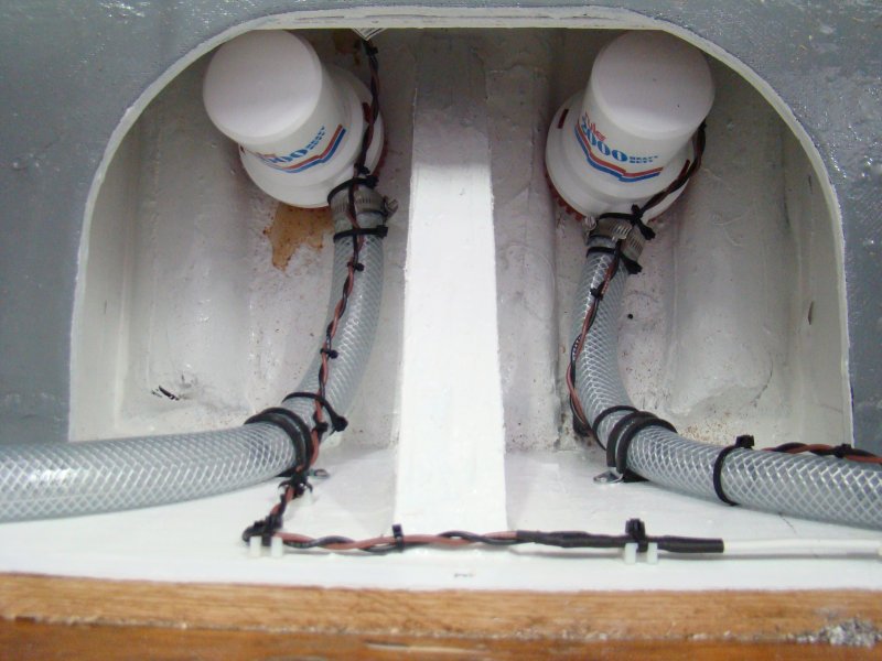

        One of the bad things about the older boats is that Large Bucket engine well. I plan on putting 4 drains into the 21 ft Bell Boy as she will be out in the ocean. I was also able to narrow that up so she holds less water but kind of hard to do with a fiberglass bucket.
        I also put in twin big pumps in case he takes one over the back and it makes it way to the cockpit. (might have a picture of that to share)

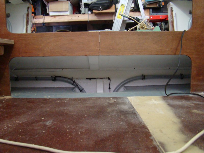

              Our Skagit's extension eliminates the transom cut-out and splashwell completely, so we gained some extra cockpit space and 13" freeboard aft, besides a considerable amount of aft floatation. A bulkhead 4" in front of the old transom and extra framing/deck reinforcement provides the hull stability of the old splashwell bulkhead. The hole through the transom for the engine connections will be virtually water-tight.
