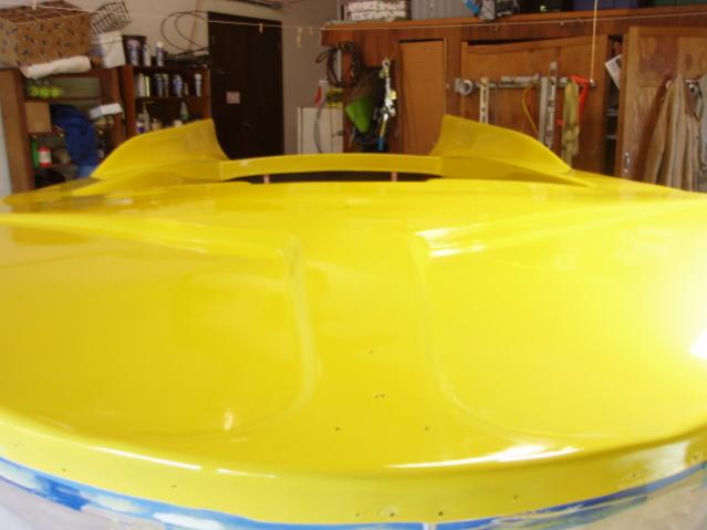

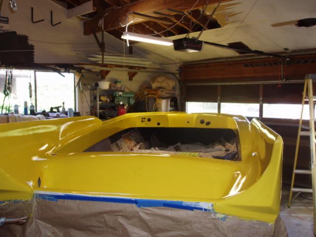

    I just finished my first coat of top paint on my 59 Glasscraft Imperial. (This is a big boat!) After my disappointing attempt at using Top Secret Coatings with the original Tahiti Coral color, I choose to go back to a brand that I had success with on my 64 Johnson. Since Glasscraft also had a yellow in their sales brochure, I decided upon using Interlux Brightside. I sure does go on smooth.
    I do have a question for anyone...since this is such a large boat, it takes awhile for me to work my way all the way around the boat. By the time I get back to the starting point, the beginning edge is setting up. How can I keep that edge smooth or at least soften it up? I haven't tried it yet, but I was thinking of using the brushing fluid to ease into the edge?
