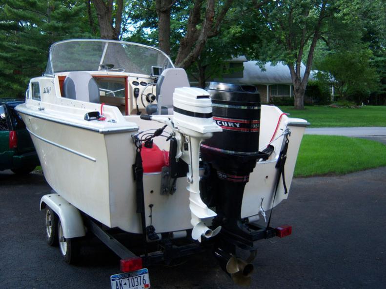

                      I have the 19' Bellboy Express and it came in 1960 with a Merc 800 (80 hp) "dock-wrecker". It then went to a Merc 850 from 1964 and that pushed it at 31 mph. It now has the Merc 1350 (135 hp) from 1970 and I am just under 40 mph with that one turning a 13x15 three-blade prop. It was overpowered because my dad wanted to pull up all three of his sons at the same time on single skis from a deep water start. He did!!! over-powered, of course but it is a 2 cycle and not too tough on gas economy (6 gollons / hr at cruise )
                      My kicker is the Merc 110 (9.8 hp) from 1962. This pushes the BB at 5 mph in calm water.
                        Bob, That is one clean looking BellBoy. Nice job. When you went through the transom to run your transducer wire how did you seal her up? - Ross
