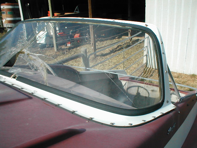

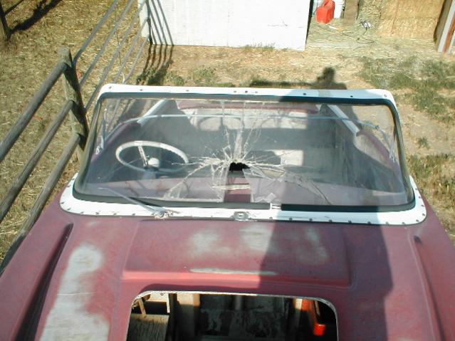

    I am getting closer to IDing the '57 Skagit 17 glass one piece windshield. The next question is who all would be interested. Price may vary depending on how many ordered.....................
    By measuring still in rubber seal I come up with around 17 1/4" tall in middle and 58 1/2" wide from lower corner to lower corner......................................

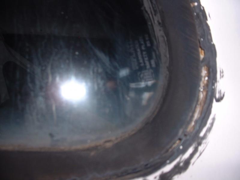

                Lon----- After washing it I was able to see the brand of the windshield on my 17. ---------------------------------------------------------------------- ---------------------- Shat-R-Proof
                --------Plate
                -- (R) 57 ASI (The R is actually circled)

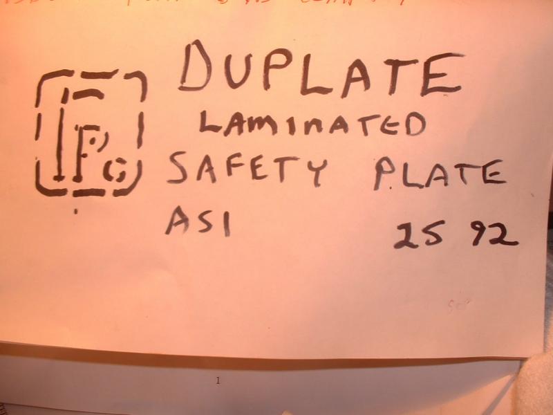

                    On the port bottom side of my windshield is a signiture. PPG is the company. I googled ppg duplate 1955 and came up with lots of information. They said first # is month second # year. I have 2 sets of # so mine is either feb 1955 or sept 1952. Cool junk is a 1959? 20'. In reading the history of ppg they started building stuff out of fiberglass in 1952. Including supports, possibly the frames for the windshields?. I wonder if in the pictures of the factory in a corner someplace is a pile of windshield in frames that the simply attached to the deck. Here is bad picture of the signiture and a drawing of what is there. John
