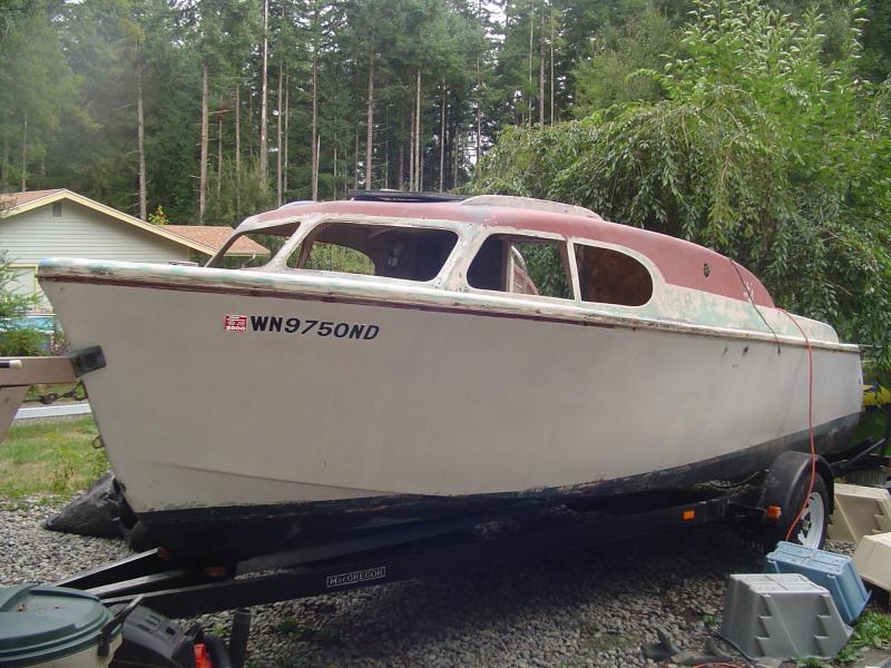

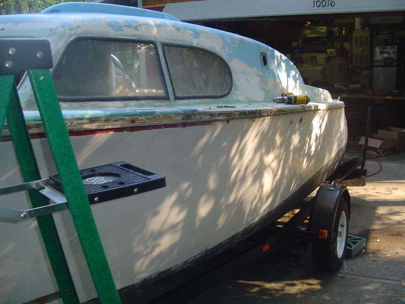

yeah thats what ive found getting down to original red gel, several colors and and a yellow what a presume an epoxy primer of some sort because my sander stalled at it and strippers were just scarred of it, in the end 60 grit sandpaper powere thru revealing the original red paint. this is the skagit chinnook we purchased from marty with the inboard, the top is all stripped , hull is next , while repairs are being dont to the top , how many holes can you really put in the topside anyhow? more posts as work is completed...
blue,blue,green, and somthin really hard!

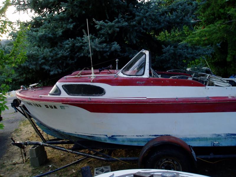

Is this the one with the little volvo IO on it and a Large prop ??

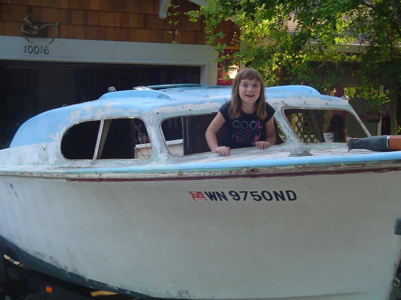

Getting her down to the good stuff now
yes it has the volvo i/0

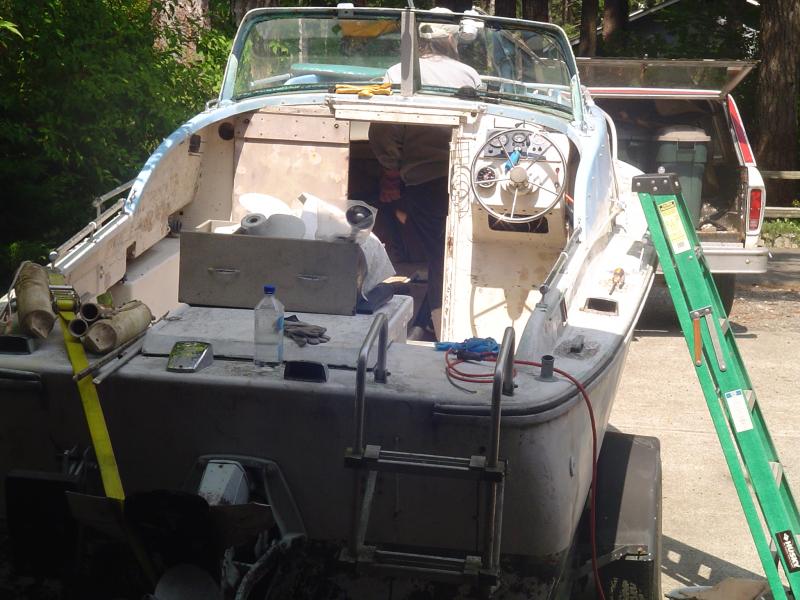

yes it has the inboard, it isnt siezed, which means i will get it to run, and what ive learned so far is that it from the mid to late 70's and is fairly bulletproof, but im told major repairs are quite costly, not concerned about it right now, that a project for a cold winter afternoon when im warming myself by the warmth of fiberglass setting up. also if anyone needs any info on the upper windshield i have both the frame and the glass seperated and both are intact, if anyone needed measurments. this boat is a 55 chinook, and youve peaked my interest...what is this soda blasting and why have you kept it from me!!!Attached Files

The starter is stuck, remove the starter and lube it up and it might just turn again.
That was running when it was parked so it can't me much wrong with it.
Those Volvos (that one has been Upgraded for the boat) are Bullet proof.
Make it run and you will be surprised how much fuel it does Not use.

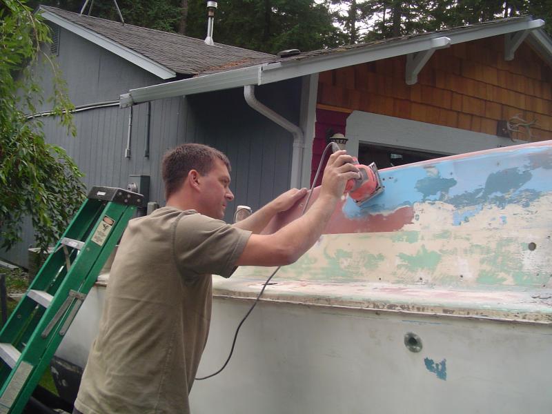

YesOriginally posted by johns59skagit, post: 7125just canned the second sander... on the 3rd 40$ sander.. are more expensive sanders more durable? i still have the entire hull to do....
We have a Porter Cable that is still working but the one that really takes a beating from all of us is the Festool. Major pricey for you do it your selfer.
Ryobi used to make a good one but I would be willing to bet that your going to get what you pay for in sanders.
I had a few of those Home Depot sanders and would do the same thing, run it into the ground and take it back broken.
I think most of that stuff is for weekend warriors, but, if they are dumb enough to keep replacing it for me, OK by me
I am still looking for the Festool Clone if I can find one.
I will be interested in what you end up with and how you like it.Helmar Joe Johanesen
