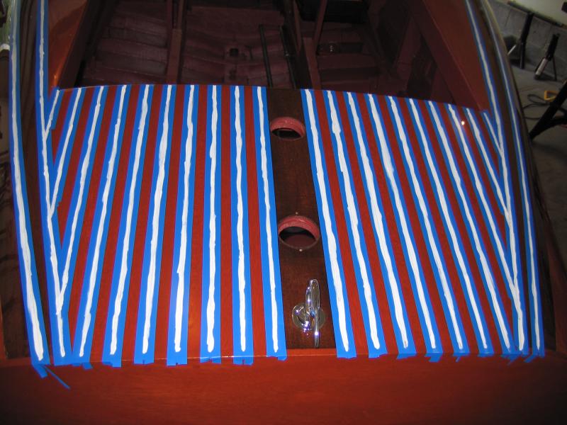

    Interesting tool. If you can't find one, you could always mask off each section. A pain for sure but would probably get the job done. Or you could just lay it in by hand and keep a dish of water and some paper towels handy for wiping of excess.

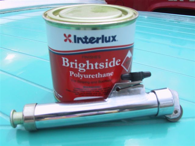

      It is a common pinstripping tool used in pin stripping cars. Clint
        Yes it's a pinstriping tool. But I can't see paying a $100 for one when its only going to be used once. If I can't get one of these. I can get a pinstrping brush and do it by hand.
        Mike aka pathfinderz1

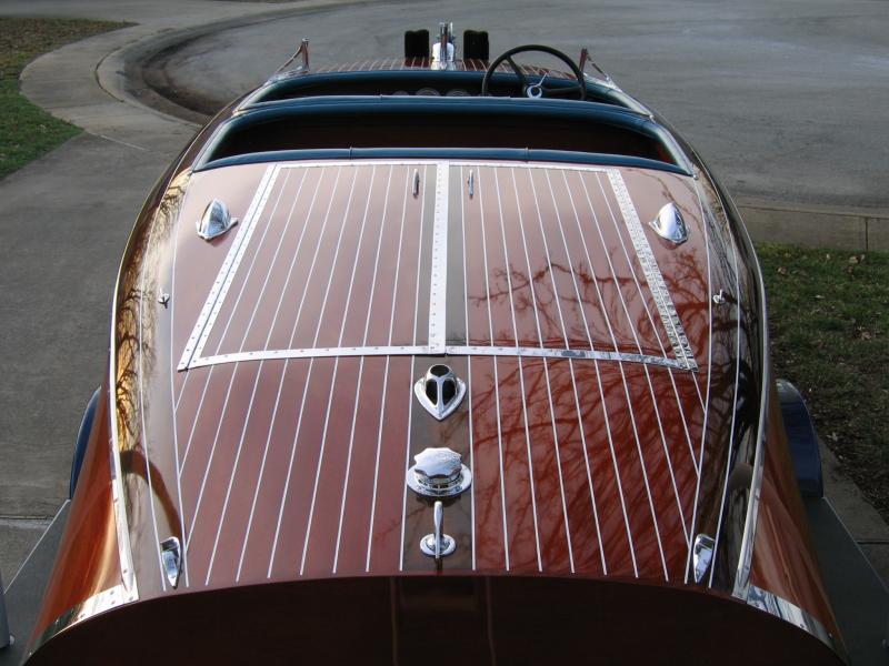

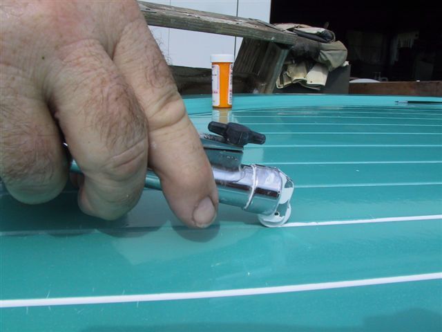

          These Beugler pinstriping tools are commonly used by the wooden boat restoration guys. Beugler also made specific tool wheels for Chris-Craft in the 1930's to 1950's for painting (striping) the wooden deck seams. However, there are also some restoration guys that prefer to use the masking method to achieve that perfect / sharp pin stripe.
          [ATTACH]4015.vB[/ATTACH]
          [ATTACH]4016.vB[/ATTACH]
