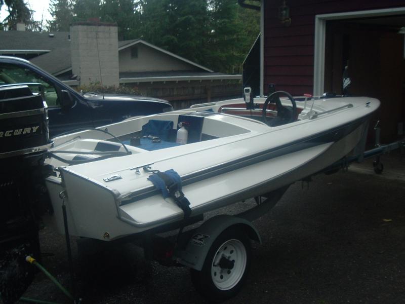

After mowing the lawn ( yes Yardman, i always like the lines the mower leaves on the grass. It's a Felix thing. ) for the last time this year, i push "California Girl" out of the garage and put some Sta Bil in the tank and then started her up with only two cranks of the motor. Last time she was out was Mason Lake. Maybe the weather will get better sometime this winter to take her out on a Sunday or whatever. All of you have a Nice Thanksgiving ! Chuck & Sheila
She still runs !

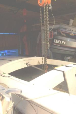

You called me up right as I was rolling my G-3 top shell on a Rotisserie.
I fashioned it up with a Hoist and pc of Alum Pipe stuck thru an existing hole in the dash center.I then C-clamped a board with another hole to the centerdeck and it was almost perfectly balanced once hoisted up slightly.
Of course I mis-calculated the room needed to flip over so it took some careful lowering of the hull bottom to clear my garage Door opener......oops.
The newly Epoxied top shell is not creaking or making any noise when crawled over ,so all that re-inforcing and Glass tabbing has paid off.
Now to power it up......maybe a 55 hp Yamaha for starters,then an 85 hp V-4 to check weight balance.
The goal is to work up to a 100-135 hp OMC , I`ll be labeling the "Mercbuster" if all goes well.
Now working on the Splashwell and trim as I now have a 21`` transom but actually lowered the old well so the lower motor bolts don`t conflict with the bottom corner AND allowing for a steering cable to route thru an enlargened cable pulley hole I`ve abandoned.

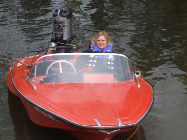

Tim,
"Mercbuster"? That's the kind of motivation I need to get my g3 repowered. Funny thing is that mine was made into a long shaft transom, and I want to cut it down to a short! It's on my list this winter. Jerry e-mailed me as well, and if he can put something together I told him I'd do my best to make it. If we could combine it with a NWCBC lake event, even better!
