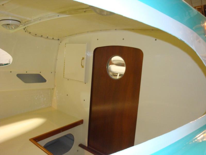

            Hi Marty - I just took a minute to check out your website and it looks like you did an incredible restoration on a boat just like this - wow! In the cabin it looks like there is no porta-potty or sink is that because you decided to remove them entirely in favour of more room for lounging or is it because the boat did not have those features originally. I'm just dying of curiousity to know what one of these looked like when it rolled off the line...
              Skagit Cabin Interiors

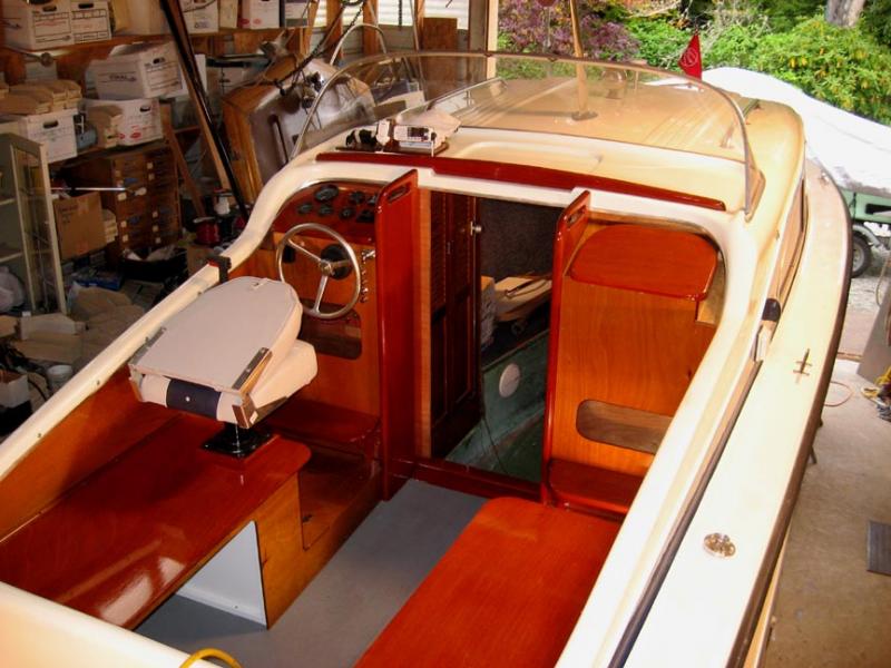

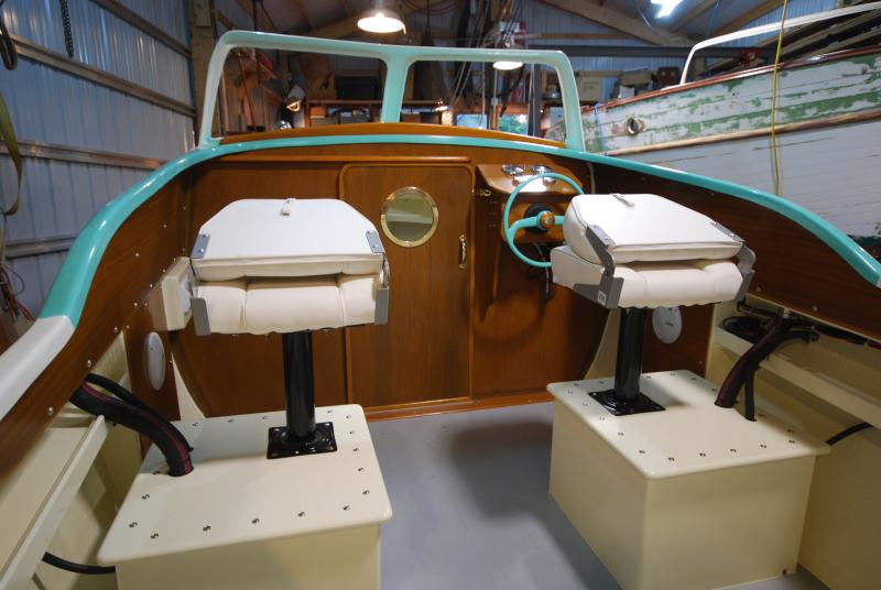

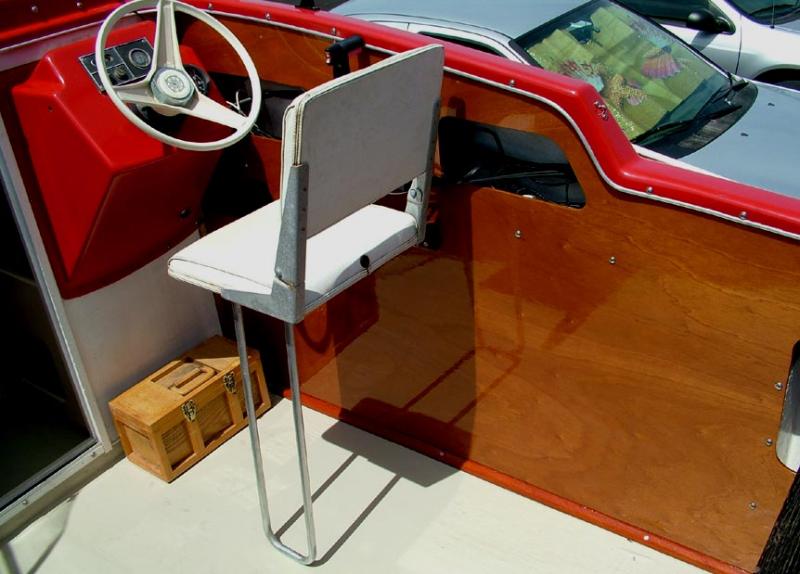

              On the gas-tank subject, you could fit some kind of new tank into the old shell, but as you say you'd lose a fair amount of volume in the process. The best thing is to chisel them out and go with new tanks. (It's common to hide the tanks altogether with a panel of marine-mahogany plywood--see photos below--that extends from the underside of the side deck to the cockpit floor. In going with a new tank, you might have to fur-out just a bit to clear the tank, but it's a nice-looking approach.)

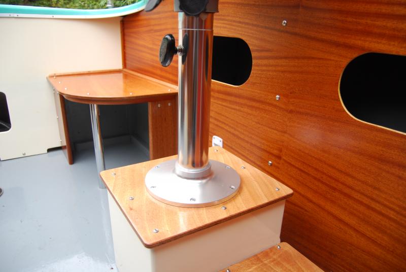

              Another way to deal with dual tanks is to hide them under plywood boxes that support your new seats. We used squarish-shaped plastic tanks in Charlie and Pat Johns' 20' Skagit (see the last photo, below).

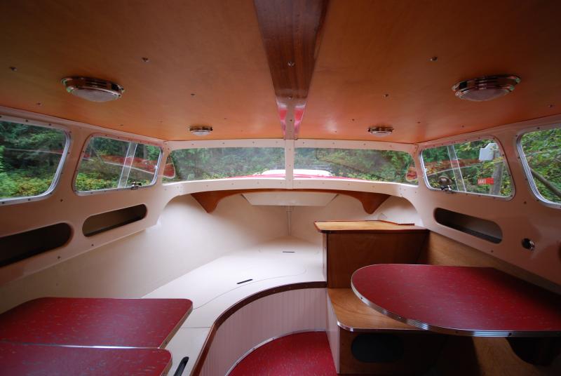

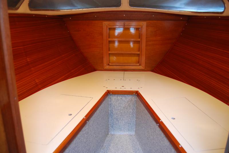

              If you're looking at website photos of the 20' 1958 Skagit we worked on recently, owners Charlie and Pat wanted a clean approach to the interior...and they didn't feel a need for galley, dining table, built-in porta-potty or other such items. The boat features several lift-out deck lids to access storage cubbies under the generous forepeak berth, but I really liked their clean, straightforward approach.

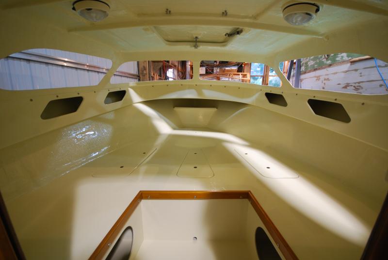

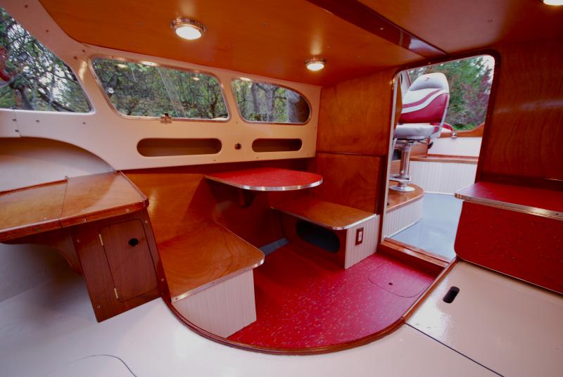

              Most of the original Skagit 20 Express models came with a cabin interior that included molded-fiberglass sink against the bulkhead, with water tank mounted on the outside of the cabin bulkhead; marine head under a hinged lid; pop-up dining table that became part of the forepeak berth when not in use, and a few storage cubbies for dishware and miscellaneous. They were never 'fancy,' just functional, but the nice thing about restoring old classic-glass boats is that you can do whatever you want: Nobody's going to descend on your boat with a list of original specifications and a tape measure to be sure you reproduced a factory-original interior! (By the way, if you want to see a totally original/virginal Skagit 20 interior, get together with Bruce Bridwell at some future boat-club event and look at his gorgeous 1958 Express...just the way it was 54 years ago.)

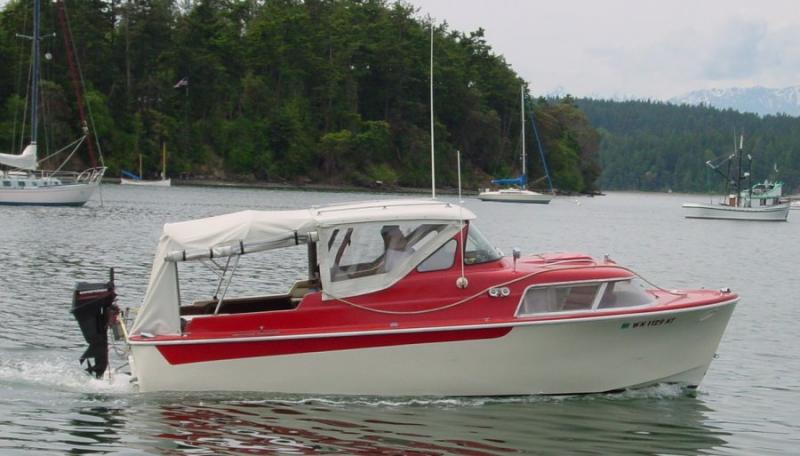

              Photos below show a few different approaches to cockpit arrangements, side panels and cabin interiors...not all Skagits, but similar.

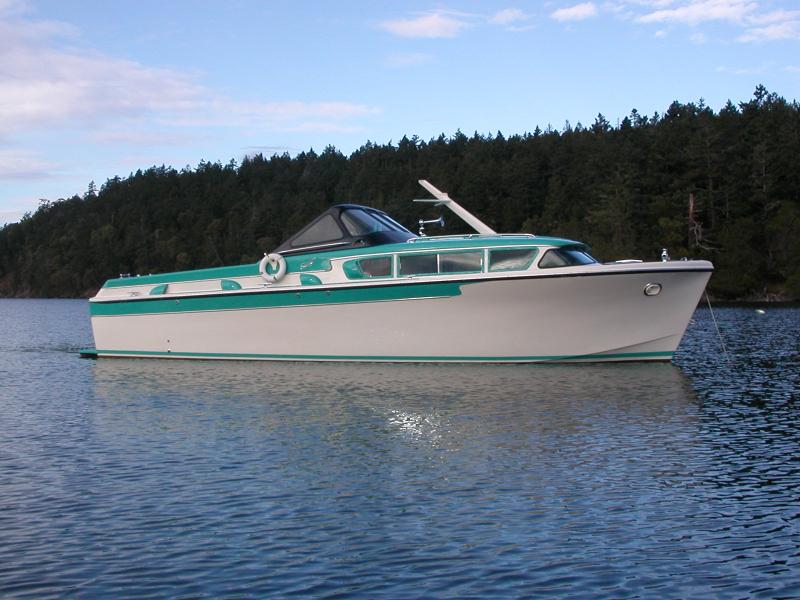

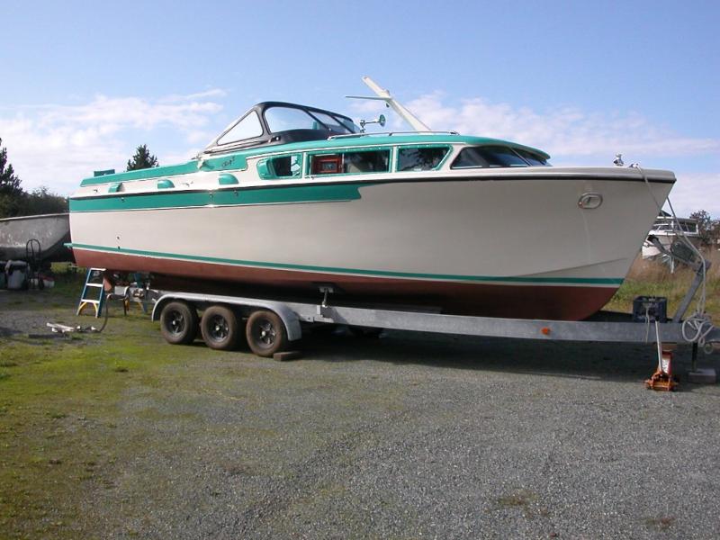

                  I have what is the only restored Skagit 31 in existence. Picture attached. Was a twenty year project. Worth it!
                  You'll have to stop over to Friday Harbor some time and I'll take you and yours for a spin.......
