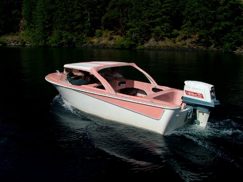

    I was running a Bearcat off the back of mine.. Right now she is just sitting.
    [ATTACH]16135[/ATTACH]

          I know that color all to well... she used to look like that before a real good buffing out! Thanks for the information. I'll PM Tim when it gets to be that time.
