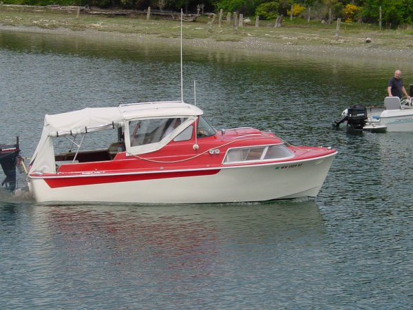

            Here is mine.
              Wow, that is a beautiful set up. I have another frame and bow set up to take it all the way back, seeing yours might have me buying fabric. My wife sews very well, having done sails for years.
