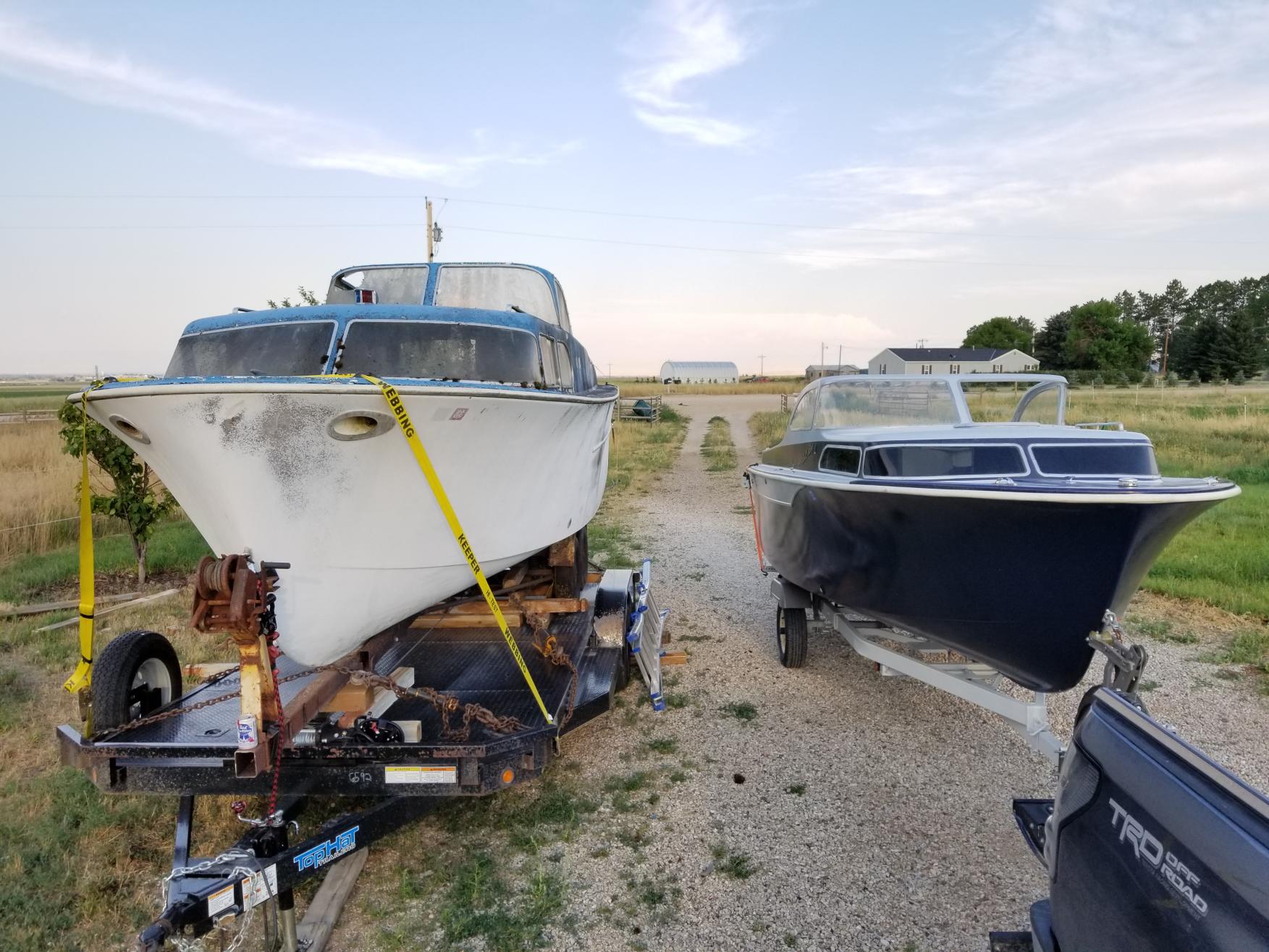

    Hey all, my name is Drew. I've been following this group for a couple of years now and am just starting to share what I have and looking for guidance on my latest boat, a 21' Bell Boy. Some of you all might recognize it from a recent CL ad. The 21' on the left and my 1957 18' on the right.

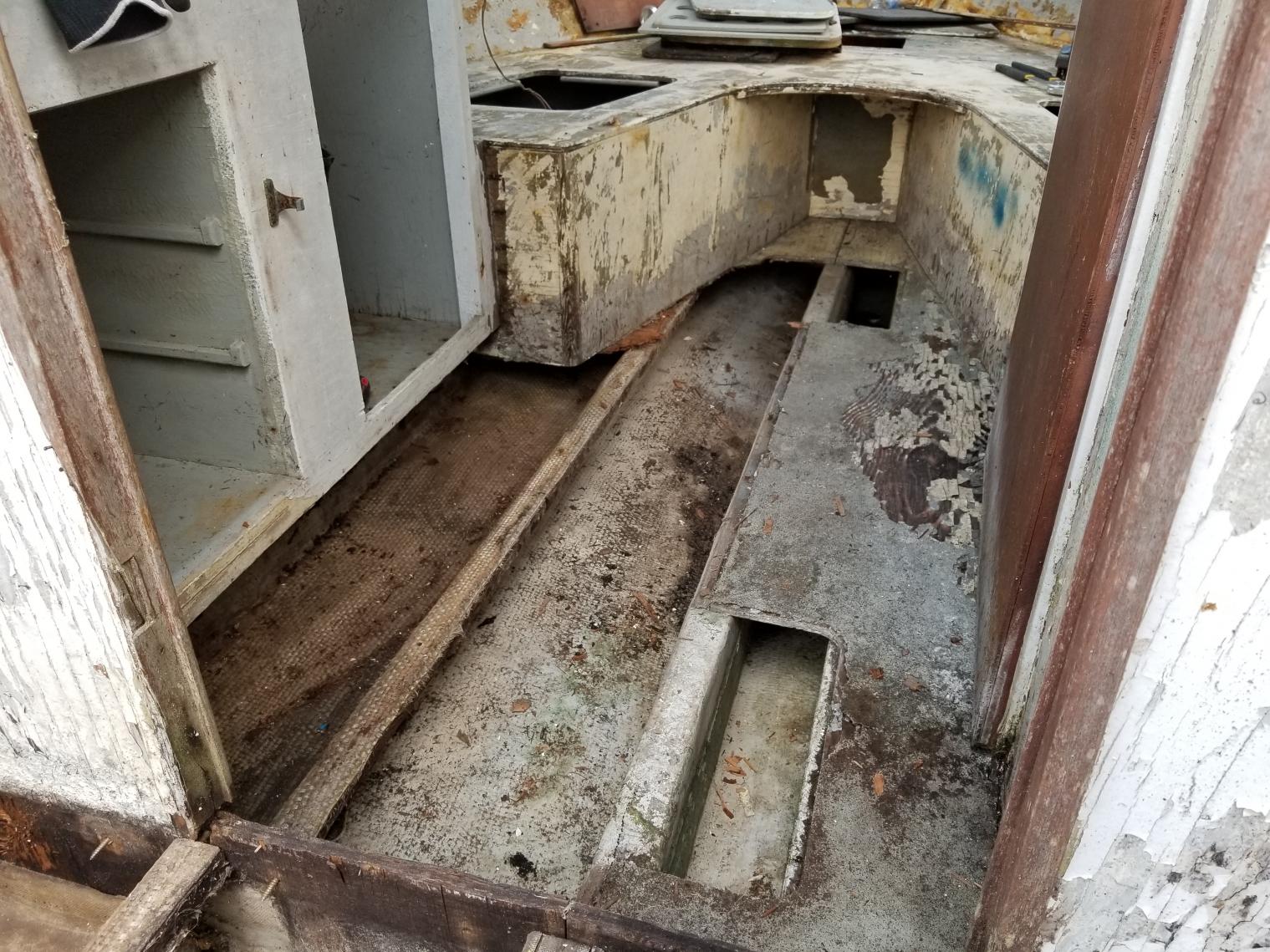

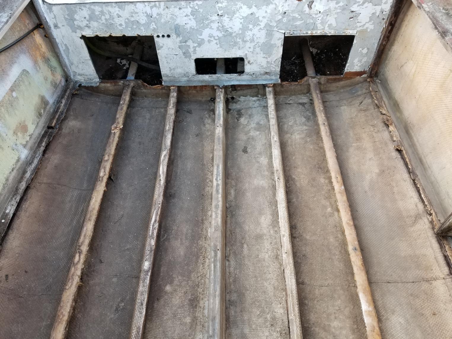

    Having seen a 21 stripped down to the hull on inside, I'd consider raising the floor/deck in the cockpit area and forward to the bow by at least 4 inches. The stringers (from the factory), if you want to call them such !!! were what appeared to be wrapping paper cardboard rolls covered by glass cloth. Very sub-standard for the stresses on a hull that length. I'd put in 4-5 inch tall glass stringers, bow to stern, hollow, formed over 2x6s. Structural cloth. You'd have to make sure the hull is straight and supported properly to tab these in.

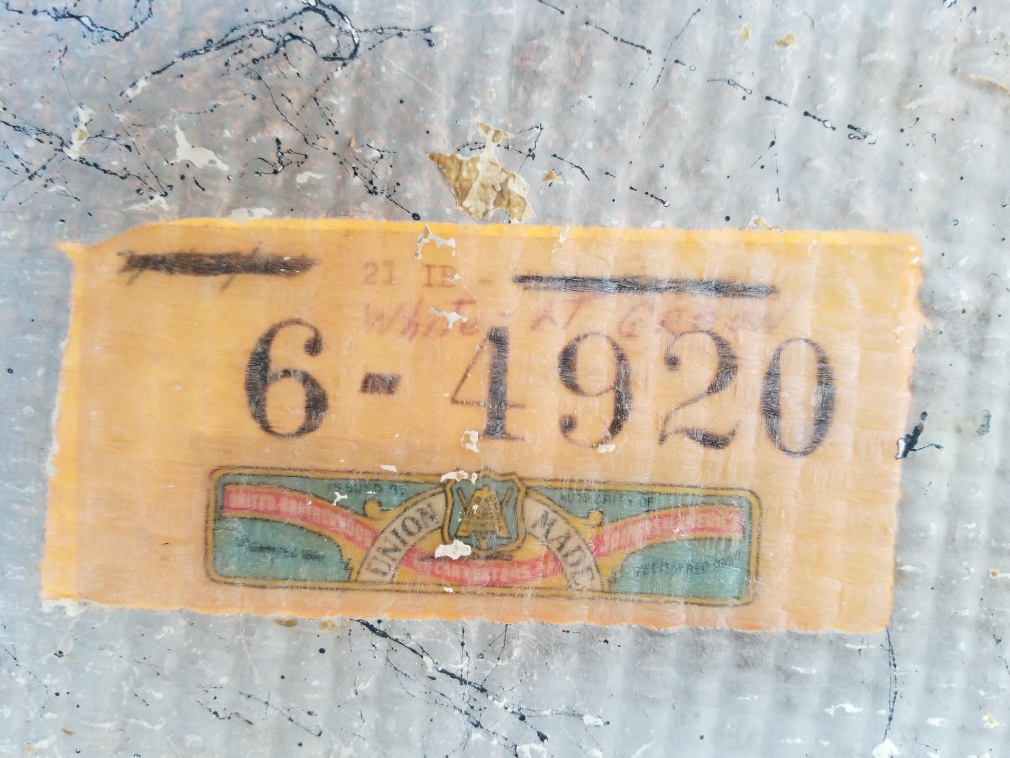

          Thanks all! I've dug thru all the 21' Bell Boy posts and pictures I can find on the site and after tearing out the floor I'm really curious about about a couple of things. Amazingly I found the hull ID behind some nasty carpet and it's in remarkable shape. What do you all think of what I found beneath the floor? If need be I can move this thread to another page if you want. I've got all sorts of pictures to share

            I will have to go back and dig into the Bell Boy 21 pictures I think I still have of that build to see what the stringers were for sure.
            I do know the 19 had those half round stringers that with enough sand under the floor would almost sand them down to nothing.
            The one I did for Jack Dando, I used glass matt over each one of them as you could step on them and they would crack..

                Congratulations on the 21! I had a chance to get the one from a local restoration shop (Island Boat Shop) years ago, but it was just too big for my yard space. Ended up with a '59 18 foot 404. It is just about fully restored. Just a few odds and ends left. I love the hand writing and corrections on your hull ID sticker. Mine was also under nasty carpet. You should also be able to find one on the underside of the deck in the same neighborhood if it hasn't been painted over.

                Regarding stringers. On my 404, they were supported by wood and heavily glassed in. I left them alone and used flotation foam to fill the voids when I put the new deck in.
                You are in for a projoect on that 21 for sure. Just about everything looks rotten! Cheers to you for saving another low count hull.
