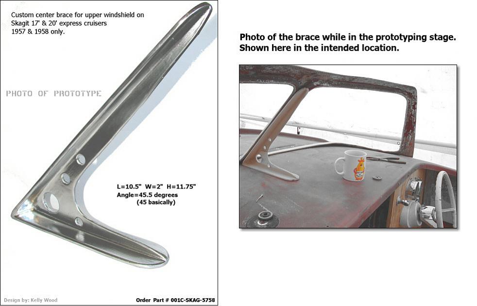

          The windshield center support is a good idea. I wish Kelly from fiberglassics would get back to me, he made a really cool looking center support that looked period correct.

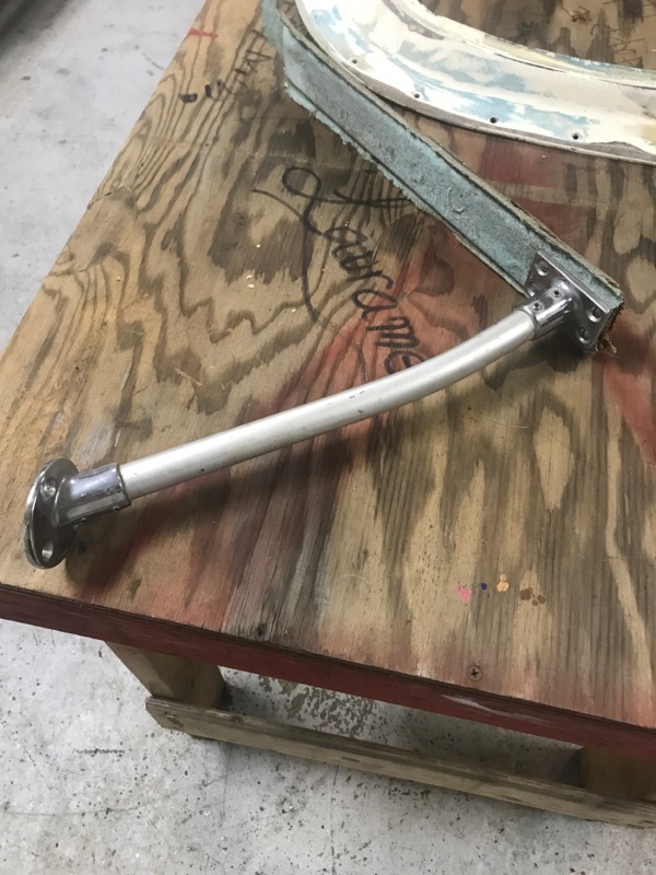

              This is what mine had, looks to be pretty original

                It's period correct, but probably not installed by Skagit. I do like that idea. I'll dig up the pic Kelly from fiberglassics did, it was seriously cool.
                  Found it..
