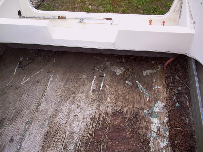

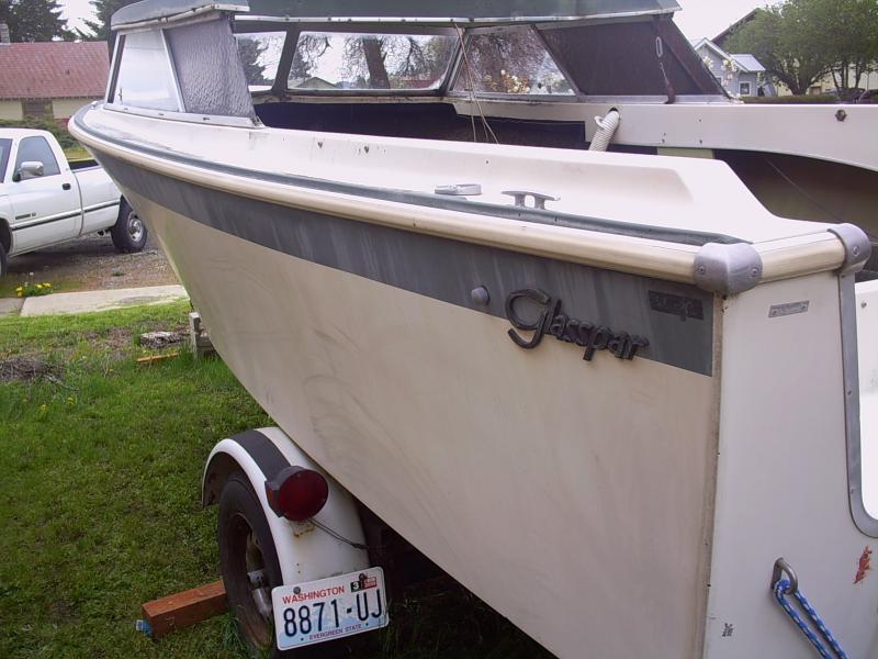

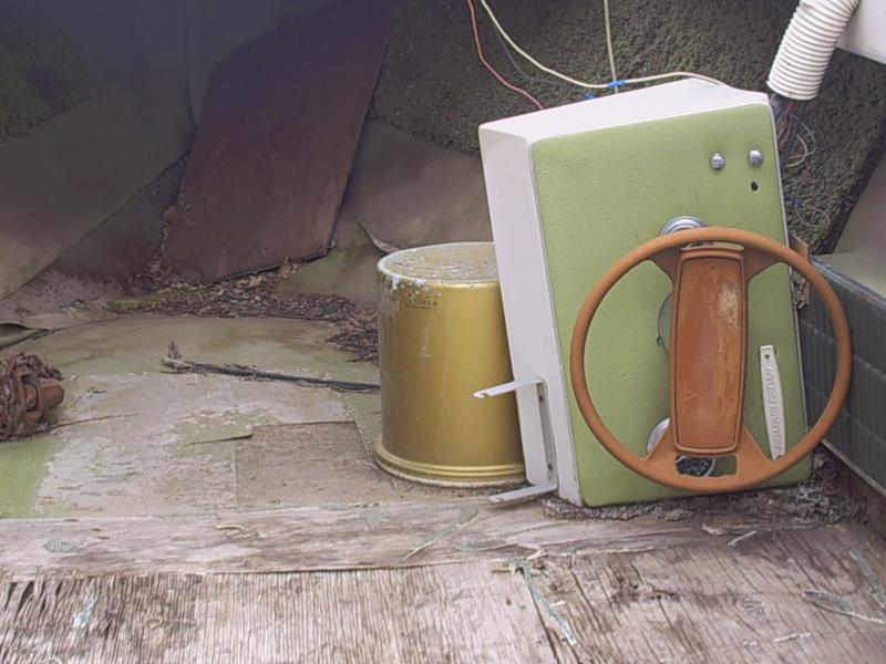

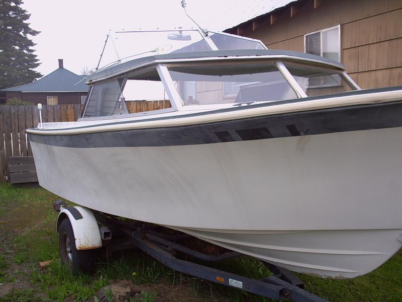

              I hope I can have my boat ready for the Alaska trip!!! I think I would really enjoy doing something like that with my boat. I think I would need more fuel capacity to tackle a trip like that. Like I mentioned before on the post I'm not a boat builder and have had my boat for a long while...just sitting. Now I'm ready to get her back on her feet and in the water. With the help from Marty I think this could become a reality. Here's some pictures.
                George,
                Your boat is one of the Larson designed hulls with the Seafair style cabin. It is going to be really different than the '59 to '68 Glasspar designed boats. The 70's boats were not as elegantly designed and appointed as the earlier models, so what you will see is not necessarily original to yours, that is, if you want original. Your hull is longer and beamier that the older Glasspars so you have a lot more space. It is also a rare find.
                ChuckB
                  72 Sedan
                  Thanks Chuck for the info. It's really hard to find out any info since Larson didn't put as much effort to keep catalogs for the Sedans. Well .. I guess I can come up with something that keeps the classic look....Boy..I really wish I had some original pictures... The person who owned my boat before my friend took stuff off and screwed plywood thru the hull ?? Don't ask me why!! My good friend bought and repaired the boat. The boat was out in Neah Bay many moons ago and had a motor but the wiring harness caught fire and their she sat until I came along. At the time I was living in California and came to the Northwest for a salmom derby.... I saw the boat and told my friend that boat would look great in Catalina Island...Southern California.... The boat stuck in my mind for a couple of months and then I couldn't take it anymore...I called him up and bought her. Seveteen years later she still sits but this time I think she will come back to life...I don't think I could stand another seventeen years.
