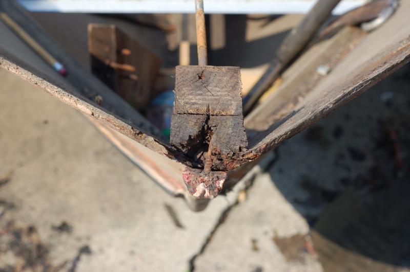

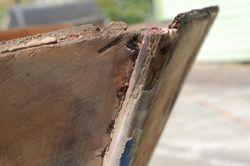

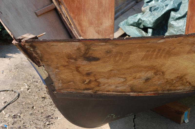

    Since I have taken over this project from my son, I now at this time have the boat gutted --- yep all the way down to the hull. I do have some rot on the upper edge of the entire boat that extends about 1 to 11/2" down. My plan is to remove this small amount of rot evenly all around.
    I will need to replace all trim and rails and of course the transom. The hull appears to be solid as do the stringers. My next step is to get it under cover before the rains come.

        I thought that I could remove the rotted wood and replace it with a thicker piece leaving as much of the plywood and epoxy with several coats of glass and resin. I am going to paint the boat so I'm not concerned doing it this way. I just got to make sure that the epoxy, glass and resin hold everything solid.
        When I roll the boat over I just hope there is no more rot. If there is I may just trash the whole project.
          Yikes! That doesn't look good. I'd say replace the whole section of wood.
            I'm no wooden boat expert, but ...
            In my limited experience, if the hull has been glassed over wood and you have rot somewhere, it's very likely that you have it somewhere else. The discoloration of the ply hull in your photos tells me there has been a lot of moisture there. I wouldn't do anything else until I thoroughly examined the rest of the hull for rot.
            I've had two glass-over-ply hulls that were going to be projects until I found the true condition of the ply under the glass, and neither of them had any rot at the bow like yours, that doesn't seem to me to be the first place that would go bad. Look very carefully at the chines, the transom, the juncture of the transom and the bottom, etc.

                The inside hull appears good - by that I mean when I poked around the bottom with an awl and I found no weak spots, but that doesn't mean that where the keel meets the hull I will not find any. So far all (and I mean all) the screws that was used to hold the hull, railings, trim and transom in place were rusted and burned into the wood, but it appears that all that is above the water line except for the transom were it was all the screws that held it on.
                I need to dig into the keel by removing the fiberglass then I know if it's really worth moving ahead with this project.
